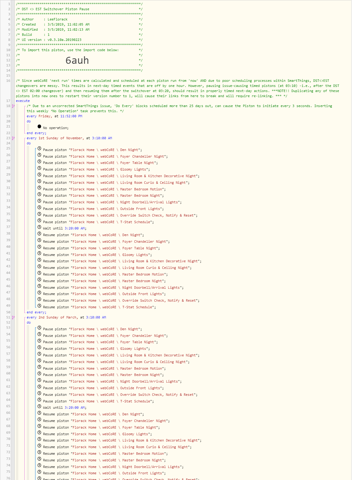

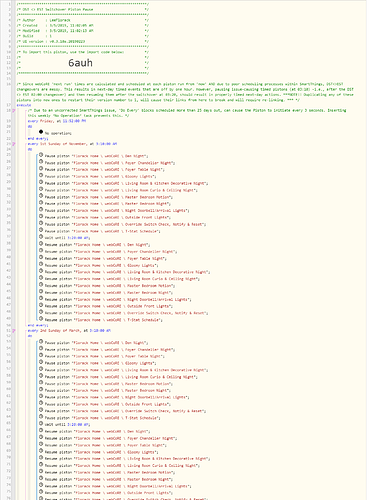

The attached piston will likely work to alleviate the normal DST <> EST switchover issues with ST but it doesn’t seem to be written very efficiently. Just looking for any alternatives.
