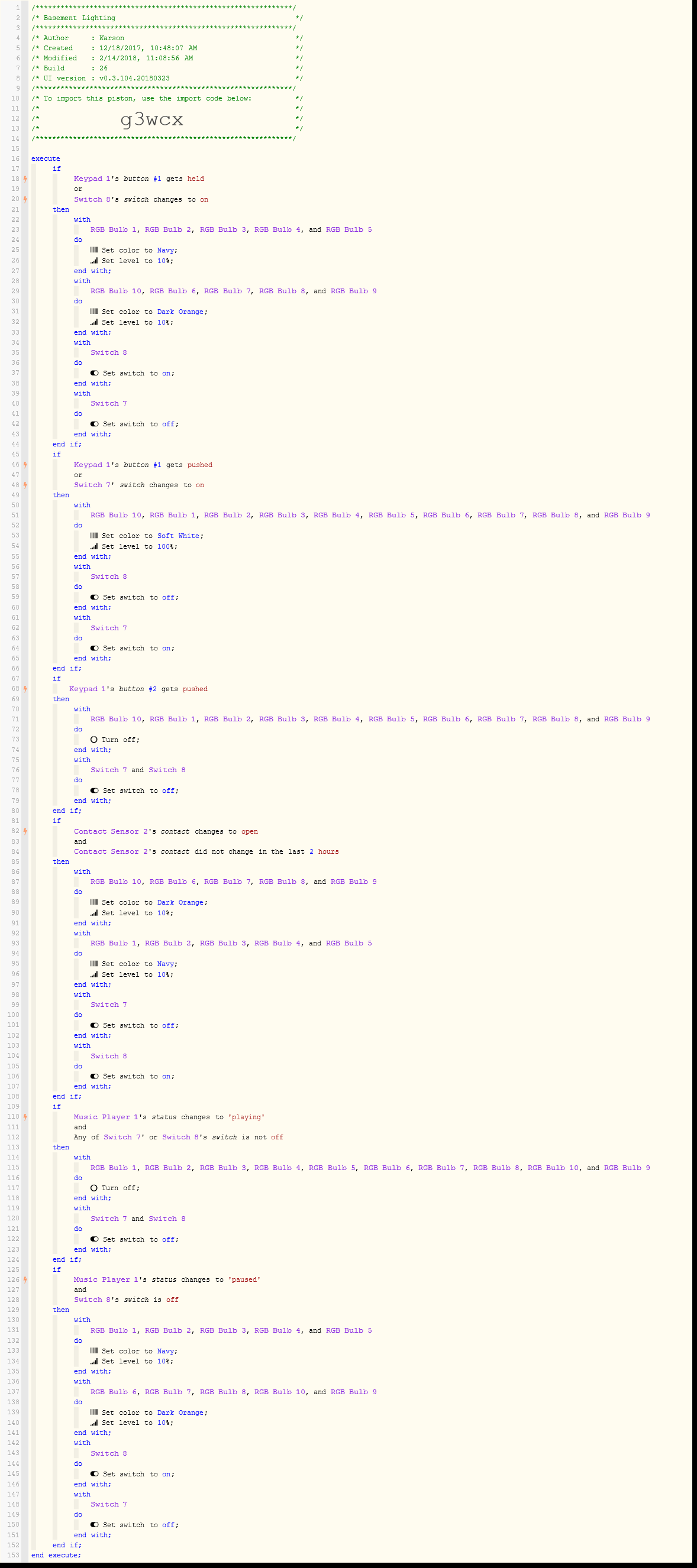

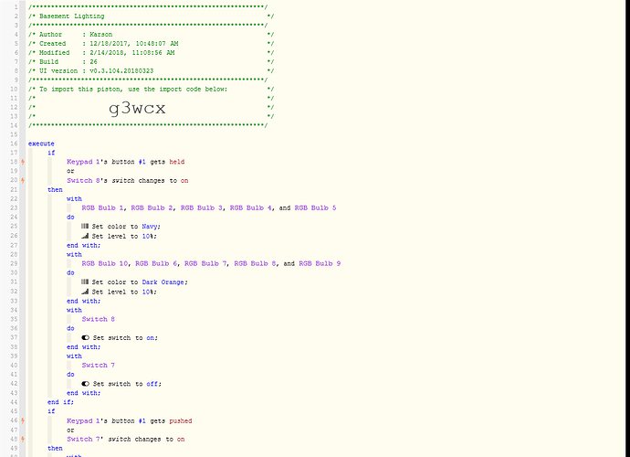

I have a piston created to dynamically control my Lightify basement lighting. I have an open/close sensor used as a potential trigger condition, along with a time range so that if the door is opening and closing during a movie or football game, the lights don’t trigger unless it’s been over two hours since the last door “event”. There is also a Lightify switch that can be used for manual control. My issue is with the door open/close sensor.
Behavior is erratic of the lights. Days where I haven’t opened the door all day, when I finally go downstairs, the Chicago Bears lighting (navy & dark orange/10%) virtual switch won’t trigger on when the door is opened.
It will flawlessly work for one or two sequences when I manually test via the switch, but when lighting is supposed to be invoked with the door open/close sensor, that’s where my issue is I think.
I’ll post logs if that’d prove helpful, but I think it’s just a logic flaw in my piston.
