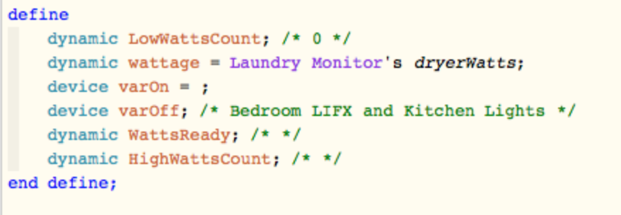

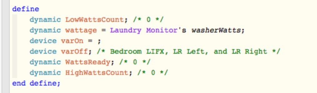

The Washer Monitor works great, the dryer monitor not so much. The variables are set the same – dynamic, no initial value. The Washer shows all three critical variables at: /* 0 / but the dryer piston displays it as / */ This is causing null errors when the piston starts counting from a command to:
Set variable {HighWattsCount} = {HighWattsCount+1};
However, setting it to start at 0 initially seems to keep it at 0.
the variable displays /* 0 */ so it can begin counting.
see above

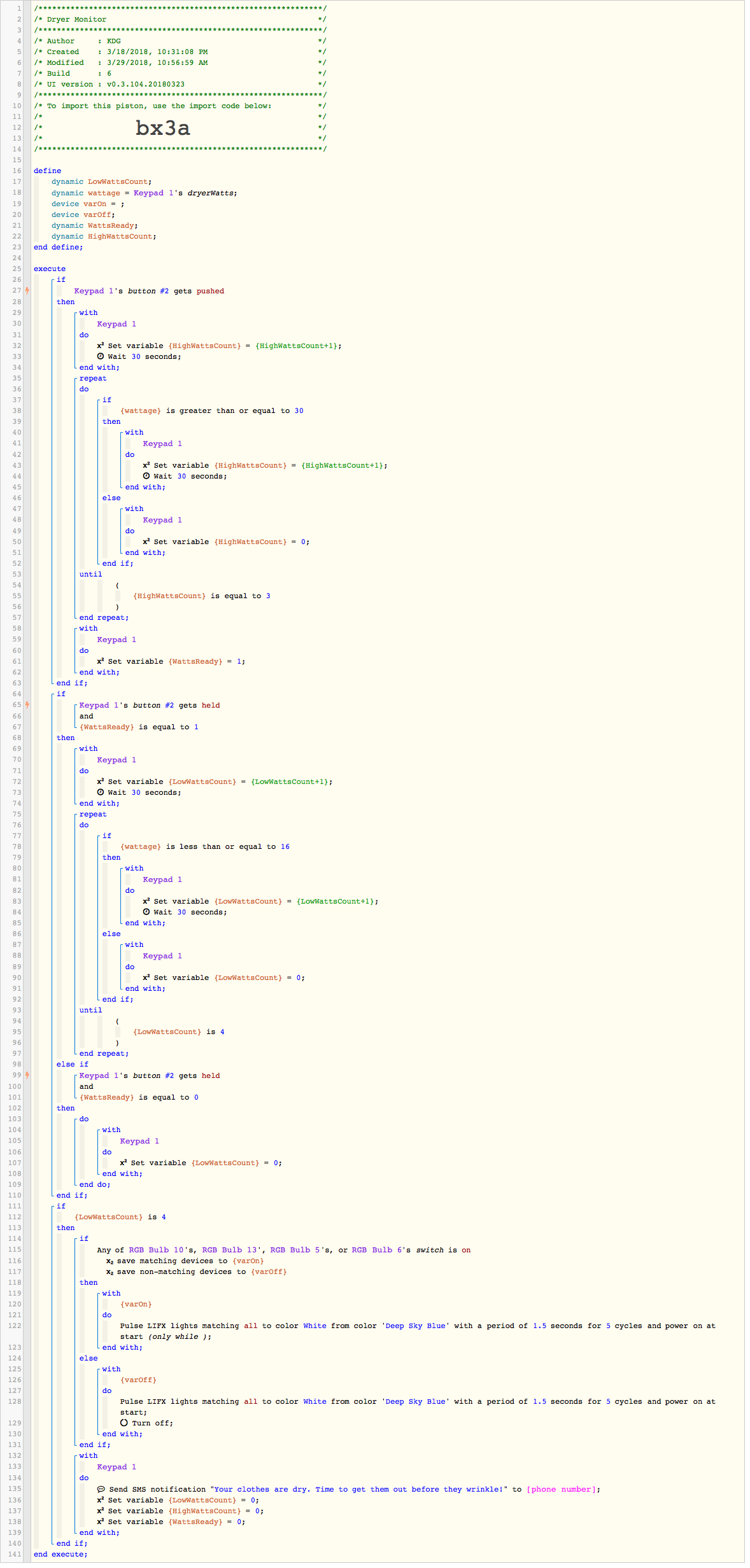

Full piston here:
