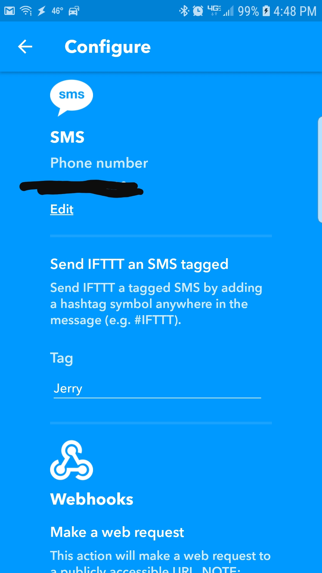

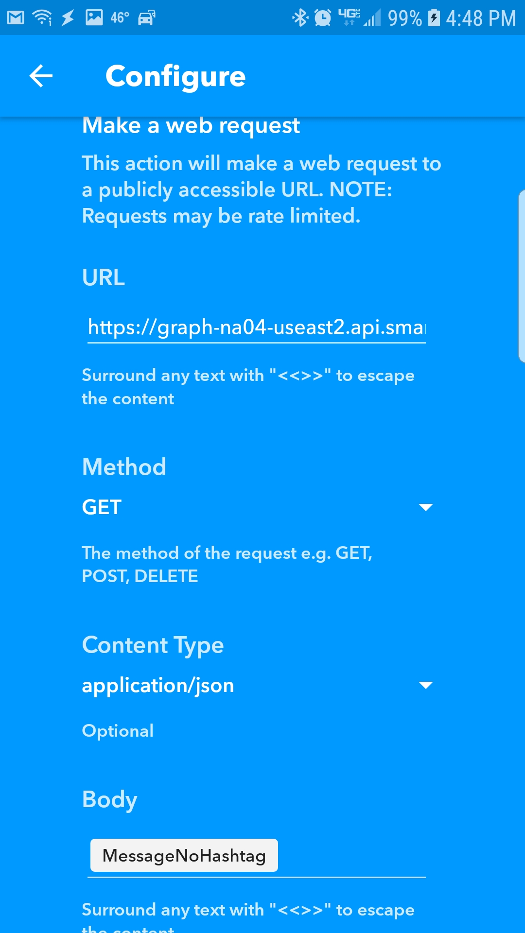

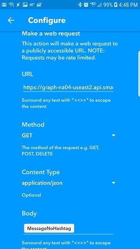

using IFTTT webhooks, send a SMS to IFTTT that relays to WC. When person arrives home, Echo gives the announcement (don’t forget to water the dog, etc)

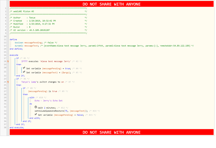

I’ve gotten everything in place on the IFTTT side but can’t for the life of me figure out how to get the message over to the piston. I know it’s probably simple, but I’m a noob.
**4) Post a Green Snapshot of the piston!! Red snapshot added

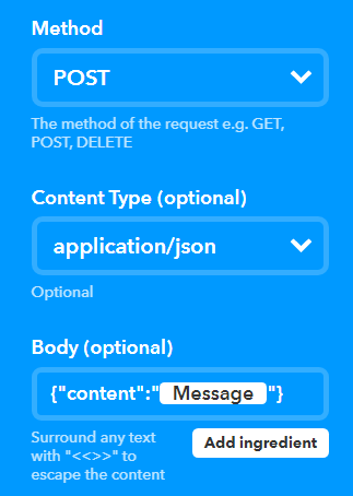

What does it look like on the ifttt side?
Edit: This is what I have…
In my example above… I can extract the message using $args.content variable.
Try to format the Body part to how I have it in my example.
In your piston, you can change messageText = $args.content

$args is the data passed by IFTTT to your piston. If you format the Body of your IFTTT message like my example above, $args.content will extract the content part of the message only without the extra json data.

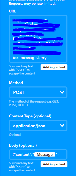

How does the ifttt side look like now?

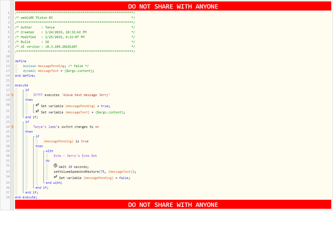

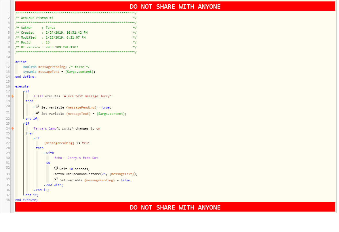

Interesting - now the Echo says “No” when the piston fires. I changed the IFTTT to POST to match yours.

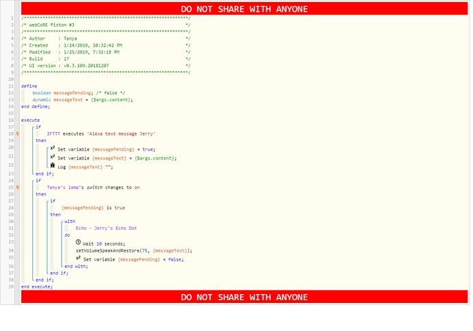

And the piston side?
#15

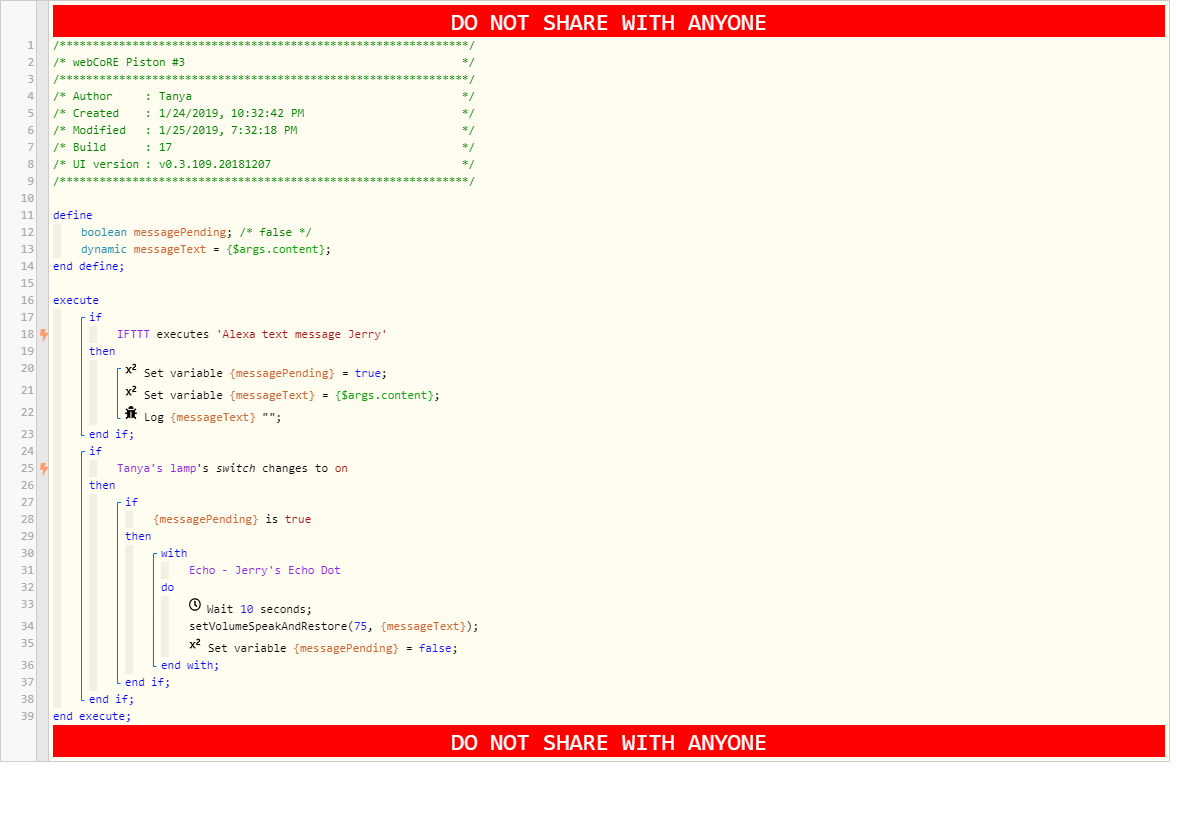

Add a Log messageText after your line 21 and see what you get.
#16
Echo says “No”
#17
What was logged?
#18
Also for giggles, change your variable messageText type from dynamic to string, I know ES is expecting a string.
#19
Not sure where the message was logged. But I changed to string and still got “No”
