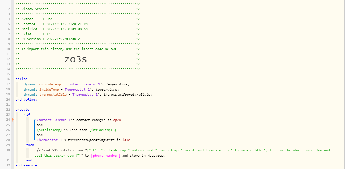

I will be installing a smart switch to turn on my whole house fan(replacing a timer switch) soon, but wanted to get the logic down.
I have a window sensor. When it opens and the temperature outside(window contact temp) is cooler than it is inside(ecobee temp) and the ecobee operating state is idle, I want it to kick on the whole house fan.
Right now it sends an SMS to turn it on, but this is where I would replace it with the new switch. I would eventually want to set it for a timer event to run for 2, 4, 6, or 8 hours. Either that or run until inside temp is cooler than outside +/- a few degrees.
Any suggestions on how to enhance this logic or maybe a better way to design it?
