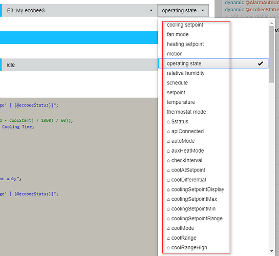

You will have to check inside the piston editor what attributes your ecobee has available. It will depend on the device handler you’re using. Here’s mine…
