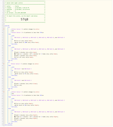

no problem it is working as I intended at this point - really just double checking my thought processes before I get too deep into the rabbit hole and adding more functions.
planning to add if statements around humidity to detect shower usage so you are not stuck waiving your arm out the shower door when the lights blink
again just looking for efficiency advice or simplification to what I have started.
And Yes my home status is currently being used as a day status. I need to add my location status’s and rework the piston to include those but was just working through this one before going threw and doing all my rooms and customization them too much.
