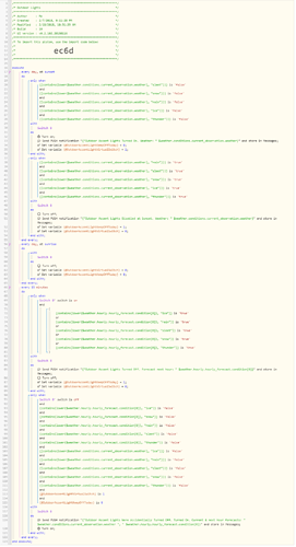

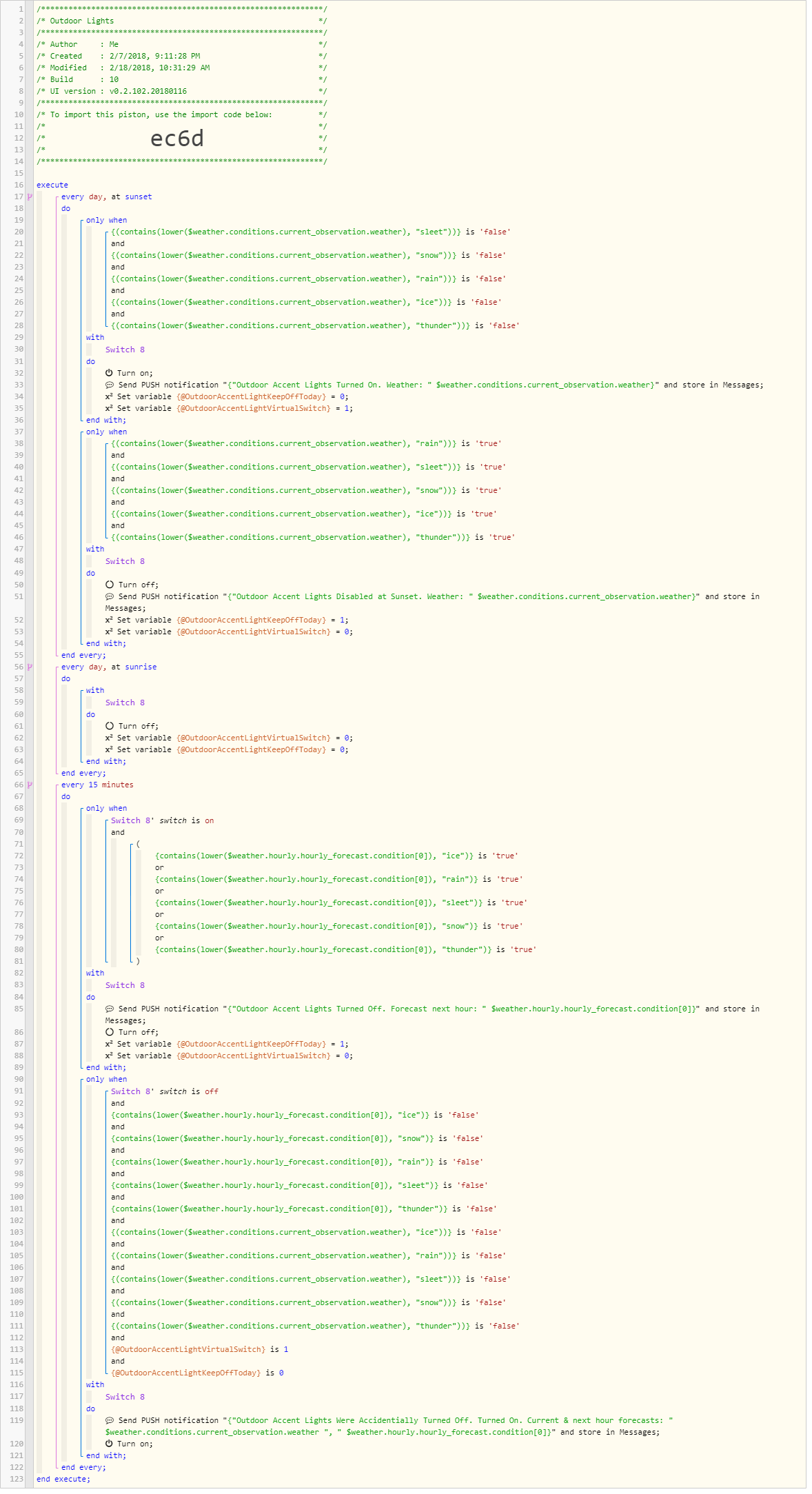

I am getting a notice the piston is using 56% memory. Is there a way to make it more efficient?
Working as expected. Turning outdoor house accent lights on at sunset when no bad weather. Turns them off when bad weather exists. Turns off lights regardless at sunrise. Turns lights back on if turned off accidentally
No logs necessary

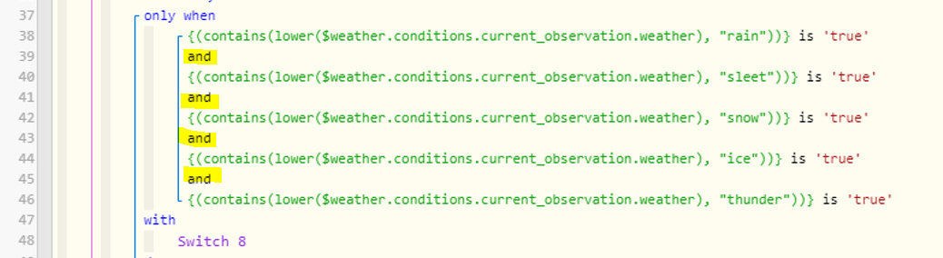

First, make yourself a couple String variables at the top of the piston and those make the calls to get the weather conditions. There’s no need to make the calls to check the weather in each and every sub block. That’s eating up a ton of memory right there having the same exact text within the piston multiple times.
Like this:
Then you can test against that variable rather than making repeated calls to the same thing. You can even change it to lower case right when you define it too.

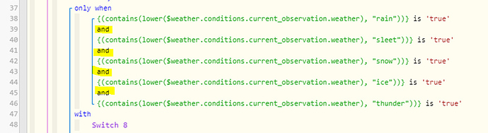

Just an FYI, I doubt this will ever be true.
There’s more you could do as well…but that will get you started.
