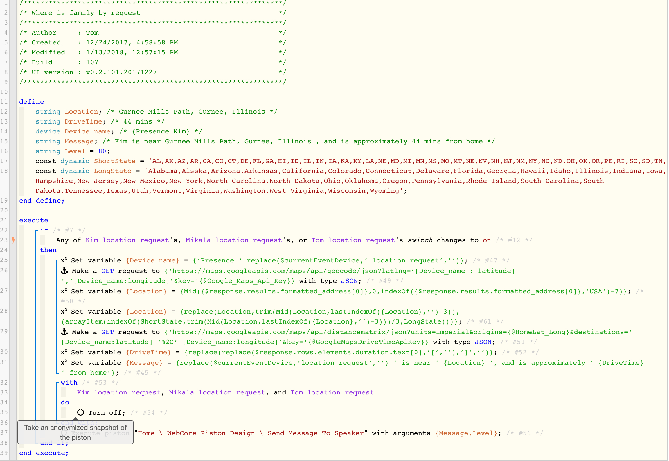

@bobbles they are dynamic. They are my api key for google maps, 2 different ones, and a dynamic one for my home gps latitude and longitude

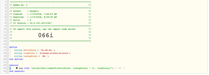

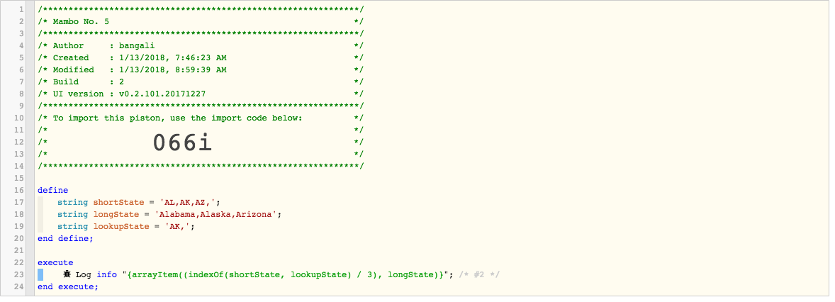

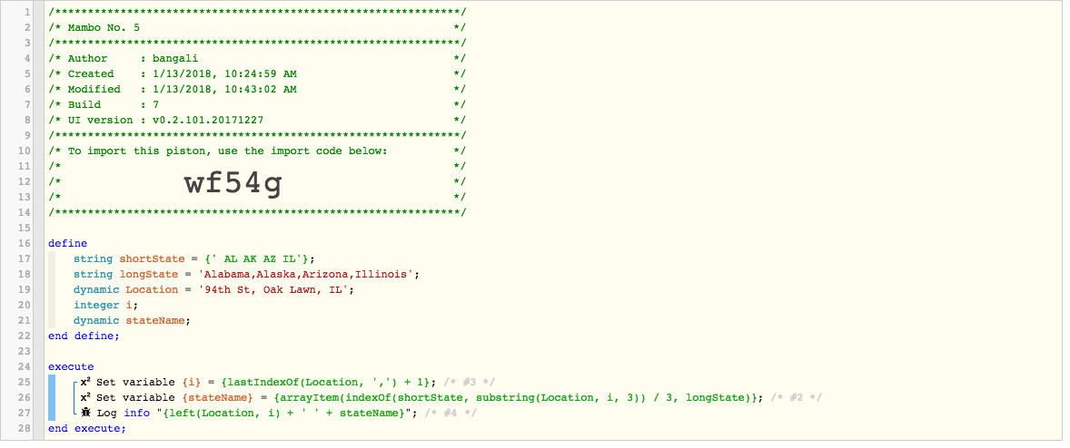

yeah indexof may not support comma delimited string try this:
define string shortState = 'ALAKAZ…'
define string longState = ‘Alabama,Alaska,Arizona,…’
arrayItem((indexOf(shortState, lookupState) / 2), longState)
this will require checking none of the short state cdoes are inadvertently generated by stringing them together.

I’m not sure how arrayIyen can help in this case… the OP wants to replace the abreviation which is mixed up within a longer string of text generated from elsewhere…

Look at his message variable and clarified request in post 3

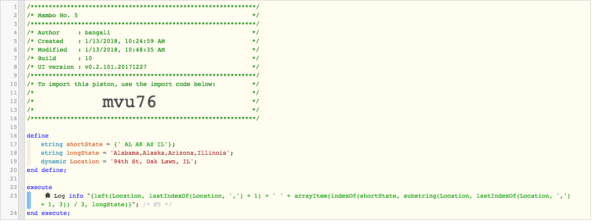

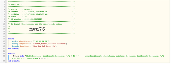

I think I almost got it. It may not be most beutifu; but I will post my final working and then maybe one of the fine people here can help me get it effecient
#29
thought post 6 was later and more updated.
doesnt matter though same principle applies.
used 3 lines instead of 2 for readability.
heres the one liner :slight_smile:

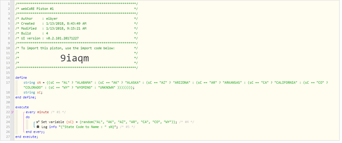

#30

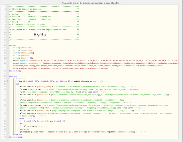

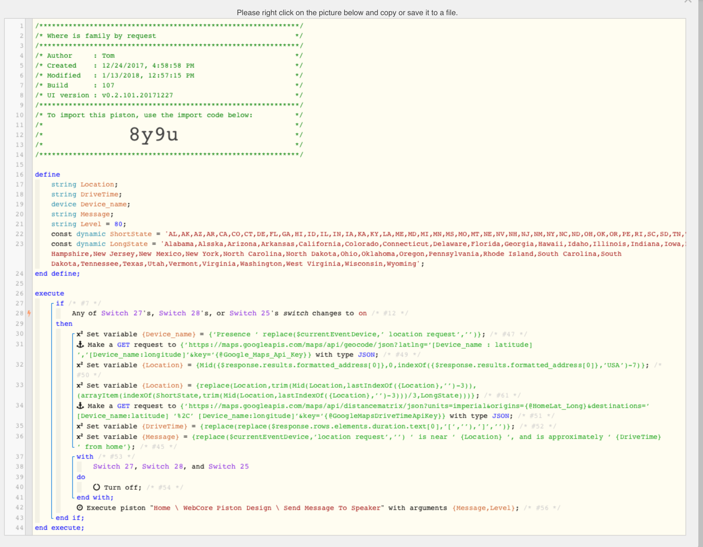

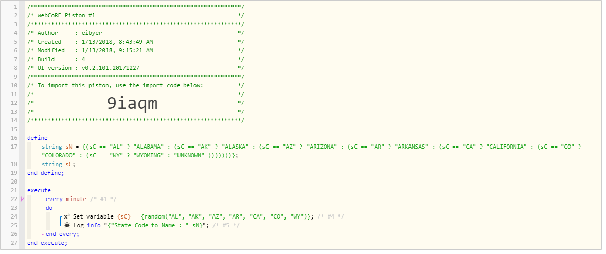

Ok guys. Thanks for the help.
Here is a green shot and a screen capture of the piston. It’s working as I need. Just a lot of manipulation to get the state on there rather than the abbreviation.
Any suggestions to make this even cleaner. I’m all ears
