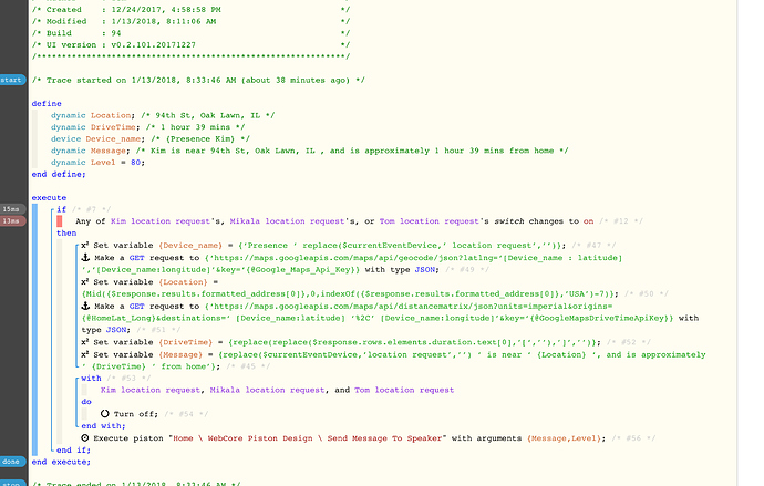

I have a piston that is using google maps api to find a location via gps coordinates. When it finishes running it gives me a variable filled with information, including state
Here is the piston.
It is returning IL for Illinois, I would prefer the full name of the state, so that when I pass this to a speaker it says Illinois rather than what sounds like ill.

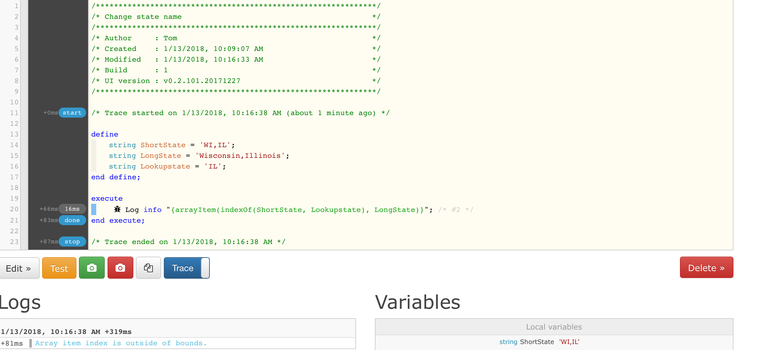

this should return the long form of state:
define string shortState = 'AL,AK,AZ,...'
define string longState = 'Alabama,Alaska,Arizona,...'
arrayItem(indexOf(shortState, lookupState), longState)

before trying that one please check if indexof supports comma delimited string :slight_smile:
this does not actually use lists just comma delimited strings

@bangali I’m getting an array out of bounds?
