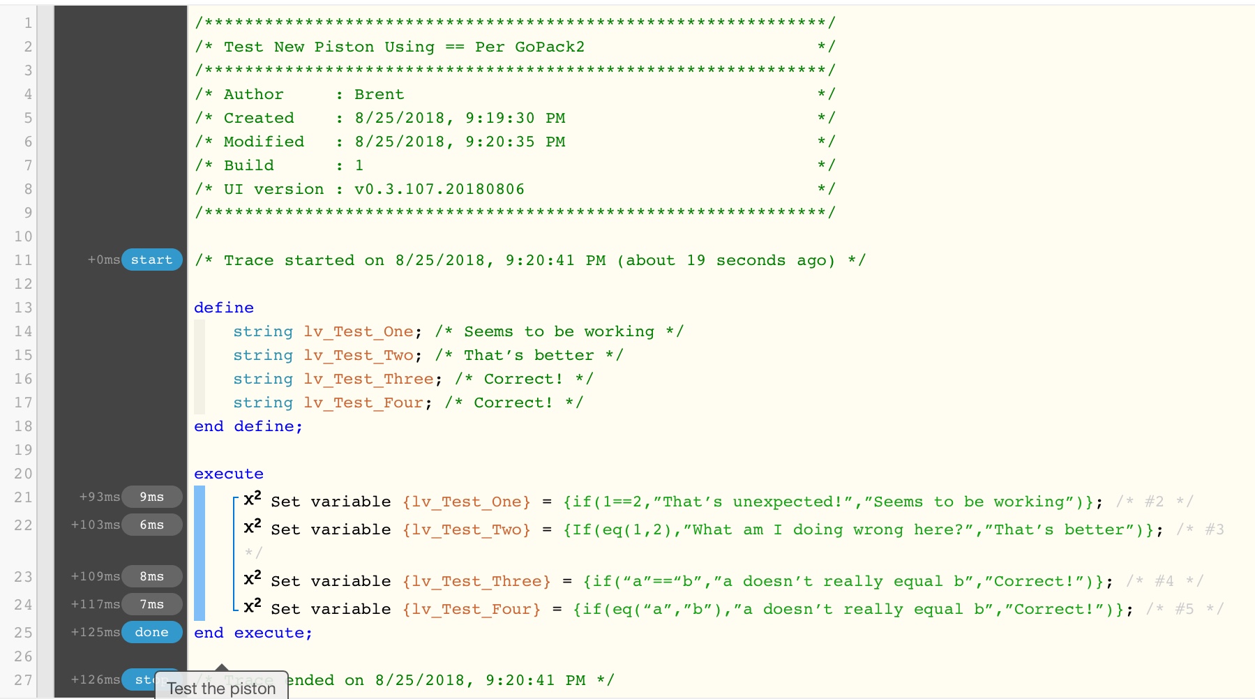

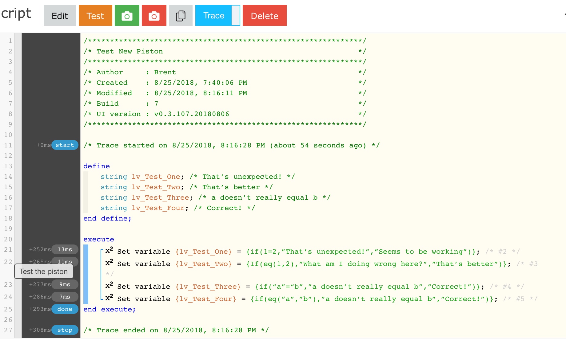

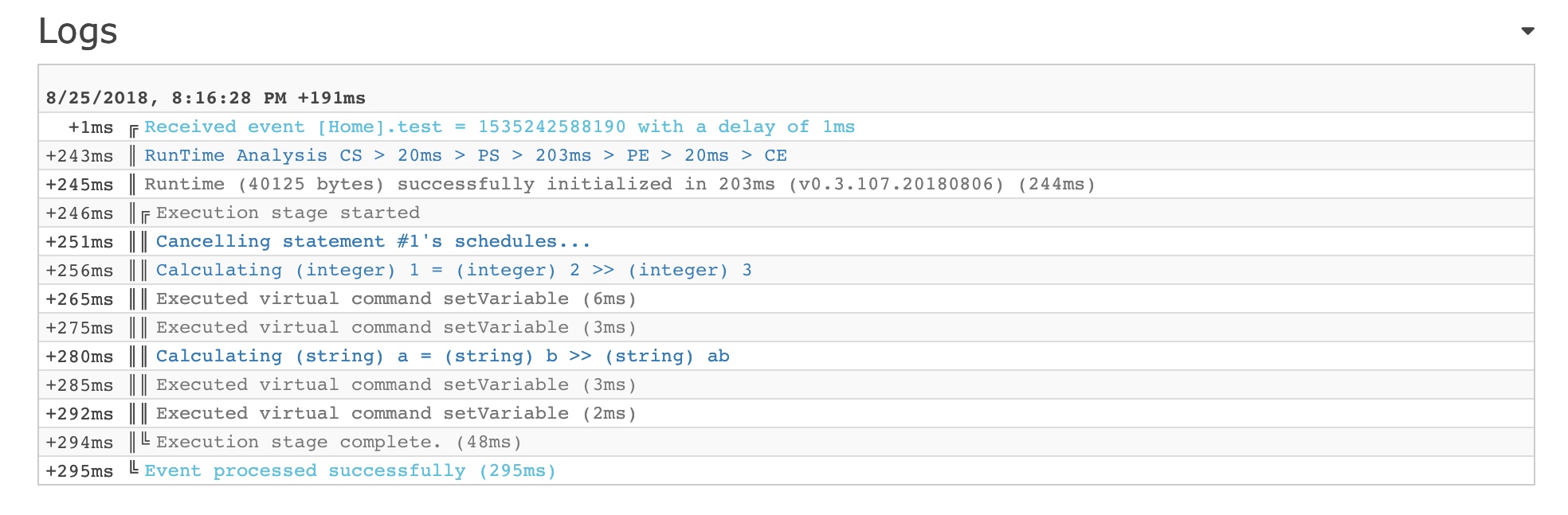

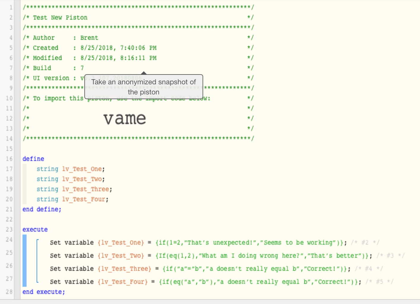

I’m trying to figure out what I’m missing… or if something changed. Is it ever possible to reliably use the “ = “ operator in an expression (specifically within the condition of an IF statement), or do you always need to use the EQ Boolean function? Thanks!
if(1=2,”That’s unexpected!”,”Seems to be working”) … Should resolve to “Seems to be working!” …since “1=2” is false.
if(1=2,”That’s unexpected!”,”Seems to be working”) … is resolving to “That’s unexpected!”
Should be if x==y for if x is equal to y
And if x!=y for if x is not equal to
I believe
Thank you @Gopack2!! Perfect! I’m sure that must be documented somewhere. I’ll be darned if I could find it.
