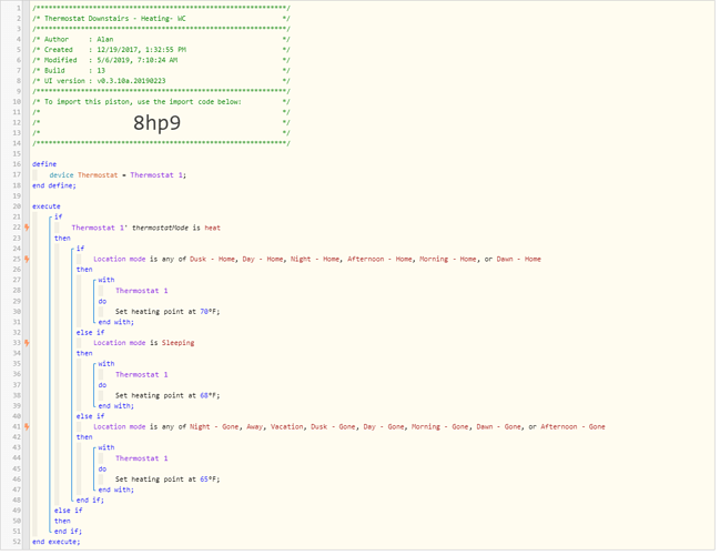

I’m seeing this lovely error in my logs. Any ideas what it means?
An error has occurred while subscribing: groovy.lang.MissingPropertyException: No such property: r for class: java.lang.Boolean

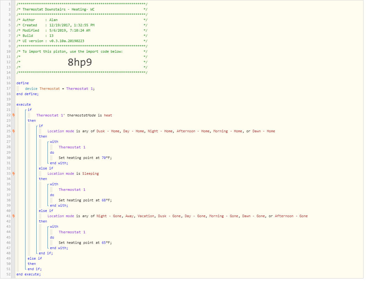

I’m not an expert but I notice two things: All your conditions are triggers since you have no triggers and there is one empty condition at the last else if. I assume you are calling this piston from somewhere else and don’t need the triggers so perhaps try disabling event subscriptions and see if that resolves the issue.
