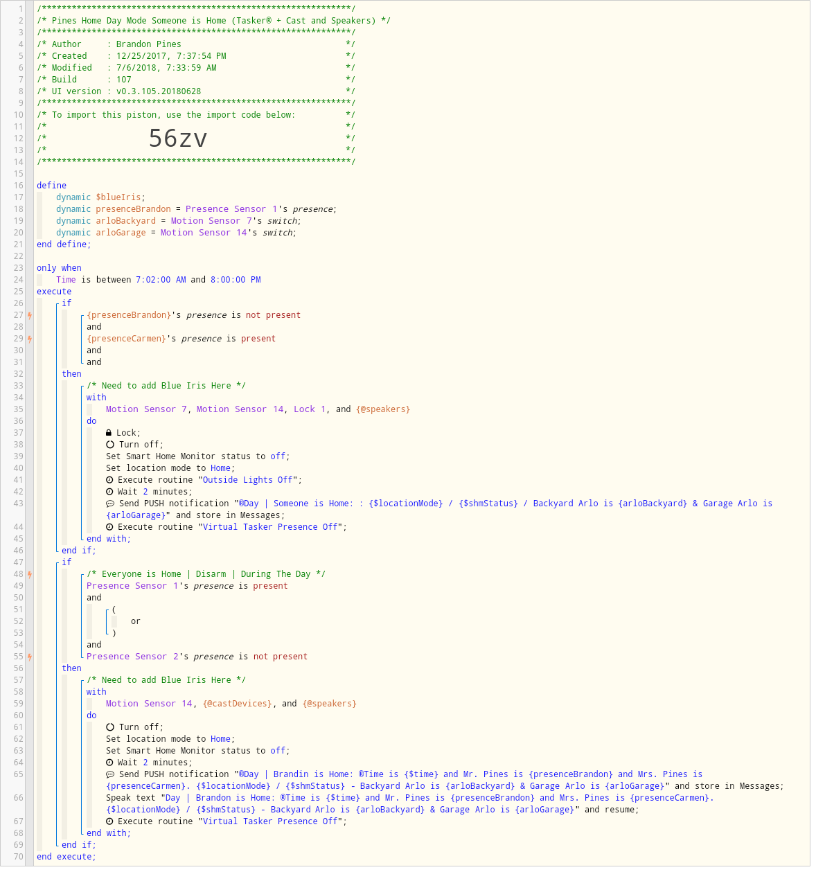

Piston is not running
Change to home mode and show everyone home
The mode is night and error in the logs
**5) Attach any logs (From [ST IDE

+849ms ║║An error occurred while executing the event: groovy.lang.MissingMethodException: No signature of method: java.util.LinkedHashMap.call() is applicable for argument types: (null) values: [null] Possible solutions: wait(), any(), wait(long), max(groovy.lang.Closure), each(groovy.lang.Closure), any(groovy.lang.Closure)
