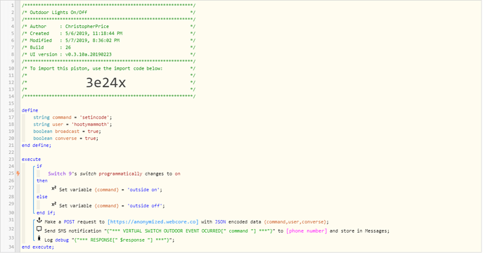

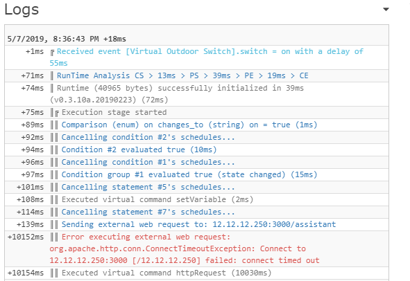

I can send an HTTP POST to my assistant relay running on a PI via Postman. However, when I try to use Make Web Request via webCore I get an error in WC and ST.
Since My ST hub is on the same network as the PC running Postman I should be able to send HTTP POST commands to my assistant relay via WC as I can via Postman
HTTP POST times out with an error. I have tried making the request with and without the URL prefixed with HTTP and neither work
