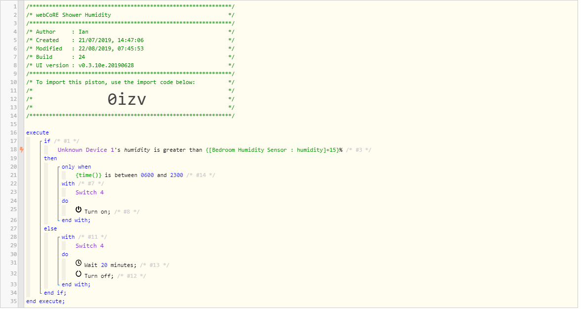

Error when runing piston: Error calling comparison comp_is_between: java.lang.ClassCastException
I have set the If statement true to only run during certain times, this generates an error.
True statement is skipped
THe following error is generated: ║Error calling comparison comp_is_between: java.lang.ClassCastException

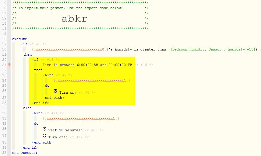

I would change the block on lines 20-26 to something like this:
(make sure there is no lightning bolt next to the Time condition)
On a side note:
I would also consider rethinking the ELSE block… Otherwise, each time the humidity changes (to any number less than X), you’ll potentially run a 20 minute timer… This could easily happen 40 times a day, or more…
Thank you, I realised I was using “time()” and not “time”.
Also I swapped out the IF for a While, which has avoided the continual 20min timer update.
Thank you
