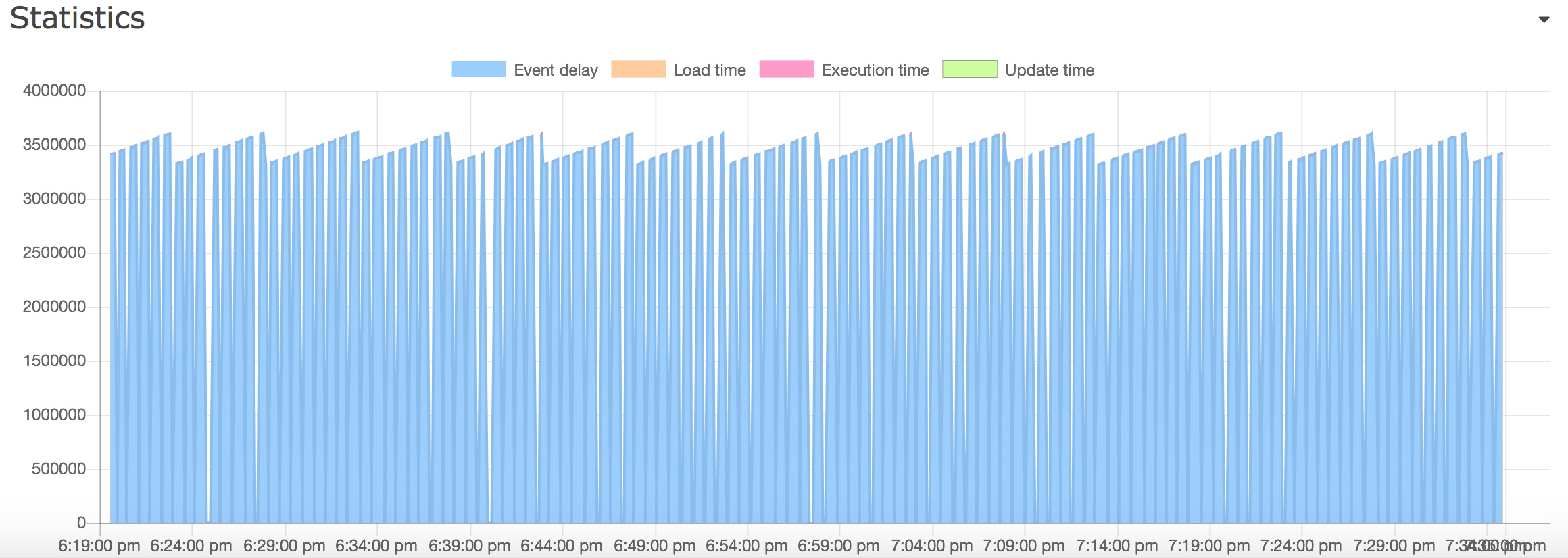

Anyone know why this is happening in my logs a few times a second… I haven’t added or changed anything for at least a few days and now this is happening and I can’t control devices in smart things
Its happening to both my houses, so i believe this to be a smartthings issue or perhaps one on webcore its self?
Seems all my pistons are not running properly and holding a whole lot up; many of them i can’t even pause…
This is for both my hubs
Try Settings > clean up and rebuild data cache in webCoRE via the ST app. I haven’t heard of any recent platform issues but it does look like everything is timing out.
If that doesn’t help, try going to the Available devices page in the smart app and see if you can load up the devices. A few people had timeout problems related to loading devices.
tried that; weirdly, one of my instances went back to normal after a few hours but the other has not; i have cleared the cache and also tried going back into settings >> devices and clicking save again
