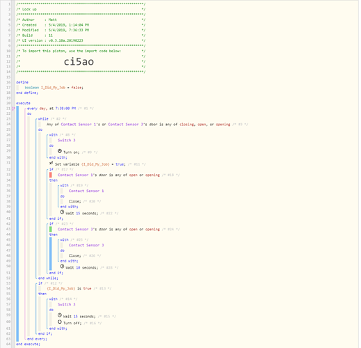

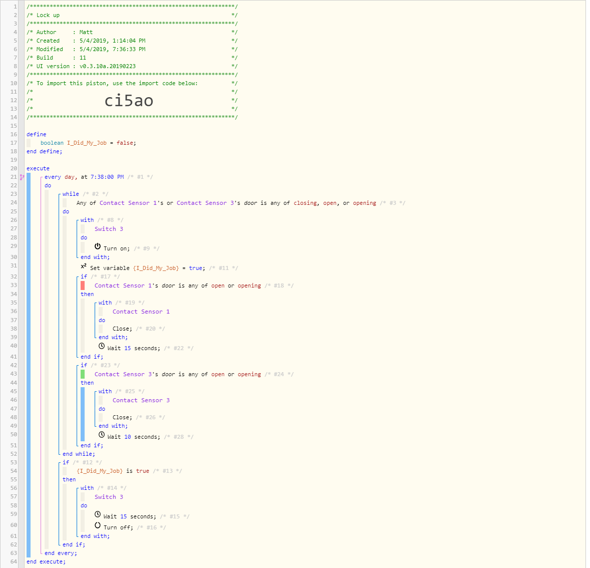

I have 2 garage doors controlled by the same MyQ controller. I am trying to write a piston to fire at a specified time to turn on the exterior house lights, close both garage doors (if they are open) wait a few seconds and turn out the lights again. I have tried many iterations of the same idea, but seem to be missing something
(PUT YOUR INFO HERE)
The second garge door does not get closed and the light remains on - likely because the piston does not complete the final IF statement

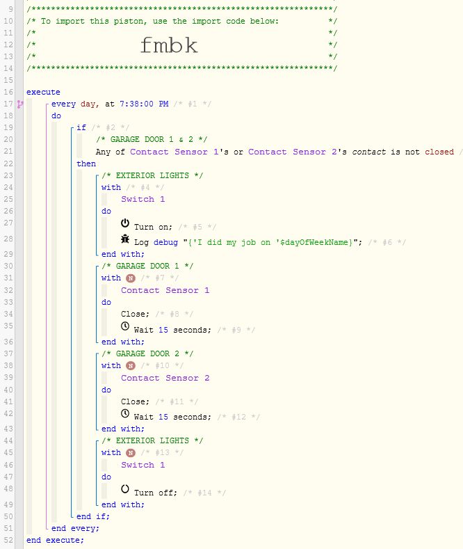

I would probably remove the WHILE, the extraneous conditions, and the variable, and streamline it something like this:
My logic is that webCoRE is smart enough to not send a “Close” command to a device that is already closed… and the variable you created is hurting more than helping.
Pro Tip:
It might be wise to add another WAIT before the ‘Close’ on line 34 above.
This is in case anyone happens to be nearby, they can see the light before the door starts moving (giving them a chance to get to safety)

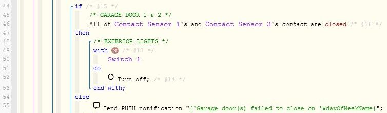

Well not surprisingly, your rendition worked considerably better. One last question, though. My hope was that the exterior lights would not turn off if either door fails to close. That was why I was using the variable to shut off the light. Is there an easy way to do this?

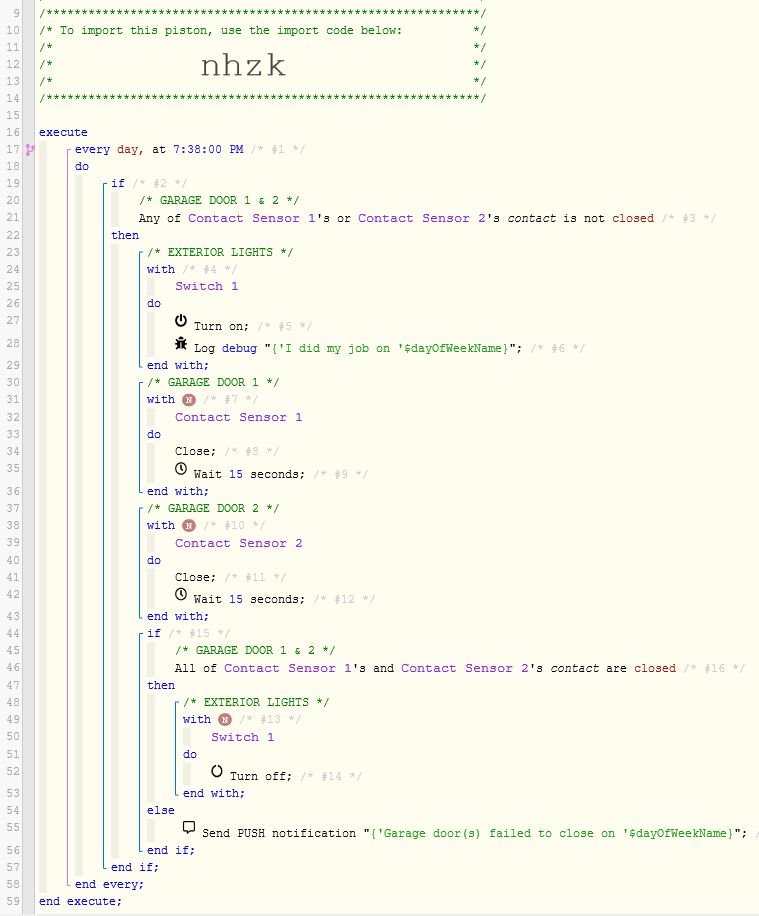

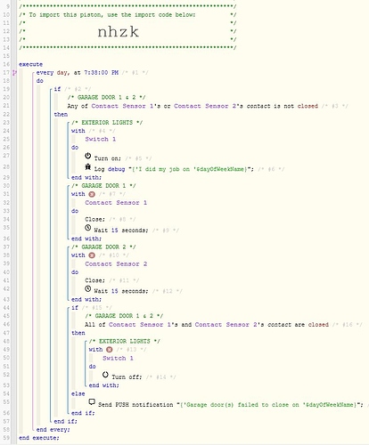

Here you go… I added that logic back in:

A lot of window blinds have the same issue, of not responding as quickly as we’d like and/or not reporting the changes back to the hub fast enough. Increasing the delay is likely the path I would take (for reliability) but you could always squeeze in another IF like I did above to check the status if you wanted.
Another option is to add a safety net at the very bottom, right below this:
                     Wait 5 minutes
                END IF
                IF ALL of Garage Door 1 & 2 are closed
                     Then Turn off Exterior lights
                     Else Send me a loud alert
                END IF
