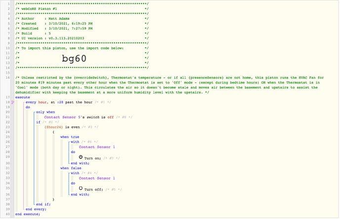

the piston does run every hour, but no actions happen in ST
2) What is the expected ![download%20(2)|690x444] ?
On the even hour turn virtual contact “on”, the odd hour, turn it “off”
no actions in ST

These are virtual “alexa switches” that show up in ST as contact sensors, I do have full control of them in alexa, IFTTT, and the ST apps, if that matters
also, tied changing the time to several minutes after the hour, and no difference.
This is partially taken form someone else’s piston that they shared. I don’t know how to remove their comment ref the Thermostat, that’s theirs not mine.
