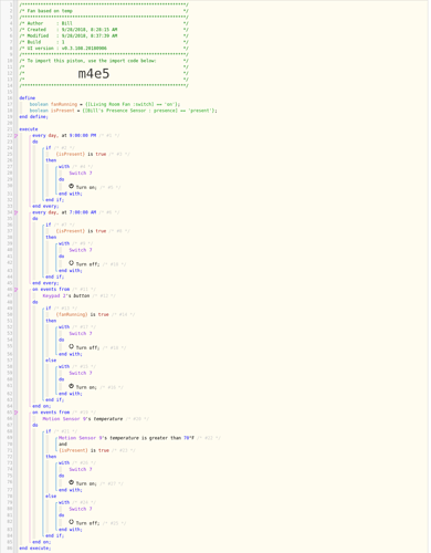

I have a window Fan connected to a Zwave outlet. I also have a Smarthings button/ temperature sensor.
I am looking for a piston that does the following:
-Use the button to toggle on and off the outlet regardless of other programming
  • Have the outlet automatically come on at 9:00 PM and off a 7:00 AM when i am home (presence sensor?)
  • when the above program is running I would like the outlet to turn on and off throughout the night based on the sensors temperature. if the temp is over 70 turn on, below 70 turn off type thing.
Any help would be very much appreciated

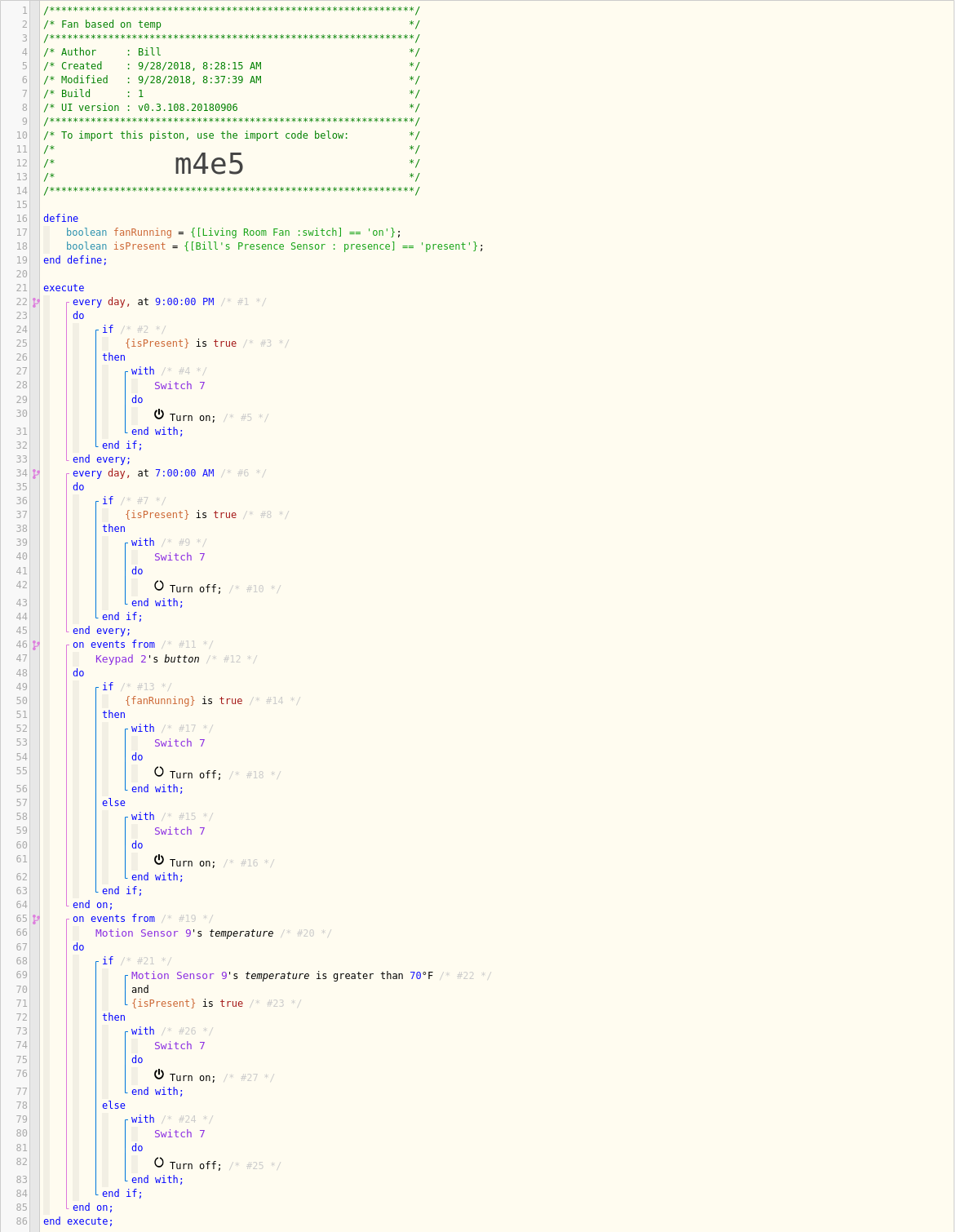

This should get you pointed in the right direction. I don’t have the new ST button/temp sensor, so I had to use a motion sensor.
Cant thank you enough, ill give this a try
