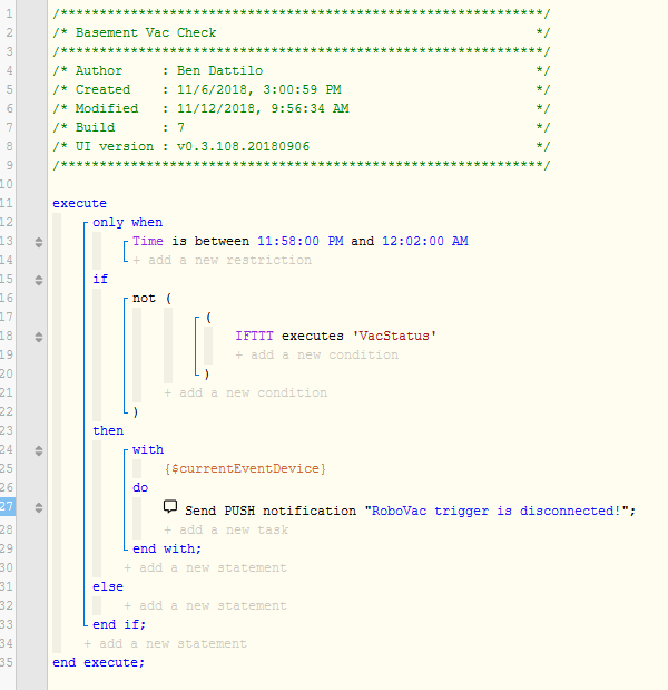

I have a robot vacuum that is not ‘smart’, so I have made it smart with a button pusher . Unfortunately this disconnects every now and then, so every night I want to test the pusher and send an alert if it does not beep (via camera sound alert) as expected.
The expected behavior is to send a push notification if there is no sound detected via the IFTTT webhook (which I have tested working) between 11:58pm and 12:02am.
The piston is not generating the alert during the defined execute time. Most likely I am not understanding how to activate a piston when something does not happen, and not execute the piston when something does happen. I am using logical negation of the IFTTT webhook implementation, which may not be the best way to implement this. Any suggestions welcomed!
What does VacStatus do?
That is the input WebHook from IFTTT. So I am trying to get an alert when that WebHook does not come in as anticipated between 11:58 and 12:02.

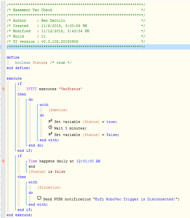

I think I figured out a solution that worked, thanks for pointing me towards using variables. Now I am setting a variable based on that IFTTT webhook, and then checking the variable at a certain time, with the variable clearing after a 5 minute period. Seems to work so far.
