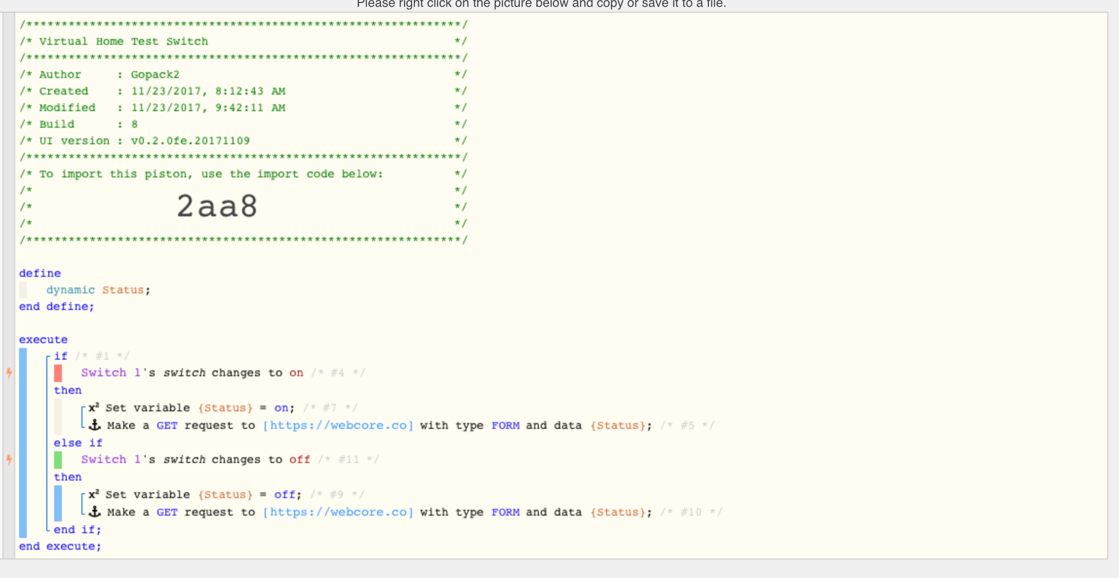

For those that may be interested.
  1. I set up a virtual location in smartthings called virtual Home
  2. I set up s virtual switch in the virtual Home location
  3. I set up an instance of webcore in the virtual Home location from smartthings
  4. I added this piston to the virtual Home location:

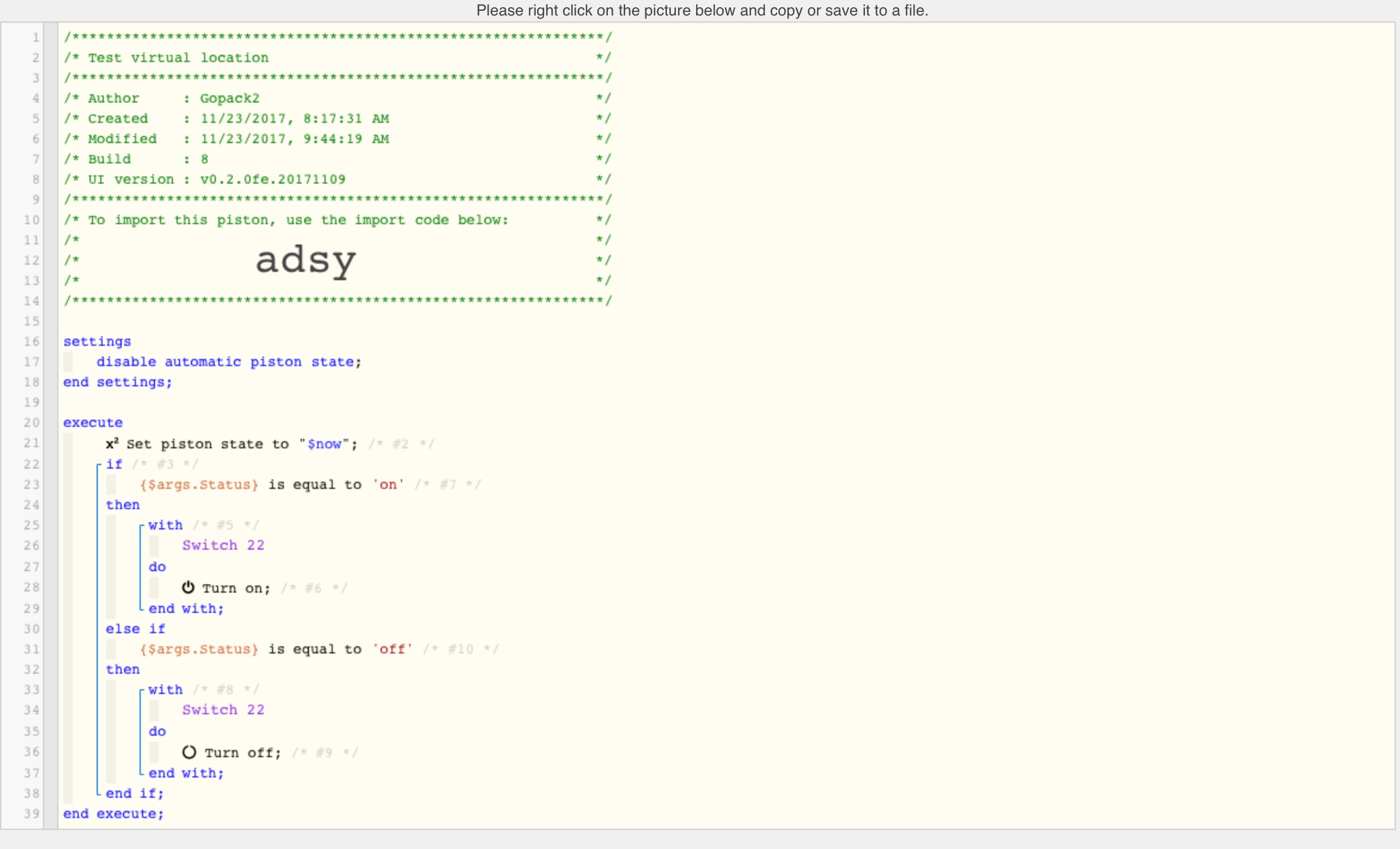

  5. In my normal home location I added this piston
If I trigger the test switch from my virtual location it turns on my light in my normal location
This may work also, I don’t know why it wouldn’t, if you have 2 hubs at different actual physical locations. I will have to try that too, as I have a vacation home with it’s own out about 300 miles away from my primary residence
[update]. Tried this with different physical locations and it works too. LOVING IT
Hope this helps someone that may need this
