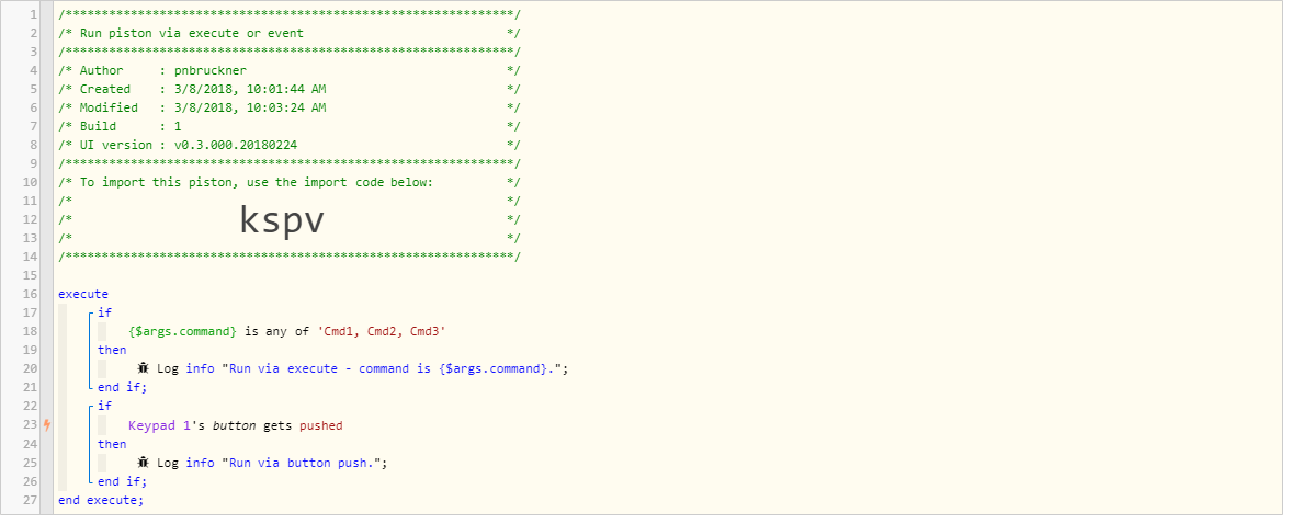

I use this technique - i.e., either the piston being invoked directly (in my case via IFTTT) or via a “normal” event. Here’s a simple example:

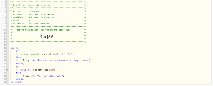

And here’s a log from it being invoked by another piston and by a button push:
3/8/2018, 10:07:26 AM +411ms
+2ms	╔Received event [Button 1].button = pushed with a delay of 78ms
+115ms	║Run via button push.
+119ms	╚Event processed successfully (118ms)
3/8/2018, 10:07:21 AM +688ms
+0ms	╔Received event [Doral Ct].execute = :b0c910121803b70c2a67109fe9263f0c: with a delay of 39ms
+102ms	║Run via execute - command is Cmd2.
+114ms	╚Event processed successfully (114ms)
This works because when invoked directly a parameter is passed (in this case $args.command), and when run via a trigger $args will be null. No need for another intermediate piston (although in some cases that might be useful.)
