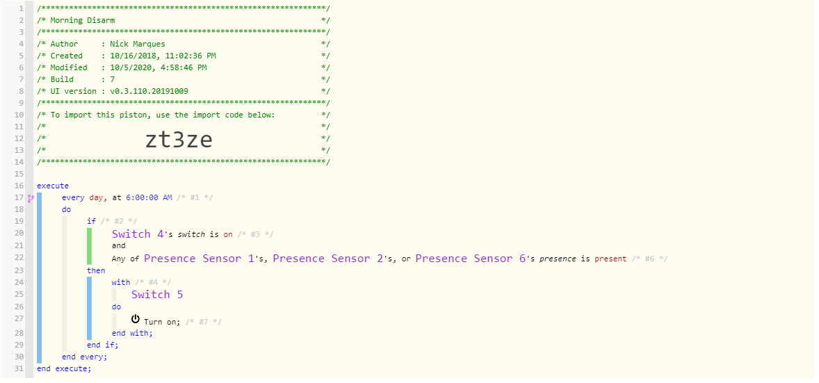

When SmartThings migrated my home to the new app, and SHM was no longer working with webCoRE and ActionTiles, I followed this write-up to make simulated switches to be controlled by both. Everything has been working great since then. Today, a piston did not execute a line where it Disarms SHM (turns on the Disarm switch) at 6am every morning if any of my family members are home and if SHM is in Armed (stay) mode.
SHM Disarm (switch) should have been turned on.
(PUT YOUR INFO HERE)
10/13/2020, 5:59:59 AM +99ms
+0ms ╔Received event [Home].time = 1602583200000 with a delay of -901ms
+74ms ║RunTime Analysis CS > 17ms > PS > 18ms > PE > 38ms > CE
+76ms ║Runtime (38265 bytes) successfully initialized in 18ms (v0.3.110.20191009) (75ms)
+77ms ║╔Execution stage started
+94ms ║║Comparison (enum) on is (string) on = true (2ms)
+95ms ║║Condition #3 evaluated true (8ms)
+126ms ║║Comparison (enum) present is (string) present = true (1ms)
+128ms ║║Condition #6 evaluated true (31ms)
+129ms ║║Condition group #2 evaluated true (state did not change) (42ms)
+130ms ║║Cancelling statement #4’s schedules…
+137ms ║║Skipped execution of physical command [STHM Disarm].on([]) because it would make no change to the device. (3ms)
+137ms ║║Executed [STHM Disarm].on (5ms)
+140ms ║╚Execution stage complete. (64ms)
+141ms ║Setting up scheduled job for Wed, Oct 14 2020 @ 6:00:00 AM EDT (in 86400.76s)
+147ms ╚Event processed successfully (147ms)
I am wondering if for some reason the ST automations aren’t keeping the switches in the correct state, or if webCoRE isn’t getting their status properly. Should I clear the ST automations and do everything in webCoRE?
