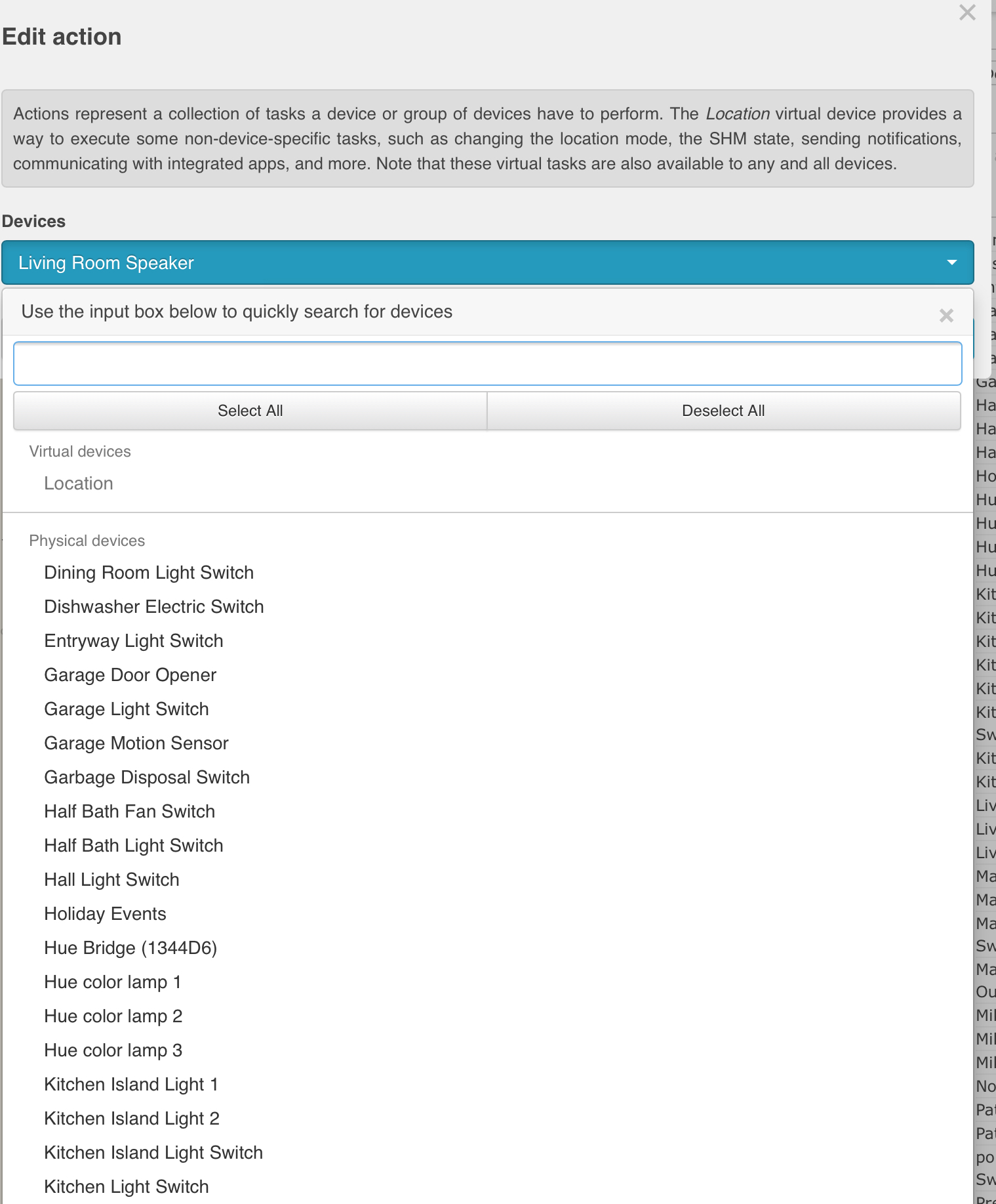

Yes but I can even find the wait command. Im a total noob at this.
It is under actions,
you select you with… in this case it is my speaker…

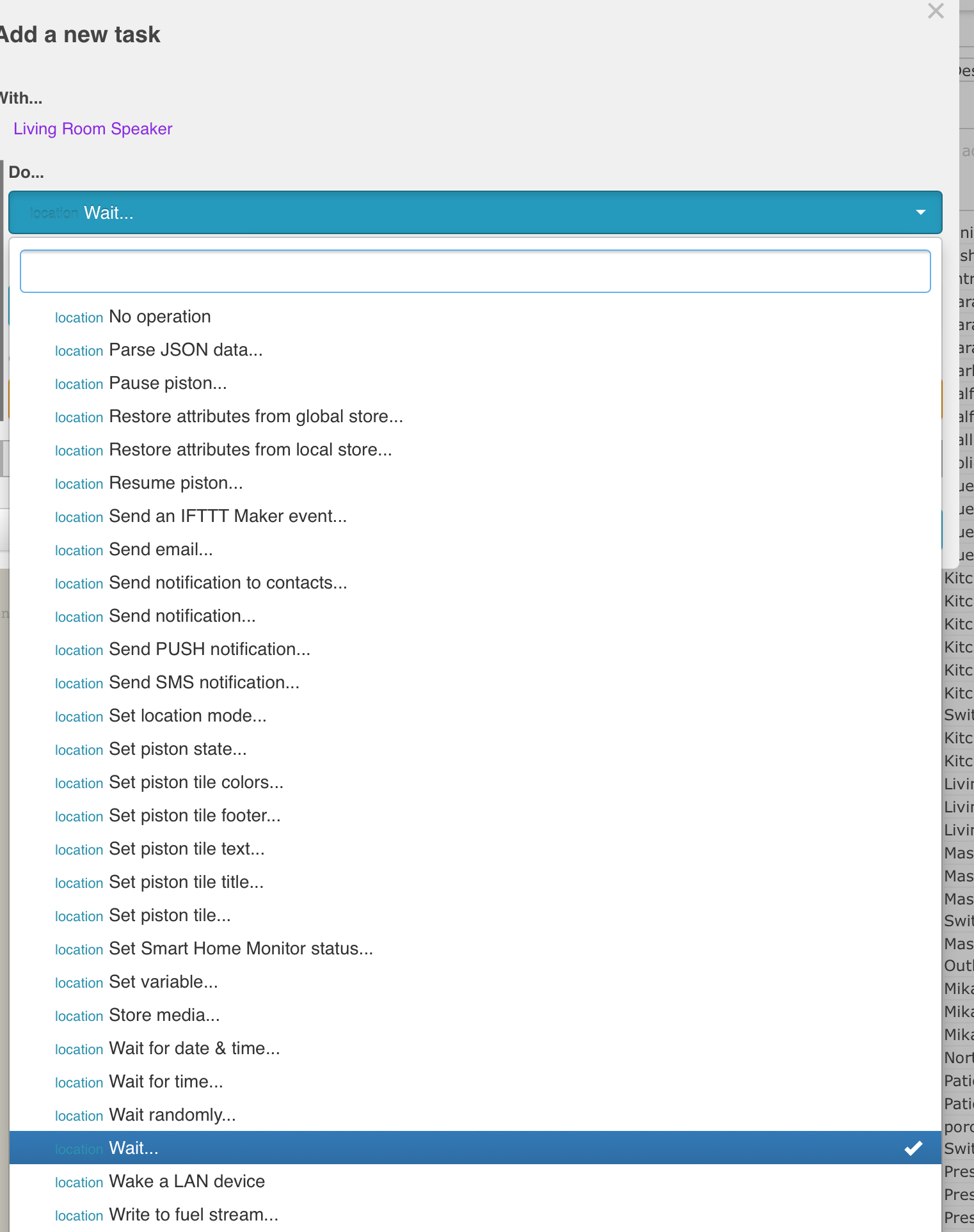

then select wait…

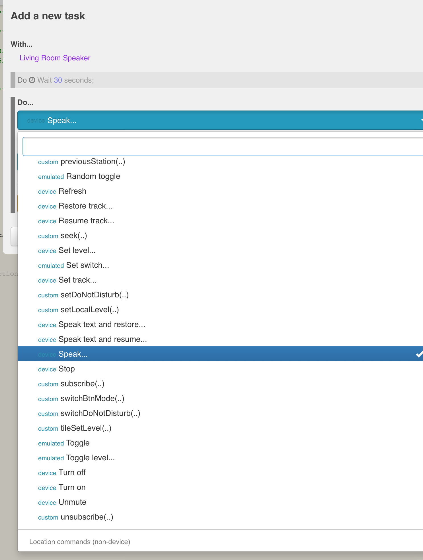

you need to scroll down for that… then select your speak command.

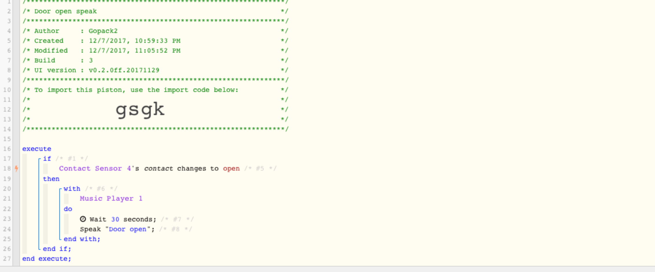

And you get this;
