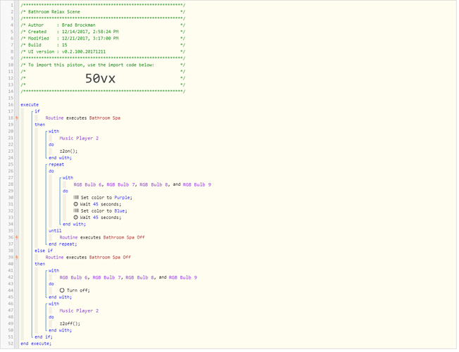

Hi, this piston works for the most part. The problem I am having is exiting the loop when I choose Bathroom Spa Off, it continues to run when I want to turn everything off. I appreciate any help.

I’d suggest adding a ‘Cancel all pending tasks’ after your last task to (hopefully) shut down all your timers.

Thank You, can you explain why/how this works? I am trying to learn more about Webcore. I do not understand why it was not exiting the loop (timer) prior to adding the "Cancel all pending task’.

It is exiting the loop but the timers were already set before the exit, it will not cancel the timers automatically. If there was a condition in that initial IF that changes other than Bathroom Spa executing, then the timers will cancel, webCoRE Task Cancellation Policy defaults to Cancel on condition change.
