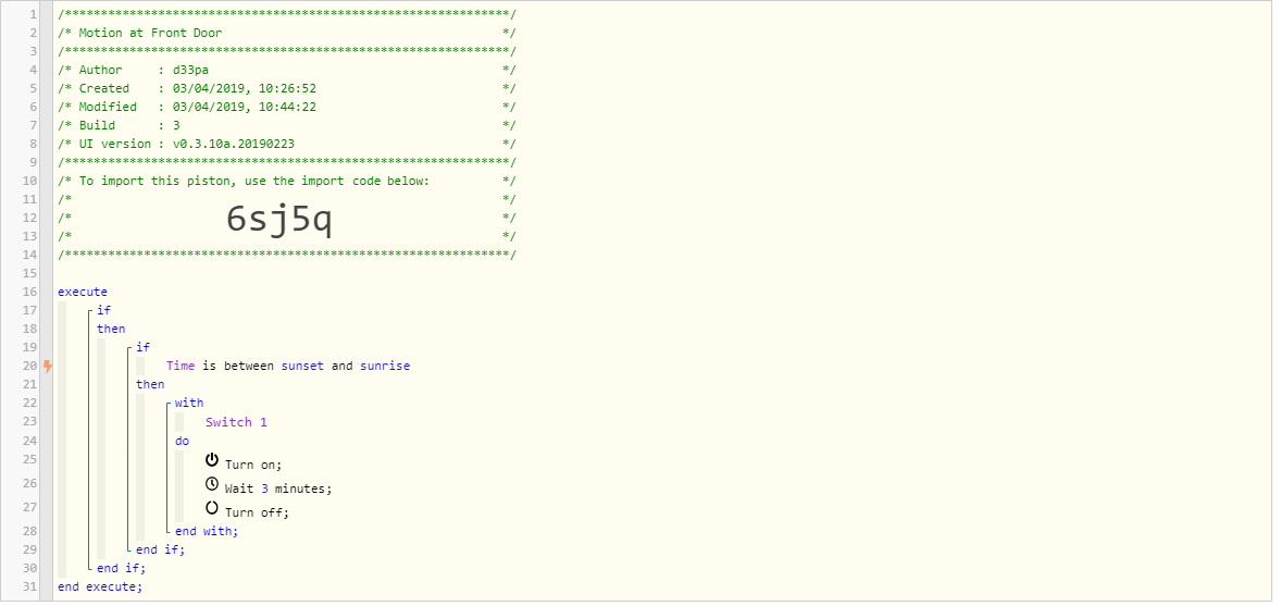

Enclose the turn on statement in if that will evaluate the current time is in between your requirement.
Thanks @eibyer!

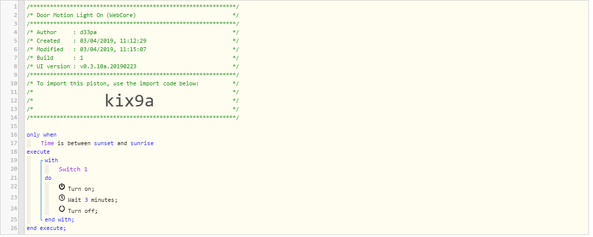

I think I got it…
see sample…

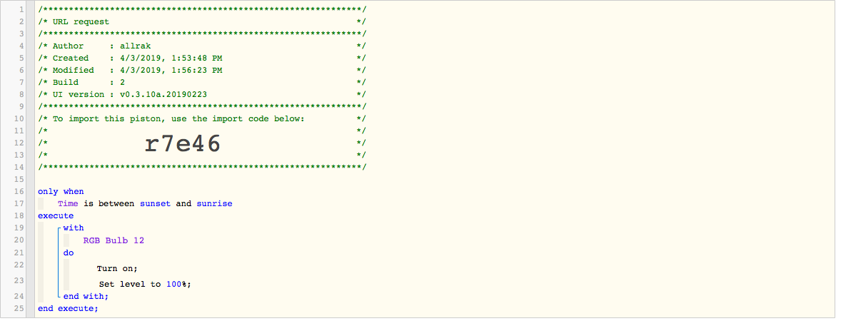

Here’ it is a little cleaner… Click “options” in the edit piston window and choose “show restrictions”.
Then make a time restriction as shown in my example.
much more elegant; I am pretty new to webcore, love it!!
