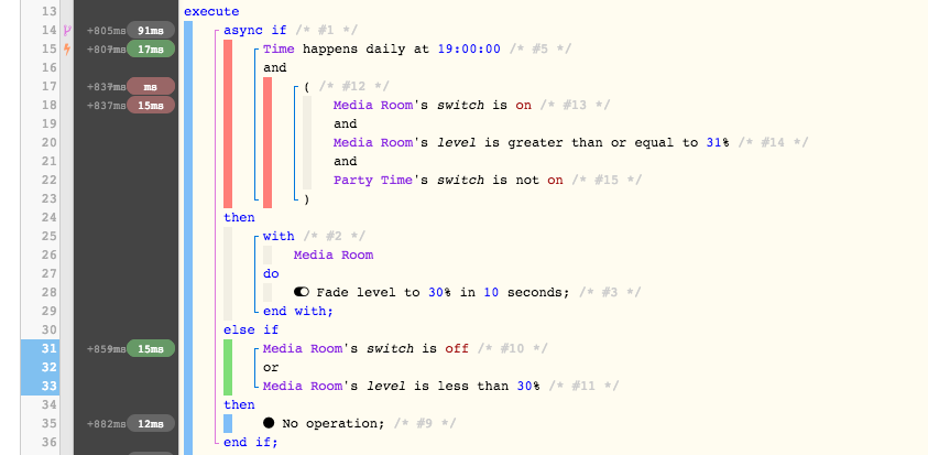

So, I have the following piston to dim my media room lights at 7pm if the level is greater or equal to 31%.

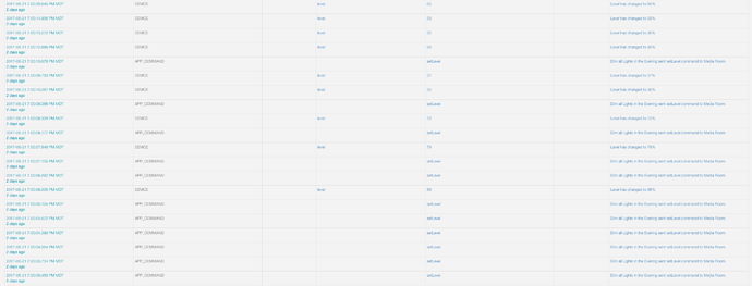

However, when it runs, it starts to fade, then the level bounces up and down a bit. Here’s the result log:
Can anybody shed any light on what’s happening here?

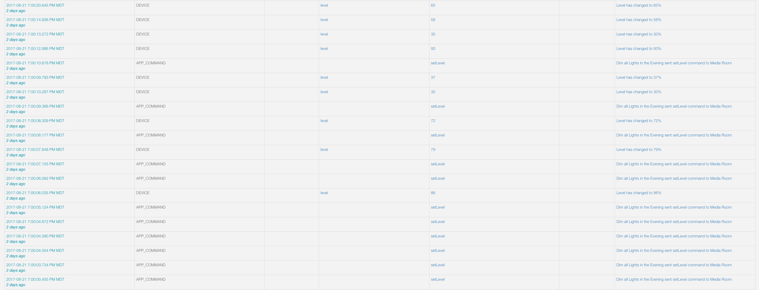

And here’s the result, because it said I can only put in one image as a new user :frowning:
