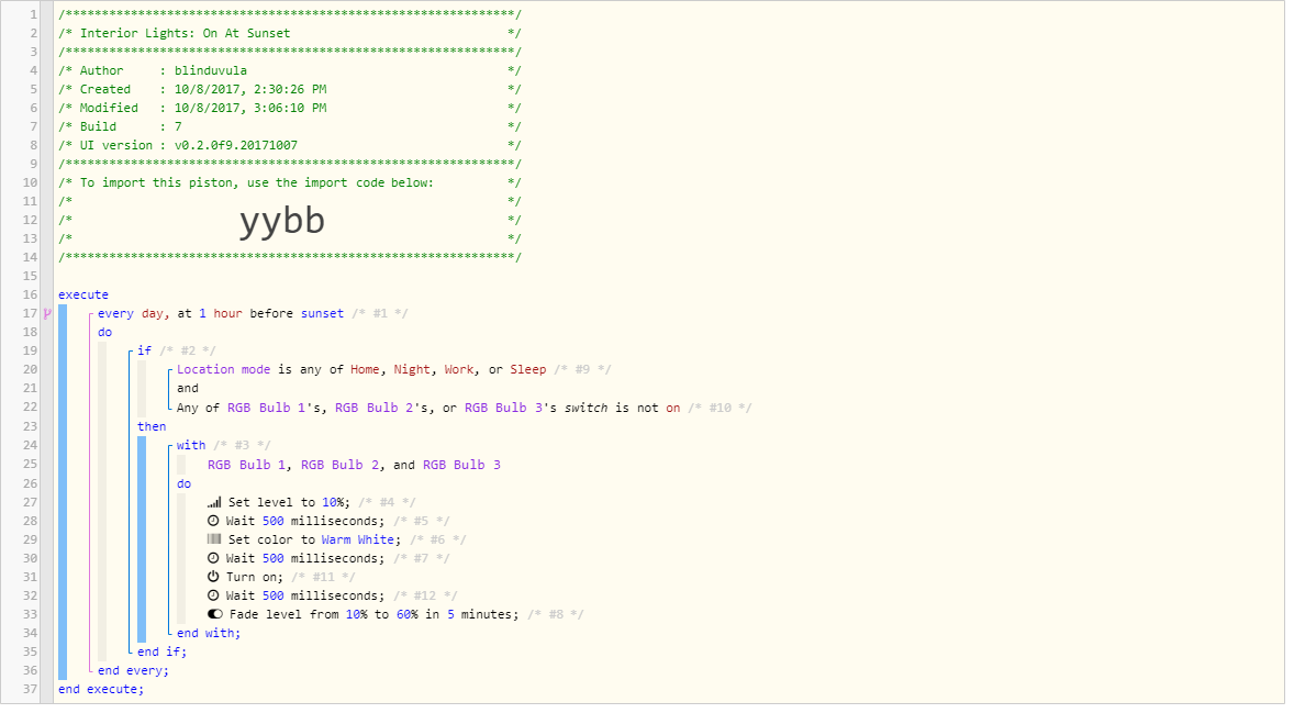

I’m trying to get a piston setup that will fade my living room lights from 1% to 60% over time an hour before the sun sets. When this piston executes it turns the lights on to 60%, then down to 1% and back up to 60%. I’m trying to figure out if there is a way to get the lights to come on at 1% instead of their last state.
Lights turn on at 1% instead of the last state.
Lights are turning on at their last state, dropping down to 1%, then raising back up to 60%.
