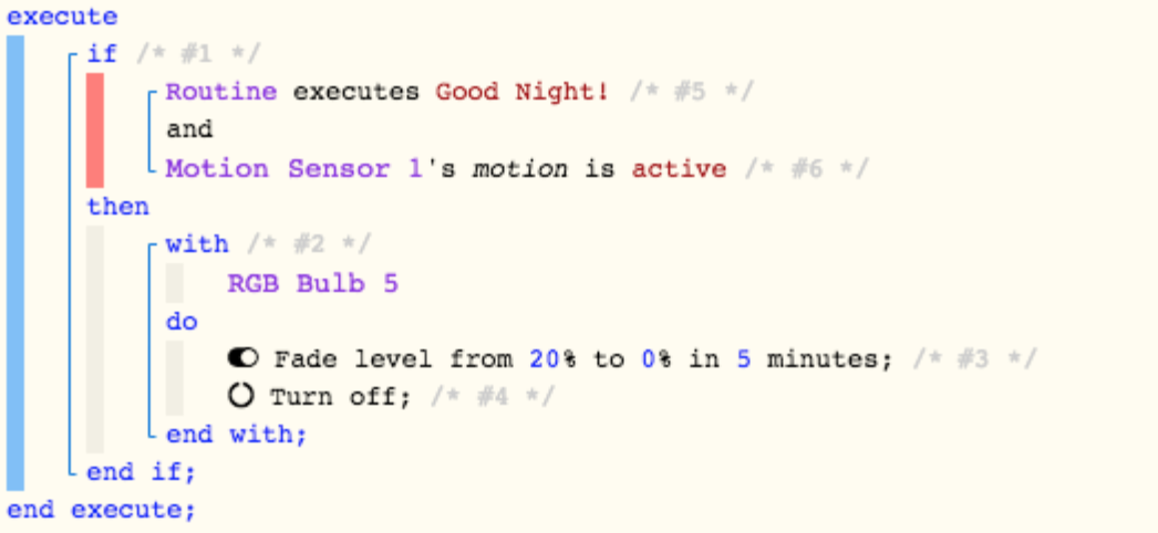

I have a simple piston that is supposed to fade an LED light to 0% then turn off. It fades to 0 on command… and then turns back on. I’d think its a fairly simple piston, but can’t figure out why it turns back on.

Do you mean to have AND between your conditions? So the sensor has to be active while Good Night is executed?
Either way, that wouldn’t contribute to what you’re seeing. Do you have another piston that controls this light? What are its conditions?
Yes, the AND is intentional. The Goodnight routine is usually run via Google Home, Ok Google Good Night. Which I call from downstairs. It also runs automatically at 2am. The lights I’m controlling are under my bed to give me light to get to bed. The AND for the motion sensor is so that the lights turn on when I’m downstairs, headed up, but don’t run at 2am when I’m already in bed.
And this is the only piston that uses this light. I’ll just have to turn some extra logging on and see if I can peg it down.
