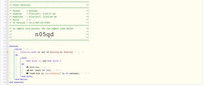

So I have a few bulbs I want to have fade into random colors when location is in a certain mode. So every hour it’s faded into a new color. I want this to run constantly until the mode is changed.
Would I use a “While Loop”?
While location is set to evening
With lights 1 and 2
Fade $randomhue
In 60 min
Something like that??
That will work
Just a disclaimer. I’m learning. And I suck at any type of programming. So pardon my total ignorance.
Do I need to define anything in the $randomhue part? From simple testing it always fades to the same colors each time the piston is activated…so I feel like I’m totally missing a step or not defining something I should.
It should be a different value at each run.
So this is what I have. For testing I have it set to 60 seconds. It does the same colors each time the piston runs. And after 60 seconds it’s quits executing. Like I said. I KNOW I’m missing a step/steps. But due to my total lack of knowledge and learning this all still. I don’t know WHICH step/steps. Lol

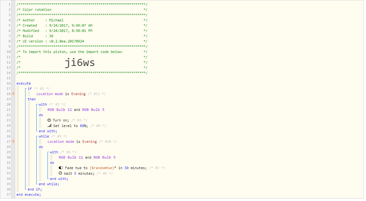

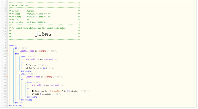

Turn logging onto full and capture some logs. That will help. Also turn on the trace option.

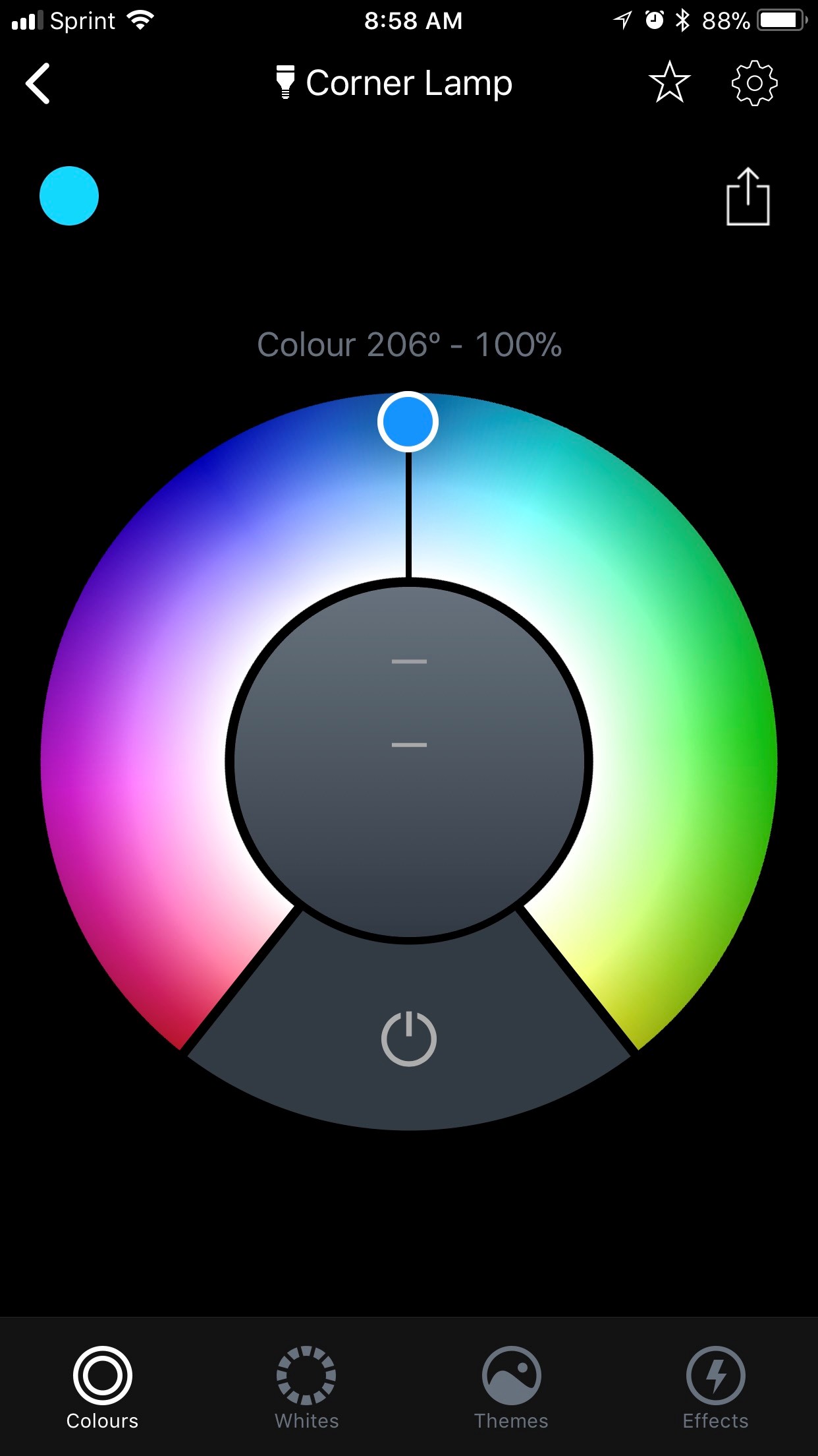

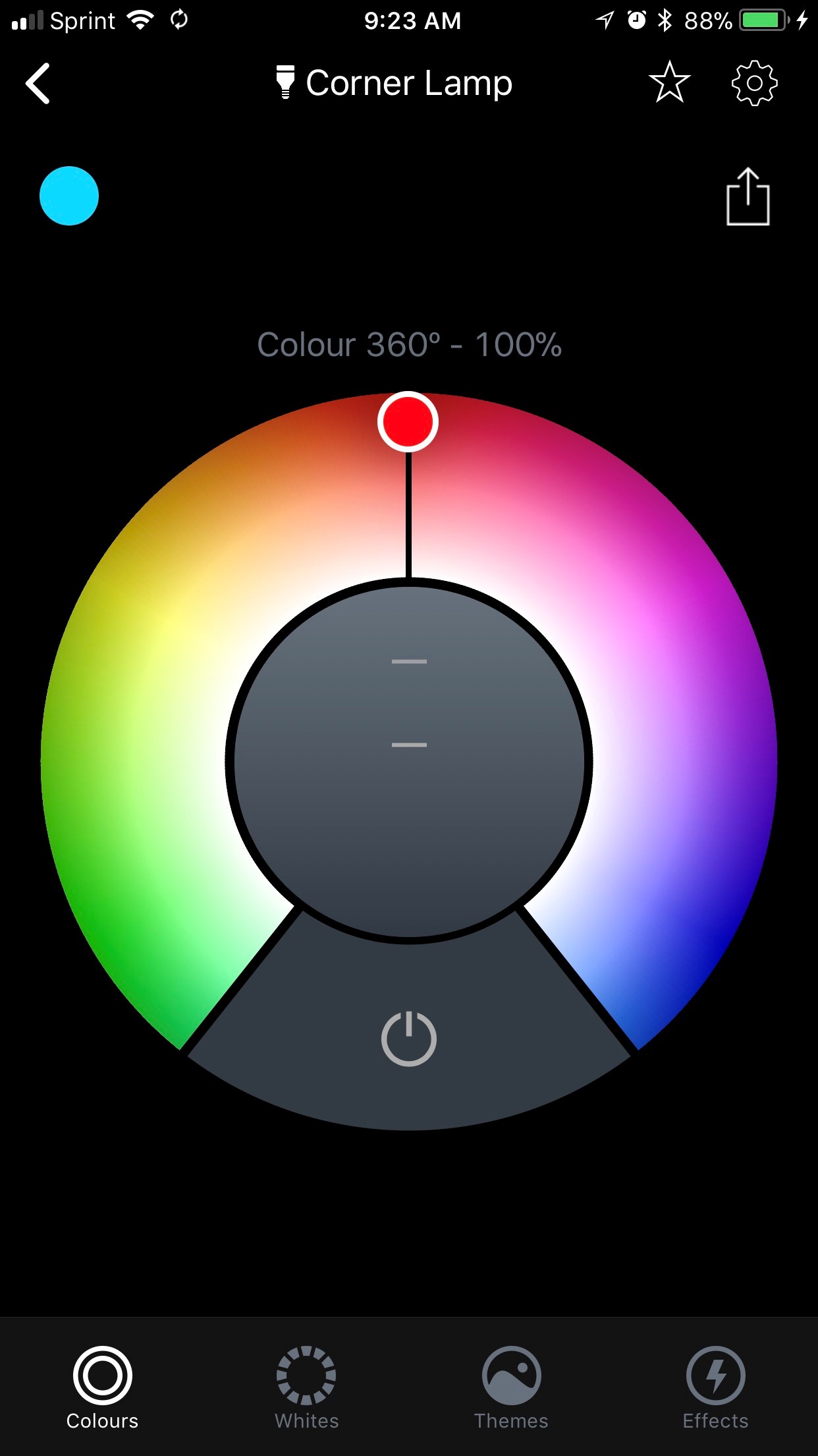

Trace showed nothing. Here are the logs. Always ends on red, which is a bit off putting as well. Haha.

Instead of fade to random hue try set hue instead or set HSL and use the randomHue for the H and S L can be 100
So when i use Set Color to random or Set Color HSL random, it seems to work as intended. But both bulbs are randomizing to different colors, and i dont have the the slow fade i was looking for.
Ok if you want the fade to remain we might have to restructure this quite a bit.
Currently you have the whole thing inside a while loop. So every command is being sent every time. This isn’t necessary.
Create something like

Ok, so based off what you said above. Something like this?
Yes exactly
Gonna give it a shot!!
Turn or keep logging on full
#15
Still having a weird issue. The bulbs are always going to be starting at 190°. Yet the logs are showing a totally different hue°. And watching the bulbs/app. I can verify the hue values the logs show vs what the bulb is actually doing are way off. Also anytime i use $randomhue, it always ends on red, 360°. I’ve attached a screen shot of the app showing what the bulb is displaying, time stamps in the log should be 8:58 for comparison.

So just to see what would happen. I set fad to hue 100° in 2 minuets. Starting at 190°. Piston started, and in 2 minuets faded to 360°.

Then did the same thing with a different starting hue (50). Same results, ramps up to 360°. Now if i do Set Hue 50°. It will work just fine. So its something with the randomhue, thats not jiving.
