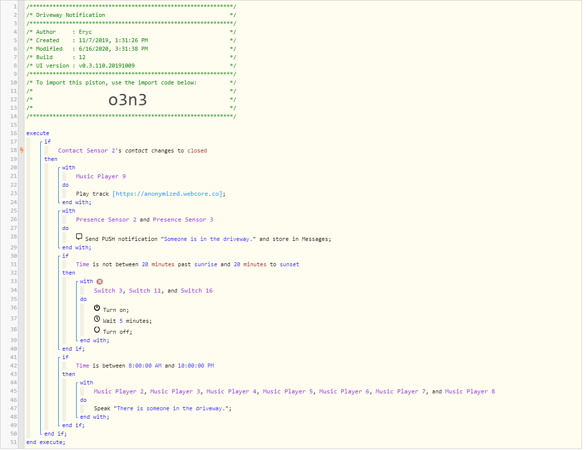

I have a Dakota Alert motion driveway monitor. It has contacts on the receiver that I wired to a Schlage Door contact. When there is motion in the driveway, the receiver beeps 8 times. It also sends a momentary “close” signal to the door contact.
(PUT YOUR INFO HERE)
I have a piston that, when the door contact is closed, turns on some lights during a certain time period, for 5 minutes), speaks on some google speakers, sends a push notification, and plays an mp3 on an aerotek doorbell speaker.
False alarms! The driveway receiver does not beep, but the piston fires.

|+445ms|║║Executed physical command [Garage Driveway Light].on() (11ms)|
|+445ms|║║Executed [Garage Driveway Light].on (12ms)|
|+448ms|║║Executed virtual command [Basement Door Light, Driveway Light, Garage Driveway Light].wait (0ms)|
|+449ms|║║Requesting a wake up for Thu, Jul 2 2020 @ 9:02:03 PM EDT (in 300.0s)|
|+453ms|║╚Execution stage complete. (309ms)|
|+455ms|║Setting up scheduled job for Thu, Jul 2 2020 @ 9:02:03 PM EDT (in 299.996s)|
|+463ms|╚Event processed successfully (463ms)|
|7/2/2020, 4:15:39 PM +995ms|
|+1ms|╔Received event [Driveway].contact = open with a delay of 61ms|
|+9128ms|║RunTime Analysis CS > 21ms > PS > 9043ms > PE > 65ms > CE|
|+9129ms|║Piston waited at a semaphore for 9014ms|
|+9131ms|║Runtime (40317 bytes) successfully initialized in 9043ms (v0.3.110.20191009) (9130ms)|
|+9132ms|║╔Execution stage started|
|+9139ms|║║Comparison (enum) open changes_to (string) closed = false (0ms)|
|+9141ms|║║Cancelling condition #2's schedules...|
|+9142ms|║║Condition #2 evaluated false (5ms)|
|+9143ms|║║Cancelling condition #1's schedules...|
|+9144ms|║║Condition group #1 evaluated false (state changed) (7ms)|
|+9145ms|║╚Execution stage complete. (13ms)|
|+9146ms|╚Event processed successfully (9146ms)|
|7/2/2020, 4:15:38 PM +808ms|
|+1ms|╔Received event [Driveway].contact = closed with a delay of 254ms|
|+119ms|║RunTime Analysis CS > 23ms > PS > 43ms > PE > 52ms > CE|
|+121ms|║Runtime (40249 bytes) successfully initialized in 43ms (v0.3.110.20191009) (118ms)|
|+122ms|║╔Execution stage started|
|+128ms|║║Comparison (enum) closed changes_to (string) closed = true (1ms)|
|+130ms|║║Cancelling condition #2's schedules...|
|+131ms|║║Condition #2 evaluated true (5ms)|
|+132ms|║║Cancelling condition #1's schedules...|
|+133ms|║║Condition group #1 evaluated true (state changed) (7ms)|
|+135ms|║║Cancelling statement #3's schedules...|
|+287ms|║║Executed physical command [Small Speaker].playTrack([5]) (146ms)|
|+288ms|║║Executed [Small Speaker].playTrack (147ms)|
|+290ms|║║Cancelling statement #15's schedules...|
|+314ms|║║Executed virtual command [Eryc Courmac's Pixel 4 XL, JAYSEN COURMAC's Pixel 3].sendPushNotification (19ms)|
|+369ms|║║Comparison (time) 58539125 is_not_between (time) 1593681180000 .. (time) 1593736320000 = false (9ms)|
|+371ms|║║Condition #14 evaluated false (54ms)|
|+372ms|║║Condition group #7 evaluated false (state did not change) (56ms)|
|+383ms|║║Comparison (time) 58539183 is_between (time) 28800000 .. (time) 79200000 = true (7ms)|
|+384ms|║║Time restriction check passed|
|+386ms|║║Condition #18 evaluated true (11ms)|
|+387ms|║║Condition group #17 evaluated true (state did not change) (12ms)|
|+389ms|║║Cancelling statement #19's schedules...|
|+692ms|║║Executed physical command [Google Entryway].speak([There is someone in the driveway.]) (296ms)|
|+693ms|║║Executed [Google Entryway].speak (297ms)|
|+935ms|║║Executed physical command [Google Garage].speak([There is someone in the driveway.]) (238ms)|
|+936ms|║║Executed [Google Garage].speak (239ms)|
|+1114ms|║║Executed physical command [Google Kitchen].speak([There is someone in the driveway.]) (174ms)|
|+1115ms|║║Executed [Google Kitchen].speak (175ms)|
|+1291ms|║║Executed physical command [Google Living Room].speak([There is someone in the driveway.]) (172ms)|
|+1292ms|║║Executed [Google Living Room].speak (173ms)|
|+1471ms|║║Executed physical command [Google Mudroom].speak([There is someone in the driveway.]) (174ms)|
|+1472ms|║║Executed [Google Mudroom].speak (176ms)|
|+1633ms|║║Executed physical command [Google Office].speak([There is someone in the driveway.]) (157ms)|
|+1634ms|║║Executed [Google Office].speak (159ms)|
|+1793ms|║║Executed physical command [Google Studio].speak([There is someone in the driveway.]) (154ms)|
|+1794ms|║║Executed [Google Studio].speak (156ms)|
|+1797ms|║╚Execution stage complete. (1676ms)|
|+1798ms|╚Event processed successfully (1798ms)|
|7/2/2020, 4:03:42 PM +871ms|
|+1ms|╔Received event [Driveway].contact = open with a delay of 62ms|
|+9364ms|║RunTime Analysis CS > 18ms > PS > 9292ms > PE > 54ms > CE|
|+9365ms|║Piston waited at a semaphore for 9263ms|
|+9367ms|║Runtime (40317 bytes) successfully initialized in 9292ms (v0.3.110.20191009) (9366ms)|
|+9368ms|║╔Execution stage started|
|+9375ms|║║Comparison (enum) open changes_to (string) closed = false (1ms)|
|+9376ms|║║Cancelling condition #2's schedules...|
|+9377ms|║║Condition #2 evaluated false (5ms)|
|+9378ms|║║Cancelling condition #1's schedules...|
|+9379ms|║║Condition group #1 evaluated false (state changed) (6ms)|
|+9380ms|║╚Execution stage complete. (12ms)|
|+9381ms|╚Event processed successfully (9381ms)|
|7/2/2020, 4:03:41 PM +923ms|
|+2ms|╔Received event [Driveway].contact = closed with a delay of 94ms|
|+122ms|║RunTime Analysis CS > 24ms > PS > 44ms > PE > 53ms > CE|
|+124ms|║Runtime (40245 bytes) successfully initialized in 44ms (v0.3.110.20191009) (121ms)|
|+125ms|║╔Execution stage started|
|+132ms|║║Comparison (enum) closed changes_to (string) closed = true (1ms)|
|+134ms|║║Cancelling condition #2's schedules...|
|+134ms|║║Condition #2 evaluated true (5ms)|
|+135ms|║║Cancelling condition #1's schedules...|
|+136ms|║║Condition group #1 evaluated true (state changed) (7ms)|
|+138ms|║║Cancelling statement #3's schedules...|
|+341ms|║║Executed physical command [Small Speaker].playTrack([5]) (197ms)|
|+342ms|║║Executed [Small Speaker].playTrack (199ms)|
|+345ms|║║Cancelling statement #15's schedules...|
|+377ms|║║Executed virtual command [Eryc Courmac's Pixel 4 XL, JAYSEN COURMAC's Pixel 3].sendPushNotification (25ms)|
|+432ms|║║Comparison (time) 57822303 is_not_between (time) 1593681180000 .. (time) 1593736320000 = false (11ms)|
|+434ms|║║Condition #14 evaluated false (55ms)|
|+435ms|║║Condition group #7 evaluated false (state did not change) (56ms)|
|+448ms|║║Comparison (time) 57822362 is_between (time) 28800000 .. (time) 79200000 = true (8ms)|
|+450ms|║║Time restriction check passed|
|+451ms|║║Condition #18 evaluated true (13ms)|
|+452ms|║║Condition group #17 evaluated true (state did not change) (14ms)|
|+455ms|║║Cancelling statement #19's schedules...|
|+674ms|║║Executed physical command [Google Entryway].speak([There is someone in the driveway.]) (211ms)|
|+675ms|║║Executed [Google Entryway].speak (213ms)|
|+854ms|║║Executed physical command [Google Garage].speak([There is someone in the driveway.]) (175ms)|
|+855ms|║║Executed [Google Garage].speak (177ms)|
|+1020ms|║║Executed physical command [Google Kitchen].speak([There is someone in the driveway.]) (160ms)|
|+1021ms|║║Executed [Google Kitchen].speak (162ms)|
|+1181ms|║║Executed physical command [Google Living Room].speak([There is someone in the driveway.]) (155ms)|
|+1182ms|║║Executed [Google Living Room].speak (157ms)|
|+1363ms|║║Executed physical command [Google Mudroom].speak([There is someone in the driveway.]) (176ms)|
|+1364ms|║║Executed [Google Mudroom].speak (178ms)|
|+1538ms|║║Executed physical command [Google Office].speak([There is someone in the driveway.]) (169ms)|
|+1539ms|║║Executed [Google Office].speak (171ms)|
|+1710ms|║║Executed physical command [Google Studio].speak([There is someone in the driveway.]) (165ms)|
|+1711ms|║║Executed [Google Studio].speak (167ms)|
|+1713ms|║╚Execution stage complete. (1588ms)|
|+1714ms|╚Event processed successfully (1714ms)|
|7/2/2020, 2:11:20 PM +544ms|
|+9117ms|║RunTime Analysis CS > 26ms > PS > 9039ms > PE > 51ms > CE|
|+9118ms|║Piston waited at a semaphore for 9011ms|
|+9120ms|║Runtime (40317 bytes) successfully initialized in 9039ms (v0.3.110.20191009) (9117ms)|
|+9120ms|║╔Execution stage started|
|+9127ms|║║Comparison (enum) open changes_to (string) closed = false (1ms)|
|+9128ms|║║Cancelling condition #2's schedules...|
|+9129ms|║║Condition #2 evaluated false (5ms)|
|+9130ms|║║Cancelling condition #1's schedules...|
|+9131ms|║║Condition group #1 evaluated false (state changed) (6ms)|
|+9132ms|║╚Execution stage complete. (12ms)|
|+9133ms|╚Event processed successfully (9133ms)|
|7/2/2020, 2:11:19 PM +481ms|
|+1ms|╔Received event [Driveway].contact = closed with a delay of 62ms|
|+100ms|║RunTime Analysis CS > 19ms > PS > 31ms > PE > 50ms > CE|
|+103ms|║Runtime (40248 bytes) successfully initialized in 31ms (v0.3.110.20191009) (101ms)|
|+104ms|║╔Execution stage started|
|+110ms|║║Comparison (enum) closed changes_to (string) closed = true (0ms)|
|+112ms|║║Cancelling condition #2's schedules...|
|+113ms|║║Condition #2 evaluated true (4ms)|
|+114ms|║║Cancelling condition #1's schedules...|
|+114ms|║║Condition group #1 evaluated true (state changed) (7ms)|
|+116ms|║║Cancelling statement #3's schedules...|
|+252ms|║║Executed physical command [Small Speaker].playTrack([5]) (131ms)|
|+253ms|║║Executed [Small Speaker].playTrack (133ms)|
|+256ms|║║Cancelling statement #15's schedules...|
|+272ms|║║Executed virtual command [Eryc Courmac's Pixel 4 XL, JAYSEN COURMAC's Pixel 3].sendPushNotification (11ms)|
|+315ms|║║Comparison (time) 51079756 is_not_between (time) 1593681180000 .. (time) 1593736320000 = false (9ms)|
|+316ms|║║Condition #14 evaluated false (42ms)|
|+317ms|║║Condition group #7 evaluated false (state did not change) (43ms)|
|+329ms|║║Comparison (time) 51079801 is_between (time) 28800000 .. (time) 79200000 = true (7ms)|
|+330ms|║║Time restriction check passed|
|+332ms|║║Condition #18 evaluated true (11ms)|
|+333ms|║║Condition group #17 evaluated true (state did not change) (13ms)|
|+335ms|║║Cancelling statement #19's schedules...|
|+805ms|║║Executed physical command [Google Entryway].speak([There is someone in the driveway.]) (464ms)|
|+806ms|║║Executed [Google Entryway].speak (466ms)|
|+995ms|║║Executed physical command [Google Garage].speak([There is someone in the driveway.]) (186ms)|
|+996ms|║║Executed [Google Garage].speak (188ms)|
|+1175ms|║║Executed physical command [Google Kitchen].speak([There is someone in the driveway.]) (175ms)|
|+1176ms|║║Executed [Google Kitchen].speak (177ms)|
|+1341ms|║║Executed physical command [Google Living Room].speak([There is someone in the driveway.]) (162ms)|
|+1342ms|║║Executed [Google Living Room].speak (164ms)|
|+1525ms|║║Executed physical command [Google Mudroom].speak([There is someone in the driveway.]) (179ms)|
|+1526ms|║║Executed [Google Mudroom].speak (182ms)|
|+1739ms|║║Executed physical command [Google Office].speak([There is someone in the driveway.]) (210ms)|
|+1740ms|║║Executed [Google Office].speak (212ms)|
|+1911ms|║║Executed physical command [Google Studio].speak([There is someone in the driveway.]) (166ms)|
|+1912ms|║║Executed [Google Studio].speak (168ms)|
|+1914ms|║╚Execution stage complete. (1810ms)|
|+1916ms|╚Event processed successfully (1915ms)|
|7/2/2020, 2:10:18 PM +612ms|
|+2ms|╔Received event [Driveway].contact = open with a delay of 110ms|
|+126ms|║RunTime Analysis CS > 28ms > PS > 43ms > PE > 55ms > CE|
|+129ms|║Runtime (40244 bytes) successfully initialized in 43ms (v0.3.110.20191009) (126ms)|
|+130ms|║╔Execution stage started|
|+138ms|║║Comparison (enum) open changes_to (string) closed = false (1ms)|
|+140ms|║║Cancelling condition #2's schedules...|
|+141ms|║║Condition #2 evaluated false (6ms)|
|+142ms|║║Cancelling condition #1's schedules...|
|+143ms|║║Condition group #1 evaluated false (state changed) (9ms)|
|+145ms|║╚Execution stage complete. (15ms)|
|+146ms|╚Event processed successfully (146ms)|
|7/2/2020, 9:25:03 AM +774ms|
|+1ms|╔Received event [Driveway].contact = closed with a delay of 92ms|
|+113ms|║RunTime Analysis CS > 22ms > PS > 38ms > PE > 53ms > CE|
|+115ms|║Runtime (40245 bytes) successfully initialized in 38ms (v0.3.110.20191009) (113ms)|
|+116ms|║╔Execution stage started|
|+123ms|║║Comparison (enum) closed changes_to (string) closed = true (1ms)|
|+124ms|║║Cancelling condition #2's schedules...|
|+125ms|║║Condition #2 evaluated true (5ms)|
|+126ms|║║Cancelling condition #1's schedules...|
|+127ms|║║Condition group #1 evaluated true (state changed) (7ms)|
|+129ms|║║Cancelling statement #3's schedules...|
|+191ms|║║Executed physical command [Small Speaker].playTrack([5]) (57ms)|
|+192ms|║║Executed [Small Speaker].playTrack (59ms)|
|+194ms|║║Cancelling statement #15's schedules...|
|+234ms|║║Executed virtual command [Eryc Courmac's Pixel 4 XL, JAYSEN COURMAC's Pixel 3].sendPushNotification (29ms)|
|+299ms|║║Comparison (time) 33904011 is_not_between (time) 1593681180000 .. (time) 1593736320000 = false (9ms)|
|+301ms|║║Condition #14 evaluated false (64ms)|
|+302ms|║║Condition group #7 evaluated false (state did not change) (66ms)|
|+314ms|║║Comparison (time) 33904079 is_between (time) 28800000 .. (time) 79200000 = true (7ms)|
|+315ms|║║Time restriction check passed|
|+317ms|║║Condition #18 evaluated true (12ms)|
|+318ms|║║Condition group #17 evaluated true (state did not change) (13ms)|
|+320ms|║║Cancelling statement #19's schedules...|
|+919ms|║║Executed physical command [Google Entryway].speak([There is someone in the driveway.]) (590ms)|
|+920ms|║║Executed [Google Entryway].speak (592ms)|
|+1108ms|║║Executed physical command [Google Garage].speak([There is someone in the driveway.]) (183ms)|
|+1109ms|║║Executed [Google Garage].speak (185ms)|
|+1299ms|║║Executed physical command [Google Kitchen].speak([There is someone in the driveway.]) (186ms)|
|+1300ms|║║Executed [Google Kitchen].speak (188ms)|
|+1519ms|║║Executed physical command [Google Living Room].speak([There is someone in the driveway.]) (215ms)|
|+1520ms|║║Executed [Google Living Room].speak (217ms)|
|+1789ms|║║Executed physical command [Google Mudroom].speak([There is someone in the driveway.]) (265ms)|
|+1790ms|║║Executed [Google Mudroom].speak (267ms)|
|+1979ms|║║Executed physical command [Google Office].speak([There is someone in the driveway.]) (184ms)|
|+1980ms|║║Executed [Google Office].speak (186ms)|
