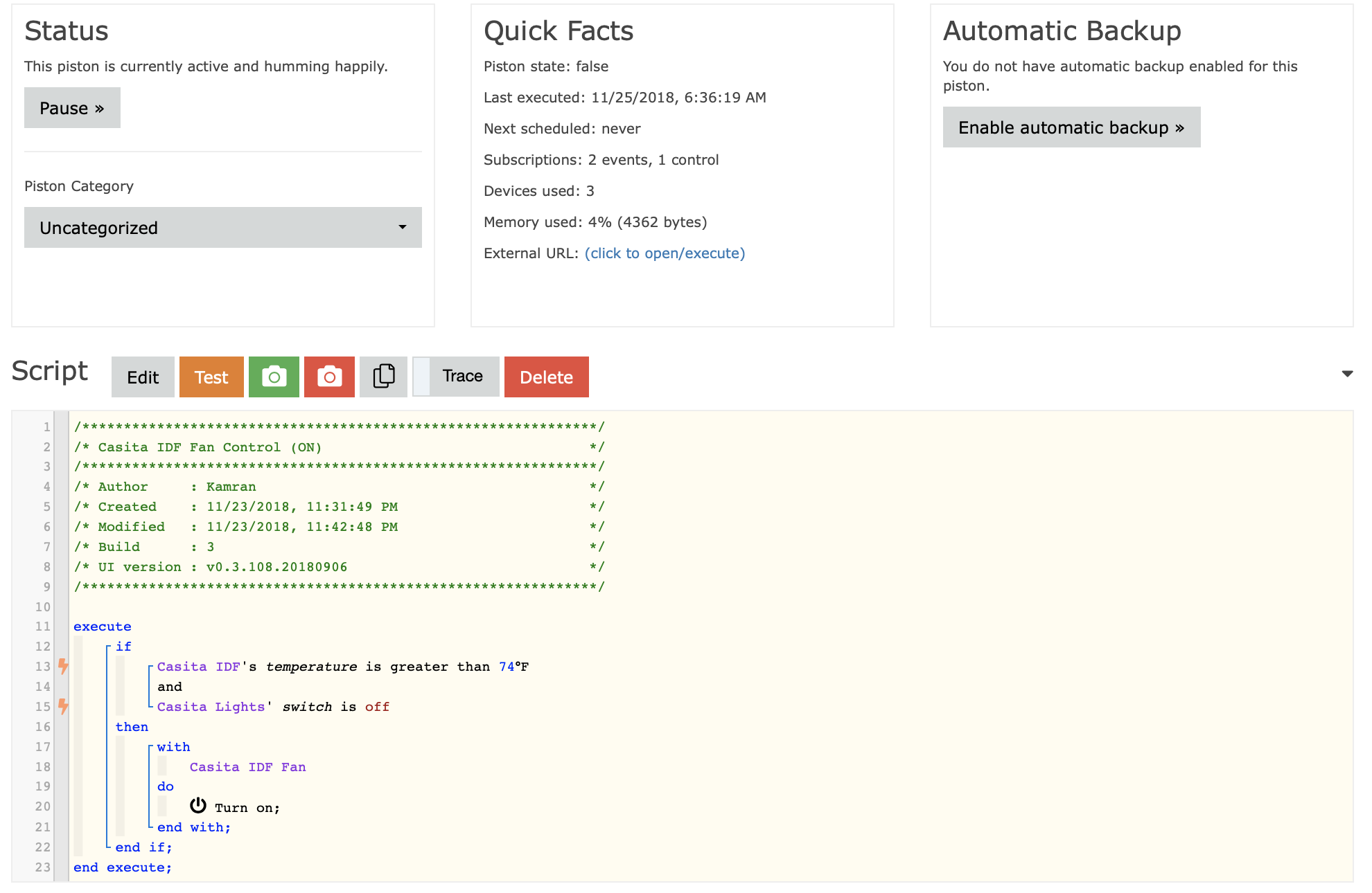

I want to control a fan (ST Outlet) based on the temperature from a Multisensor.
I have two Pistons that control the fan - turn it on & off.
TURN ON:
If temperature is greater than 74 and Casita Lights are OFF (implying nobody is in the room) turn on the Fan.

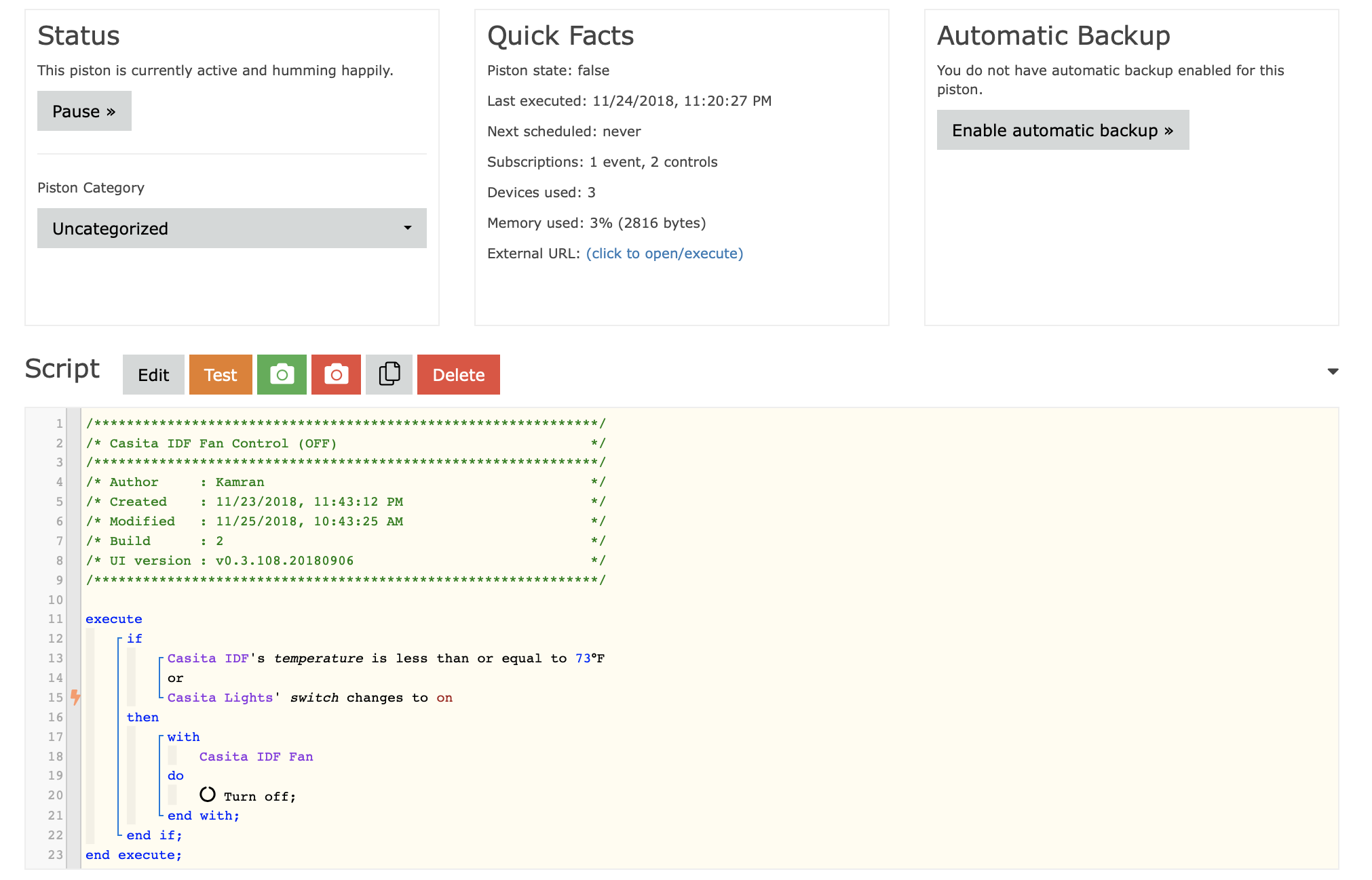

TURN OFF:
If temperature is less than or equal to 73 or Casita Lights turn on. Turn off the fan.

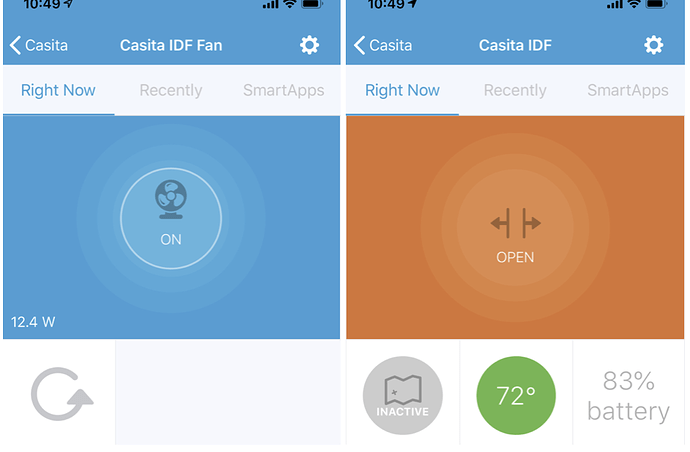

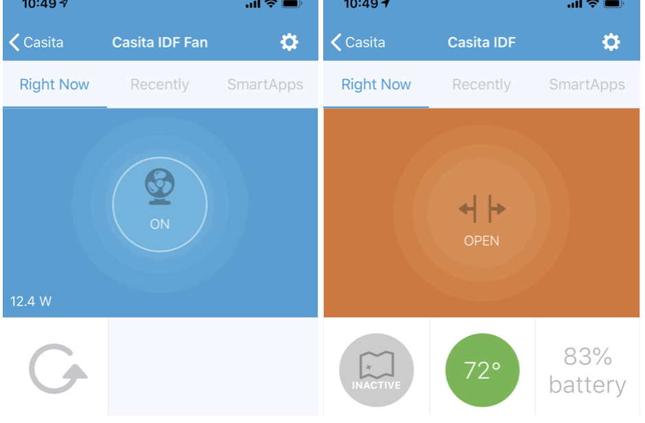

The multi sensor is reporting 72 and the fan is still running. It should have turned off when temps are or below 73.
Click on the OR between your two conditions and change it to “logical AND”.
