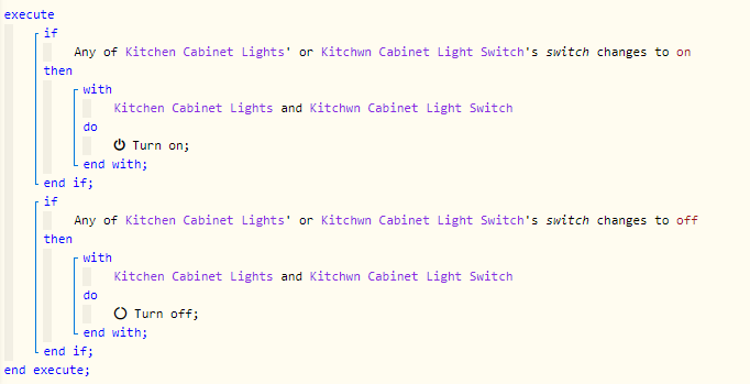

I have a Fibaro RGB controller that is plugged into a dedicated electrical outlet that is controlled by a smart ZWave wall switch. I want to keep the wall switch and the Fibaro in sync as far as power goes. So if I tell the Fibaro to turn off then I want the light switch to turn off. Same goes for turning on. If both are turned off and I turn the switch on, the Fibaro controller is still turned off. Is there a way to keep the 2 devices in sync as far as power goes?
If I turn on the Fibaro RGB controller I want the wall switch to be set to off, same goes for turning on.
I am very very knew to webCore. It looks to be very cool but I am just having a hard time wrapping my head around getting this problem I am trying to solve. Maybe I am over thinking it.
Thanks
