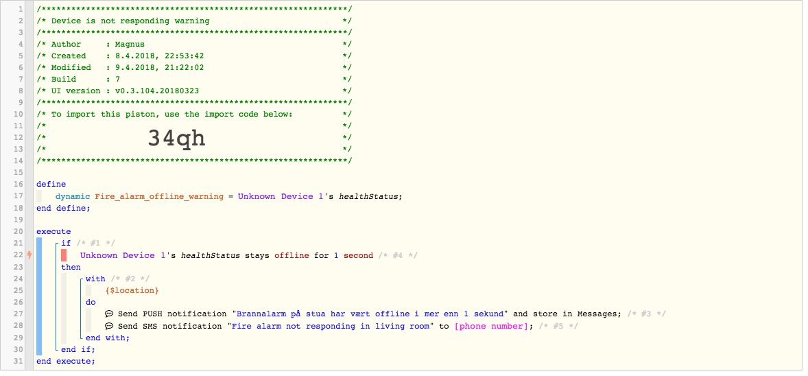

So I am trying to make my first piston here, and are kind of stuck already.
I am planning to set up a bunch of fire alarms in my house, and also a couple of rental houses, it´s really important that I get a notification if some of them goes offline for more than 8 hours (it¨s set up to report battery status every 4 hours, and it seems like it goes offline between these status updates)
I am not getting a notification, tried to set it up to report if it´s online and offline, but it does not work.

For info, these are the fire alarm´s I have bought: Heiman Z wave smoke alarm

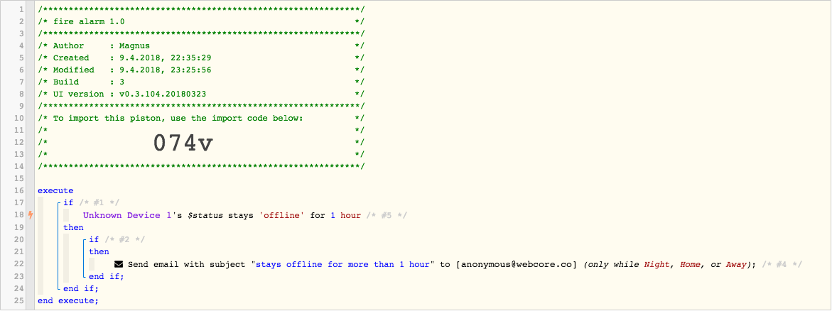

Review the values in IDE. They are case sensitive when evaluated in webcore. OFFLINE and offline matters.
Edit: I have a piston that checks for OFFLINE status and the variable I use is $status
thnx!
This was the values I found in IDE:
“originalStatus”: “offline”
I tried to change to this:
but with no luck. I will give it a shot again tomorrow. It´s getting late here.
here´s the log:
|+0ms|╔Received event [Snippen].test = 1523309360103 with a delay of 0ms|
|+86ms|║RunTime Analysis CS > 14ms > PS > 49ms > PE > 24ms > CE|
|+89ms|║Runtime (37312 bytes) successfully initialized in 49ms (v0.3.104.20180323) (88ms)|
|+90ms|║╔Execution stage started|
|+102ms|║║Comparison (string) OFFLINE stays (string) offline = false (2ms)|
|+105ms|║║Cancelling any timed trigger schedules for condition 5|
|+105ms|║║Cancelling statement #5’s schedules…|
|+106ms|║║Condition #5 evaluated false (10ms)|
|+107ms|║║Condition group #1 evaluated false (state did not change) (11ms)|
|+110ms|║╚Execution stage complete. (20ms)|
|+112ms|╚Event processed successfully (112ms)|
