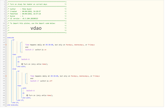

Don’t know if i have a problem - just want a sanity check
I have a lwrf socket with a fan heater plugged in. Haven’t integrated ST and LWRF so i’m triggering this on a sim switch using ifttt.
I have a work schedule that means sometimes i’m on earlies and sometimes on lates, unless asked to switch to cover someone else. I also generally work mon,wed,fri at home. If i’m due to work from home then i want the fan heater on for 30 mins before i start.
I’ve chosen to use a sim switch to indicate my shift to ST. Earlies can be switched on or off (via alexa, which makes it easier)
So basically, if i’m on earlies, the fan heater should come on at 5:30, if i’m on lates then 9:30
as this is my first piston, i just want some advice - does it look right? Are there smarter/better ways of doing when i’m doing? Can’t really use modes to decide whether i’m working from home or not, but have used them to ( i think) ensure it won’t fire if i’m away from home
(UPLOAD YOUR IMAGE HERE)
No logs collected as yet
switch 6 - fan heater.
switch 1 - ‘earlies’
Looks right to me… you can also just break it down into 2 separate Ifs just for easy reading.
