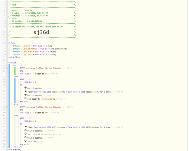

I am trying to have a light flash a certain color/s when motion is detected, or when another trigger happens. If the light is already on, I expect it to flash the color(s) and then return to the same color it was before being triggered. It is randomly selecting the color on restore, and the flash is never consistent.
When a trigger is set off (motion currently), a multicolor (sengled) light bulb should flash color to my choosing and return to the color it was before. Or if off, then turn off.
The bulb is not restoring to the proper color and instead picking one of the colors that was part of the flash. Also, the flash is inconsistent with timing between flashes of color.
