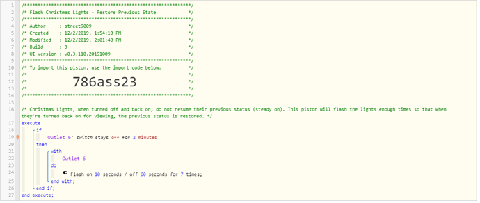

I’ve got a set of Christmas lights that have 8 different patterns that they can run through but I’ve found that when they’re off for a long time, they’ll go to the next pattern when turned back on. I’ve found that you can make it go to the next one if power hasn’t been on for too long, so I thought maybe I could have Webcore cycle back around to the pattern they were left on. They’re plugged into a smart switch (Peanut) and I thought that I could use Webcore to detect when the switch has been off for X amount of time and then flash. But it’s not working. I’m totally new to this so any help would be greatly appreciated.
After the switch has been off for X time (I have been testing with 2 minutes but will eventually change to something like 12 hours), turn the lights on for 10 seconds and off for 60. Repeat 7 times.
When the switch turns off, the piston executes and turns it back on, but then it stops.

Never tried this one before but in this piston you are trying to send a command to an OFF outlet.
I can only guess here and say, try turning it ON first…
I am thinking outside the box here, but why not prevent it from staying off for too long??
Every 3 hours
    Turn on
    Wait 60 seconds
    Turn off
END EVERY
That 3 hours can be tweaked, but ideally, as long as possible where the current setting sticks.
Also…
That 60 secs can be tweaked, but ideally, as short as possible where the current setting sticks.
Hmm that’s an interesting idea. I’d want to add a component to that to not do it when they’re already on but that could work.
Yes, good call.
I would start hours small, and increase until it “forgets”… Then back up a bit.
Same with the seconds… Start large (60?), and lower it until it “forgets”… Then raise it a bit
Once you know the requirements for the setting to stick, then you can build upon that logic.
