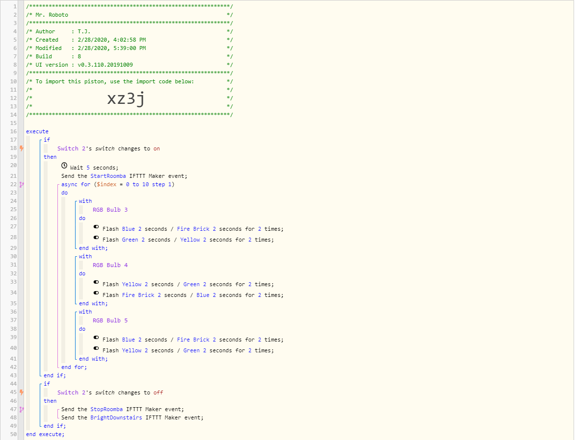

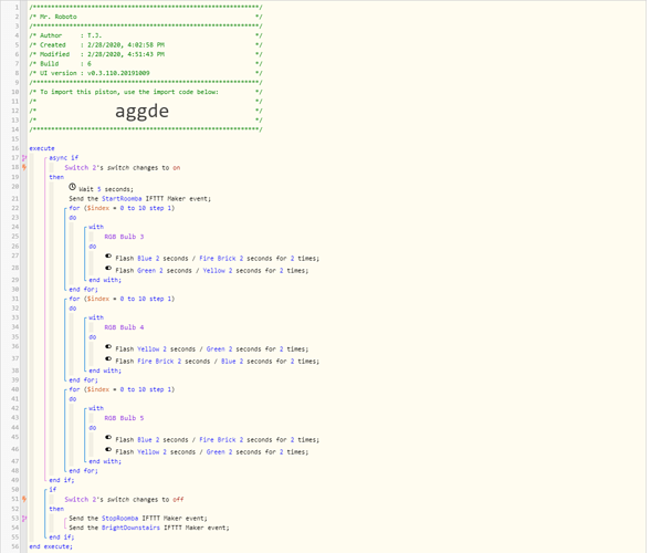

I would like to flash multiple Hue bulbs at once, but not all the same colors at the same time
All three bulbs will enter the flash pattern simultaneously
Only one bulb is flashing first, then the next
There’s a lot of log, do you really need it if it’s obvious in the code what I’m doing wrong?
I’ve tried setting the ‘IF’ to asynchronous but that didn’t work. Probably because that only affects the ‘IF’ side and not the ‘then’ side?
The key here is I want them to flash different colors at the same time, otherwise I would just add them all to the same ‘WITH’ group.
Thanks in advance!

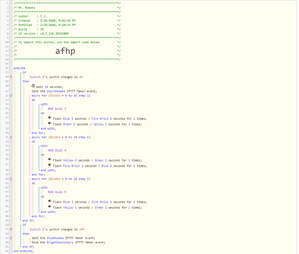

change the three for ($index = 0 to 10 step 1) to asynchronous
async for ($index = 0 to 10 step 1)
Is this what you mean? I tried this but this doesn’t work. Only the first light comes on still.
Thanks!
not what I meant…sorry.

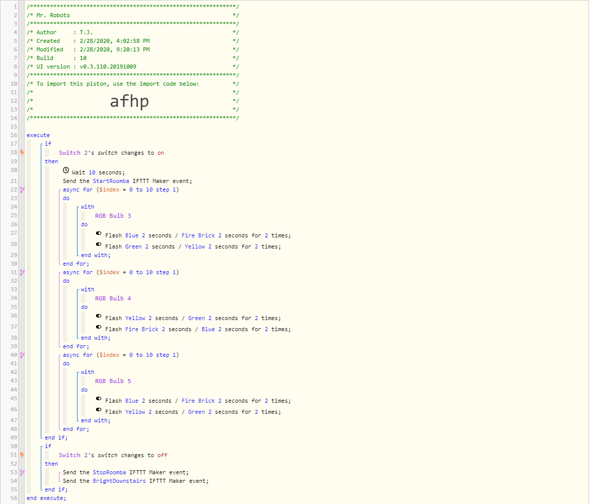

just edit the first piston you had, click on each of the three for lines and then click the cogwheel and change each of them to async.
Ok, I tried this, same thing happens. Only the first bulb starts the colors, the other two remain the same until the first one finishes its flash pattern
