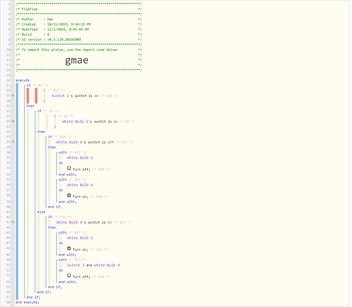

You keep reposting the same image (code ‘ivpn’) so can’t tell you are doing anything @WCmore is suggesting. I tried loading you code and there are links to add statements after every condition statement so I don’t understand where you are having a problem. You might have to capture a screen shot while you are in editing mode. I don’t see how what you are saying can actually happen in webcore.

I went back and looked at this again with fresh morning eyes and now got everything working as expected. I appreciate your help and patience.

Sure…see below:

I would be very surprised if that piston does not loop… but I am glad it is working for you…
#28
I agree, I am very surprised that this does not loop might be as its in the else statement … however do still keep an eye on the logs and make sure its not constantly running.

Quick Answer:
I don’t think it will constantly loop, but each event will likely loop more than once…
(you can verify by turning Logging to FULL)
Long Answer:
You have zero triggers in this piston… so all conditions are treated as triggers.
(the lightning bolts in the left margin)
This means, when any of the 3 devices changes (in either direction)…
  • Switch 1’s switch (on or off)
  • White Bulb 2’s switch (on or off)
  • White Bulb 4’s switch (on or off)
… the piston will run thru the entire code top to bottom, and execute anything not blocked by conditions.
All of this, paired with the knowledge that Momentary Switches takes a few moments to turn itself off, and the hub takes a moment to register the change… and you can see why I avoid this type of logic…
…but again, if it works for you, great…
Personally, I would never code like this:
IF DeviceA changes
    Then Change DeviceB
END IF
IF DeviceB changes
    Then Change DeviceA
END IF
