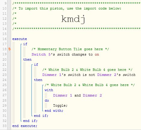

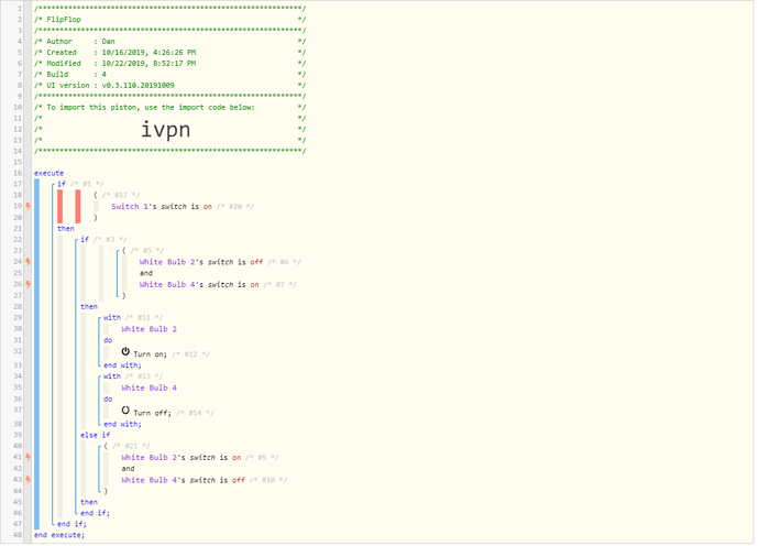

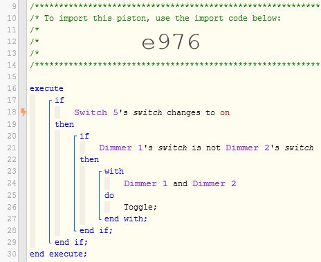

I create a ST Momentary Button Tile and the create a WebCore Piston that works fine for the first “IF” but can’t create the next “IF THEN” set of conditions and actions. I can’t second "Then If’ or “With Do” statements.
Here’s my question…WebCore does not allow me to create the “IF THEN” set of conditions “IF” and “Then” statements. What am I doing wrong? Why cant’ I create the second “THEN” statements at line 43.
