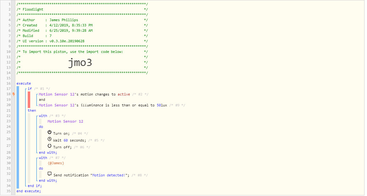

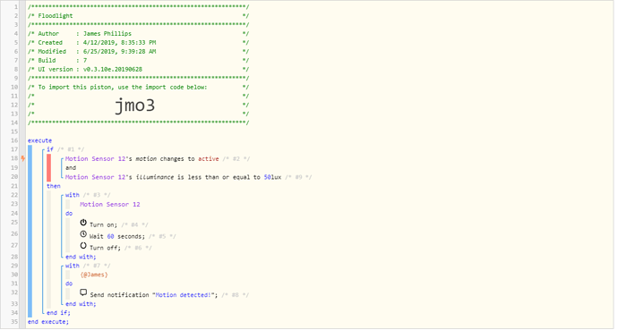

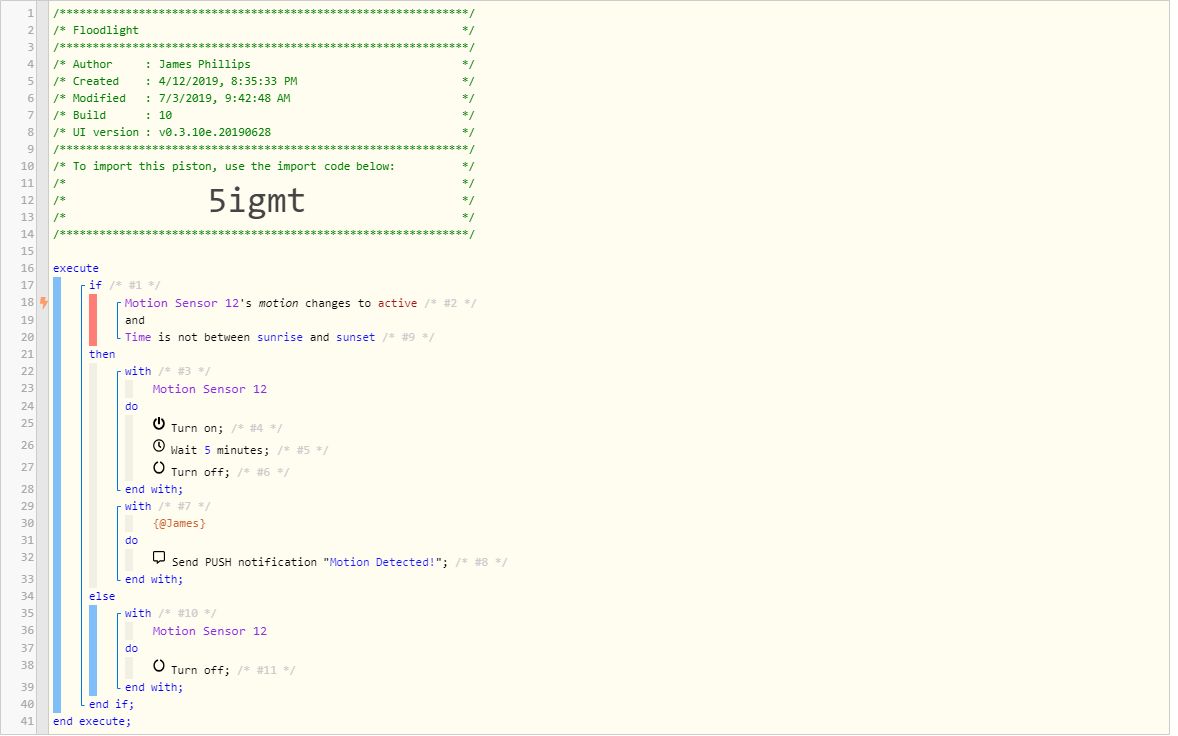

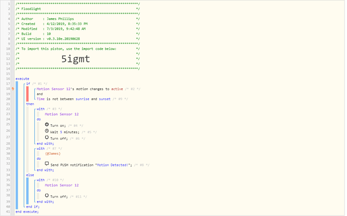

Webcore won’t send notifications that the lights are on and it turns on during the day
During the day, no lights turn on. At night, lights are turned on based on motion (for 60 seconds) and I should get a message saying someone is here
It is wonky - it’ll turn on forever sometimes, other times just for 10 seconds, but I never get a message on my phone
