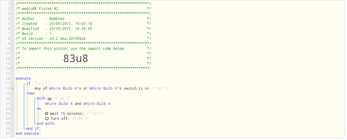

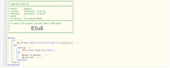

There sure is.
IF
Any of Osram light is on.
THEN
Wait 15 minutes.
Turn Off.
Are you happy with webCoRE or do you want a piston to import.
You can import this using the code.
Select add a piston and then import using backup code. (Second from bottom).
When it opens just put in your devices.
