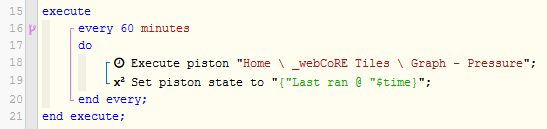

This is what I do… I have this piston on a hourly timer, and it’s sole purpose it to run one piston:
temp
Of course, I have about 5 pistons daisy chained that way, so this piston runs “Graph - Pressure”, and the last line on “Graph - Pressure” will run “Piston-C”, and the last line of “Piston-C” will run “Piston-D” etc. This keeps all my hourly pistons from overlapping and congesting my network.
