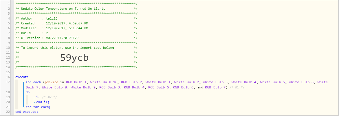

For each loop over bulbs - how to set color temperature of the $device variable?
I want to maintain a list of my color temperature capable bulbs, and use that to drive a for each loop to set the color temperature.
I’d like to be able to run the Set Color Temperature on the current device, but do not see a way to interface with that through the $device variable.

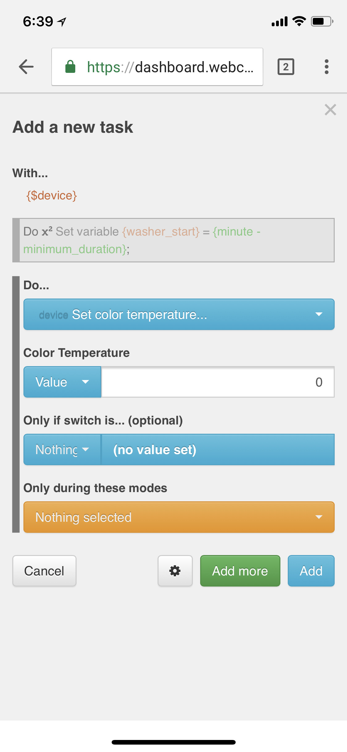

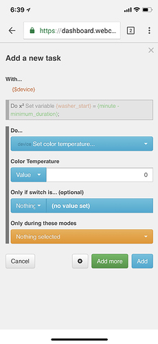

You should be able to add an action, choose $device, then find the Set color temperature action:
