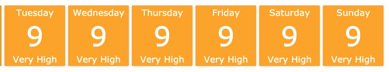

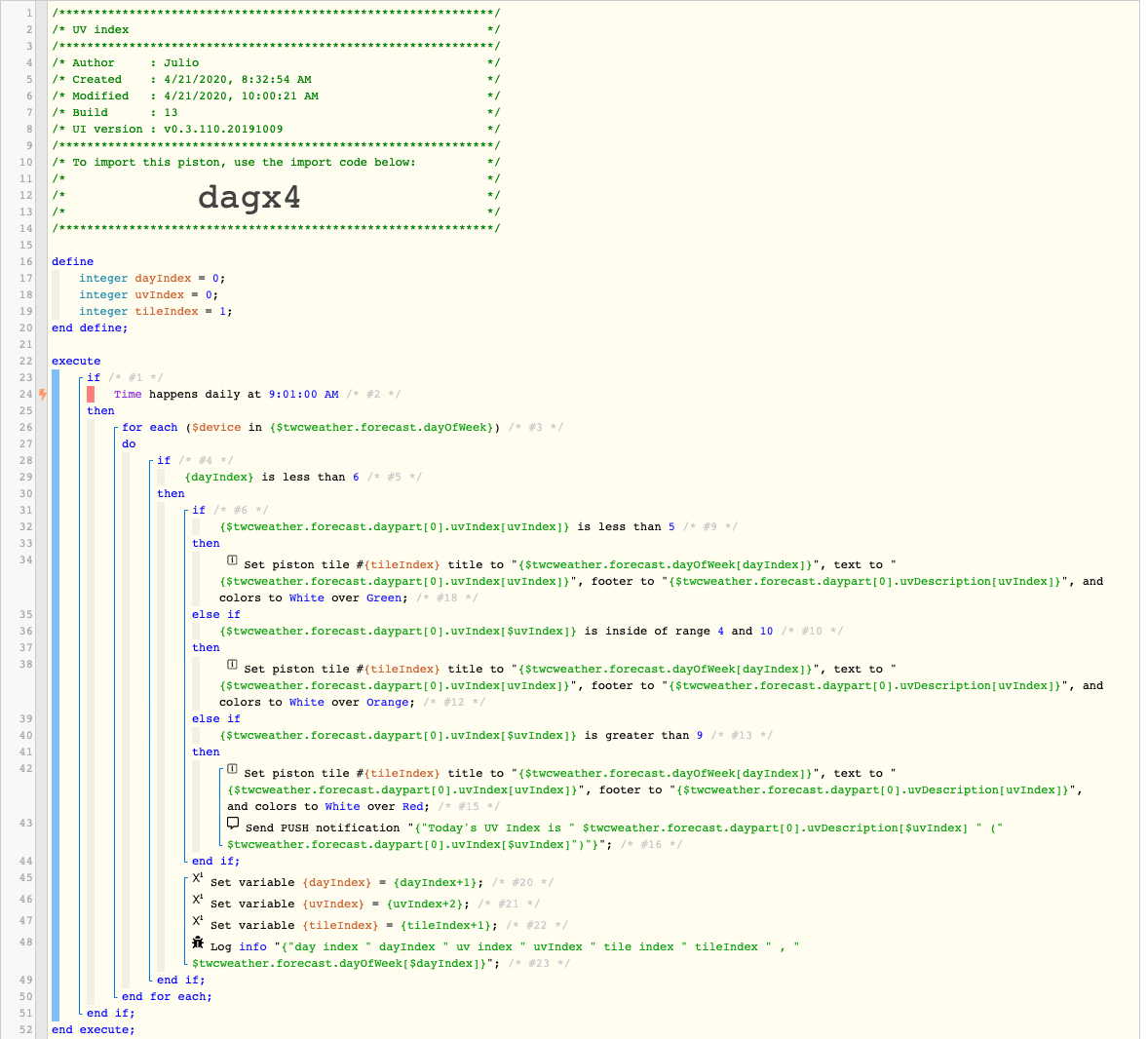

Trying to put together UV Index tiles. There might be one already, but from my searching the weather source was deprecated or it not working when I load it into a tile. :frowning:
Tiles should load 7 days of UV Index values and day of the week. i.e. Tuesday, Wednesday, Thursday, etc.
For some reason, my for each is not outputting the increment for the day (or UV index).
All other variables do increment, but the day is stuck on Tuesday [0]

4/21/2020, 10:01:59 AM +228ms
+0ms ╔Received event [My home].time = 1587488520000 with a delay of -773ms
+712ms ║RunTime Analysis CS > 408ms > PS > 269ms > PE > 36ms > CE
+715ms ║Runtime (47814 bytes) successfully initialized in 269ms (v0.3.110.20191009) (714ms)
+716ms ║╔Execution stage started
+731ms ║║Comparison (time) 36119949 happens_daily_at (time) 36120000 = true (0ms)
+733ms ║║Time restriction check passed
+734ms ║║Cancelling condition #2’s schedules…
+735ms ║║Condition #2 evaluated true (14ms)
+736ms ║║Cancelling statement #2’s schedules…
+742ms ║║Requesting time schedule wake up at Wed, Apr 22 2020 @ 10:02:00 AM PDT
+744ms ║║Cancelling condition #1’s schedules…
+745ms ║║Condition group #1 evaluated true (state changed) (24ms)
+1408ms ║║Comparison (integer) 0 is_less_than (integer) 6 = true (1ms)
+1409ms ║║Condition #5 evaluated true (6ms)
+1410ms ║║Condition group #4 evaluated true (state did not change) (8ms)
+1423ms ║║Comparison (dynamic) 9 is_less_than (integer) 5 = false (6ms)
+1424ms ║║Condition #9 evaluated false (12ms)
+1425ms ║║Condition group #6 evaluated false (state did not change) (13ms)
+1437ms ║║Comparison (dynamic) 9 is_inside_of_range (integer) 4 … (integer) 10 = true (3ms)
+1439ms ║║Condition #10 evaluated true (12ms)
+1439ms ║║Condition group #7 evaluated true (state did not change) (13ms)
+1442ms ║║Cancelling statement #11’s schedules…
+1464ms ║║Executed virtual command setTile (3ms)
+1468ms ║║Cancelling statement #19’s schedules…
+1474ms ║║Calculating (integer) 0 + (integer) 1 >> (integer) 1
+1477ms ║║Executed virtual command setVariable (1ms)
+1484ms ║║Calculating (integer) 0 + (integer) 2 >> (integer) 2
+1486ms ║║Executed virtual command setVariable (1ms)
+1493ms ║║Calculating (integer) 1 + (integer) 1 >> (integer) 2
+1496ms ║║Executed virtual command setVariable (1ms)
+1509ms ║║Calculating (string) day index + (string) 1 >> (string) day index 1
+1515ms ║║Calculating (string) day index 1 + (string) uv index >> (string) day index 1 uv index
+1518ms ║║Calculating (string) day index 1 uv index + (string) 2 >> (string) day index 1 uv index 2
+1522ms ║║Calculating (string) day index 1 uv index 2 + (string) tile index >> (string) day index 1 uv index 2 tile index
+1525ms ║║Calculating (string) day index 1 uv index 2 tile index + (string) 2 >> (string) day index 1 uv index 2 tile index 2
+1528ms ║║Calculating (string) day index 1 uv index 2 tile index 2 + (string) , >> (string) day index 1 uv index 2 tile index 2 ,
+1531ms ║║Calculating (string) day index 1 uv index 2 tile index 2 , + (string) Tuesday >> (string) day index 1 uv index 2 tile index 2 , Tuesday
+1534ms ║║day index 1 uv index 2 tile index 2 , Tuesday
+1535ms ║║Executed virtual command log (1ms)
+1545ms ║║Comparison (integer) 1 is_less_than (integer) 6 = true (1ms)
+1546ms ║║Condition #5 evaluated true (5ms)
+1547ms ║║Condition group #4 evaluated true (state did not change) (7ms)
+1554ms ║║Comparison (dynamic) 9 is_less_than (integer) 5 = false (1ms)
+1555ms ║║Condition #9 evaluated false (6ms)
+1556ms ║║Condition group #6 evaluated false (state did not change) (7ms)
+1564ms ║║Comparison (dynamic) 9 is_inside_of_range (integer) 4 … (integer) 10 = true (2ms)
+1565ms ║║Condition #10 evaluated true (8ms)
+1566ms ║║Condition group #7 evaluated true (state did not change) (9ms)
+1569ms ║║Cancelling statement #11’s schedules…
+1583ms ║║Executed virtual command setTile (2ms)
+1586ms ║║Cancelling statement #19’s schedules…
+1591ms ║║Calculating (integer) 1 + (integer) 1 >> (integer) 2
+1594ms ║║Executed virtual command setVariable (0ms)
+1598ms ║║Calculating (integer) 2 + (integer) 2 >> (integer) 4
+1601ms ║║Executed virtual command setVariable (1ms)
+1606ms ║║Calculating (integer) 2 + (integer) 1 >> (integer) 3
+1608ms ║║Executed virtual command setVariable (1ms)
+1621ms ║║Calculating (string) day index + (string) 2 >> (string) day index 2
+1625ms ║║Calculating (string) day index 2 + (string) uv index >> (string) day index 2 uv index
+1628ms ║║Calculating (string) day index 2 uv index + (string) 4 >> (string) day index 2 uv index 4
+1632ms ║║Calculating (string) day index 2 uv index 4 + (string) tile index >> (string) day index 2 uv index 4 tile index
+1635ms ║║Calculating (string) day index 2 uv index 4 tile index + (string) 3 >> (string) day index 2 uv index 4 tile index 3
+1637ms ║║Calculating (string) day index 2 uv index 4 tile index 3 + (string) , >> (string) day index 2 uv index 4 tile index 3 ,
+1640ms ║║Calculating (string) day index 2 uv index 4 tile index 3 , + (string) Tuesday >> (string) day index 2 uv index 4 tile index 3 , Tuesday
+1643ms ║║day index 2 uv index 4 tile index 3 , Tuesday
+1644ms ║║Executed virtual command log (1ms)
+1653ms ║║Comparison (integer) 2 is_less_than (integer) 6 = true (1ms)
+1654ms ║║Condition #5 evaluated true (5ms)
+1655ms ║║Condition group #4 evaluated true (state did not change) (6ms)
+1662ms ║║Comparison (dynamic) 9 is_less_than (integer) 5 = false (1ms)
+1664ms ║║Condition #9 evaluated false (6ms)
+1665ms ║║Condition group #6 evaluated false (state did not change) (7ms)
+1672ms ║║Comparison (dynamic) 9 is_inside_of_range (integer) 4 … (integer) 10 = true (2ms)
+1674ms ║║Condition #10 evaluated true (8ms)
+1675ms ║║Condition group #7 evaluated true (state did not change) (10ms)
+1677ms ║║Cancelling statement #11’s schedules…
+1691ms ║║Executed virtual command setTile (1ms)
+1694ms ║║Cancelling statement #19’s schedules…
+1698ms ║║Calculating (integer) 2 + (integer) 1 >> (integer) 3
+1701ms ║║Executed virtual command setVariable (1ms)
+1706ms ║║Calculating (integer) 4 + (integer) 2 >> (integer) 6
+1709ms ║║Executed virtual command setVariable (1ms)
+1714ms ║║Calculating (integer) 3 + (integer) 1 >> (integer) 4
+1717ms ║║Executed virtual command setVariable (0ms)
+1729ms ║║Calculating (string) day index + (string) 3 >> (string) day index 3
+1733ms ║║Calculating (string) day index 3 + (string) uv index >> (string) day index 3 uv index
+1737ms ║║Calculating (string) day index 3 uv index + (string) 6 >> (string) day index 3 uv index 6
+1740ms ║║Calculating (string) day index 3 uv index 6 + (string) tile index >> (string) day index 3 uv index 6 tile index
+1743ms ║║Calculating (string) day index 3 uv index 6 tile index + (string) 4 >> (string) day index 3 uv index 6 tile index 4
+1746ms ║║Calculating (string) day index 3 uv index 6 tile index 4 + (string) , >> (string) day index 3 uv index 6 tile index 4 ,
+1749ms ║║Calculating (string) day index 3 uv index 6 tile index 4 , + (string) Tuesday >> (string) day index 3 uv index 6 tile index 4 , Tuesday
+1752ms ║║day index 3 uv index 6 tile index 4 , Tuesday
+1753ms ║║Executed virtual command log (1ms)
+1762ms ║║Comparison (integer) 3 is_less_than (integer) 6 = true (1ms)
+1764ms ║║Condition #5 evaluated true (4ms)
+1765ms ║║Condition group #4 evaluated true (state did not change) (6ms)
+1772ms ║║Comparison (dynamic) 9 is_less_than (integer) 5 = false (1ms)
+1774ms ║║Condition #9 evaluated false (7ms)
+1775ms ║║Condition group #6 evaluated false (state did not change) (9ms)
+1782ms ║║Comparison (dynamic) 9 is_inside_of_range (integer) 4 … (integer) 10 = true (2ms)
+1784ms ║║Condition #10 evaluated true (8ms)
+1785ms ║║Condition group #7 evaluated true (state did not change) (10ms)
+1787ms ║║Cancelling statement #11’s schedules…
+1801ms ║║Executed virtual command setTile (1ms)
+1804ms ║║Cancelling statement #19’s schedules…
+1809ms ║║Calculating (integer) 3 + (integer) 1 >> (integer) 4
+1813ms ║║Executed virtual command setVariable (2ms)
+1818ms ║║Calculating (integer) 6 + (integer) 2 >> (integer) 8
+1821ms ║║Executed virtual command setVariable (1ms)
+1825ms ║║Calculating (integer) 4 + (integer) 1 >> (integer) 5
+1828ms ║║Executed virtual command setVariable (1ms)
+1841ms ║║Calculating (string) day index + (string) 4 >> (string) day index 4
+1845ms ║║Calculating (string) day index 4 + (string) uv index >> (string) day index 4 uv index
+1849ms ║║Calculating (string) day index 4 uv index + (string) 8 >> (string) day index 4 uv index 8
+1852ms ║║Calculating (string) day index 4 uv index 8 + (string) tile index >> (string) day index 4 uv index 8 tile index
+1855ms ║║Calculating (string) day index 4 uv index 8 tile index + (string) 5 >> (string) day index 4 uv index 8 tile index 5
+1858ms ║║Calculating (string) day index 4 uv index 8 tile index 5 + (string) , >> (string) day index 4 uv index 8 tile index 5 ,
+1861ms ║║Calculating (string) day index 4 uv index 8 tile index 5 , + (string) Tuesday >> (string) day index 4 uv index 8 tile index 5 , Tuesday
+1865ms ║║day index 4 uv index 8 tile index 5 , Tuesday
+1866ms ║║Executed virtual command log (1ms)
+1875ms ║║Comparison (integer) 4 is_less_than (integer) 6 = true (1ms)
+1876ms ║║Condition #5 evaluated true (5ms)
+1877ms ║║Condition group #4 evaluated true (state did not change) (6ms)
+1885ms ║║Comparison (dynamic) 9 is_less_than (integer) 5 = false (1ms)
+1886ms ║║Condition #9 evaluated false (6ms)
+1887ms ║║Condition group #6 evaluated false (state did not change) (8ms)
+1895ms ║║Comparison (dynamic) 9 is_inside_of_range (integer) 4 … (integer) 10 = true (2ms)
+1896ms ║║Condition #10 evaluated true (8ms)
+1898ms ║║Condition group #7 evaluated true (state did not change) (9ms)
+1900ms ║║Cancelling statement #11’s schedules…
+1914ms ║║Executed virtual command setTile (2ms)
+1917ms ║║Cancelling statement #19’s schedules…
+1922ms ║║Calculating (integer) 4 + (integer) 1 >> (integer) 5
+1925ms ║║Executed virtual command setVariable (1ms)
+1930ms ║║Calculating (integer) 8 + (integer) 2 >> (integer) 10
+1933ms ║║Executed virtual command setVariable (1ms)
+1938ms ║║Calculating (integer) 5 + (integer) 1 >> (integer) 6
+1941ms ║║Executed virtual command setVariable (1ms)
+1955ms ║║Calculating (string) day index + (string) 5 >> (string) day index 5
+1959ms ║║Calculating (string) day index 5 + (string) uv index >> (string) day index 5 uv index

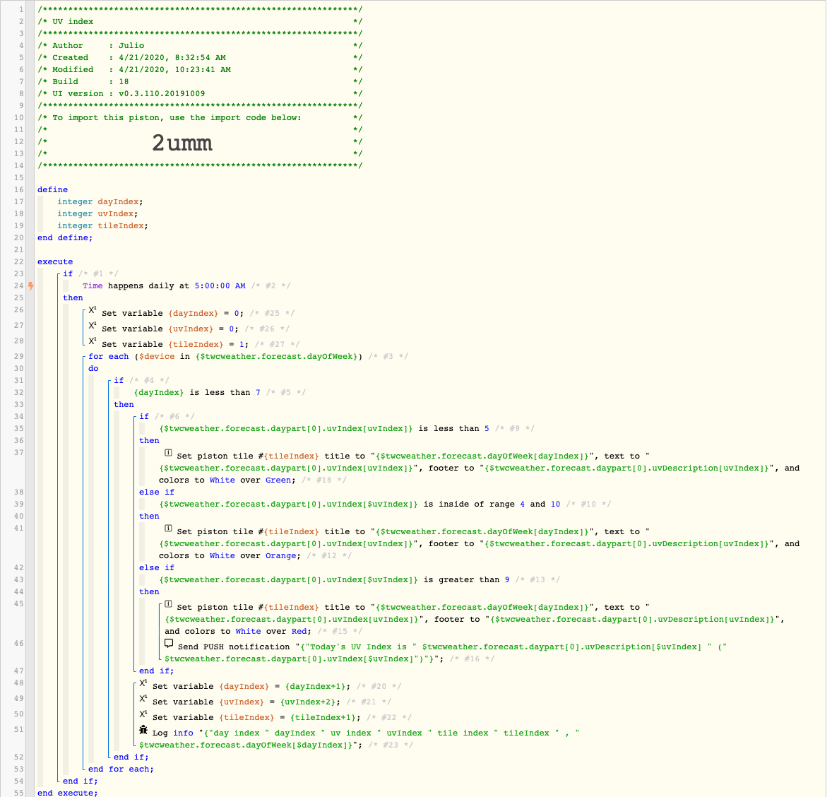

hmmm odd, seems to be working even though the log displays Tuesday for all.
With your current code:
dayIndex is stuck on [0]
uvIndex is stuck on [0]
tileIndex is stuck on [1]
Normally, those are kept (no value set) up top (in the define section), and they change based on the code you write (in the body of the piston).
Even though I overwrite the value in the for each ?
I can also just set the variables to nothing selected on top and then in the body set them to 0, 0, 1. Would that be best?
I try to never set up top if the variables are going to be changing. I like to have control of when it changes.
like this?
The only thing that stands out now, is the slightly overlapping:
IF uvIndex is less than 5        (4.49 and less)
IF uvIndex is inside range 4-10  (3.51 thru 10.49)
IF uvIndex is greater than 9     (9.51 and up)
…but with the way you are using ELSE IF, it might be OK. (just be aware)
Note: The decimals on the far right is due to UV being rounded to the nearest whole number
