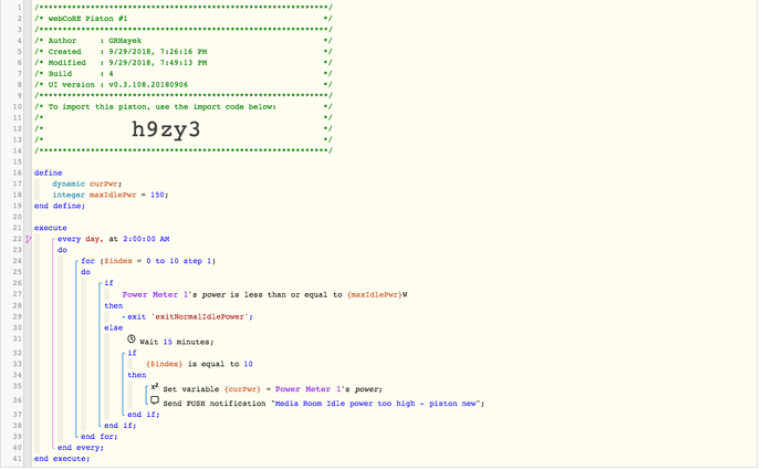

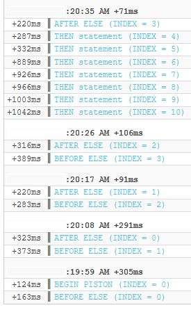

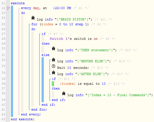

I must not understand how the “for” loop works, since I get one extra iteration than expected. Hoping someone can explain to me how this is supposed to work, or maybe I’m just confused by the logs.
I expect the first iteration of the for loop to happen at 2:00am. On the 2nd iteration at 2:15am (approx), I expect the the loop count to have incremented already – which it does not.
The piston first runs at 2:00am, and I expect that the for loop first executes at that time. Looking at the log, it seems on at 2:00am the loop does not execute and then executes for the first time on the next iteration (after a 15min wait). I’m looking at the log line at 2:15am at +193msec below, which shows a count of 0 which tells me this is the FIRST iteration of the for loop rather than the 2nd.
Also, I don’t see any comparison/reference to the index comparison on that first execution at 2:00am in the log (behaviour I’d expect since its seen on later iterations, but maybe theres some initialization process on the first loop)
