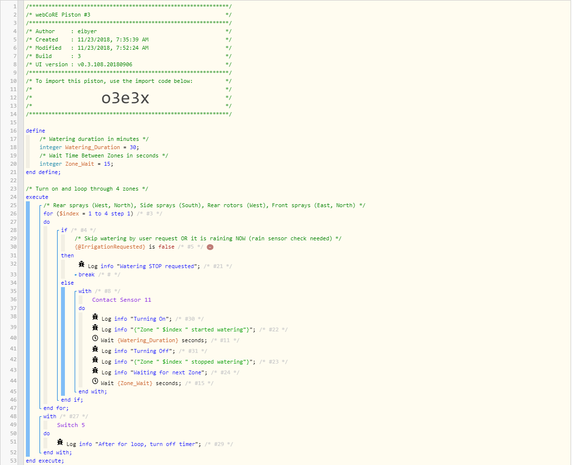

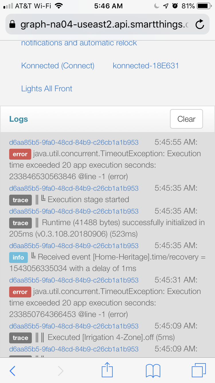

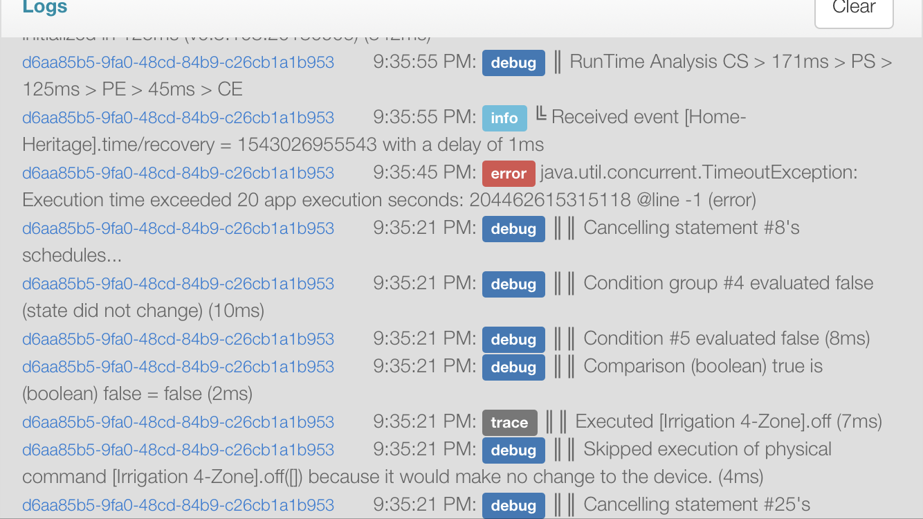

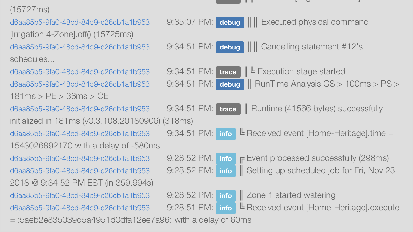

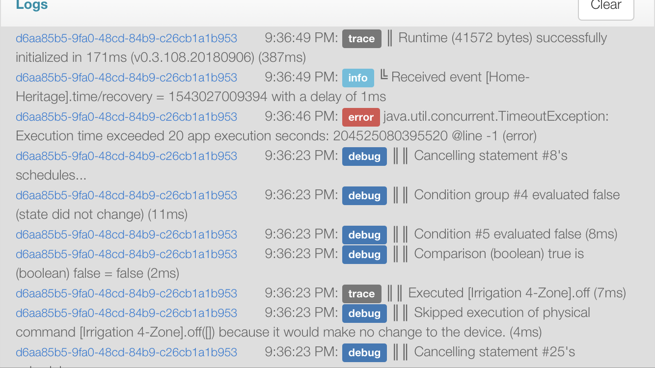

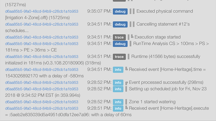

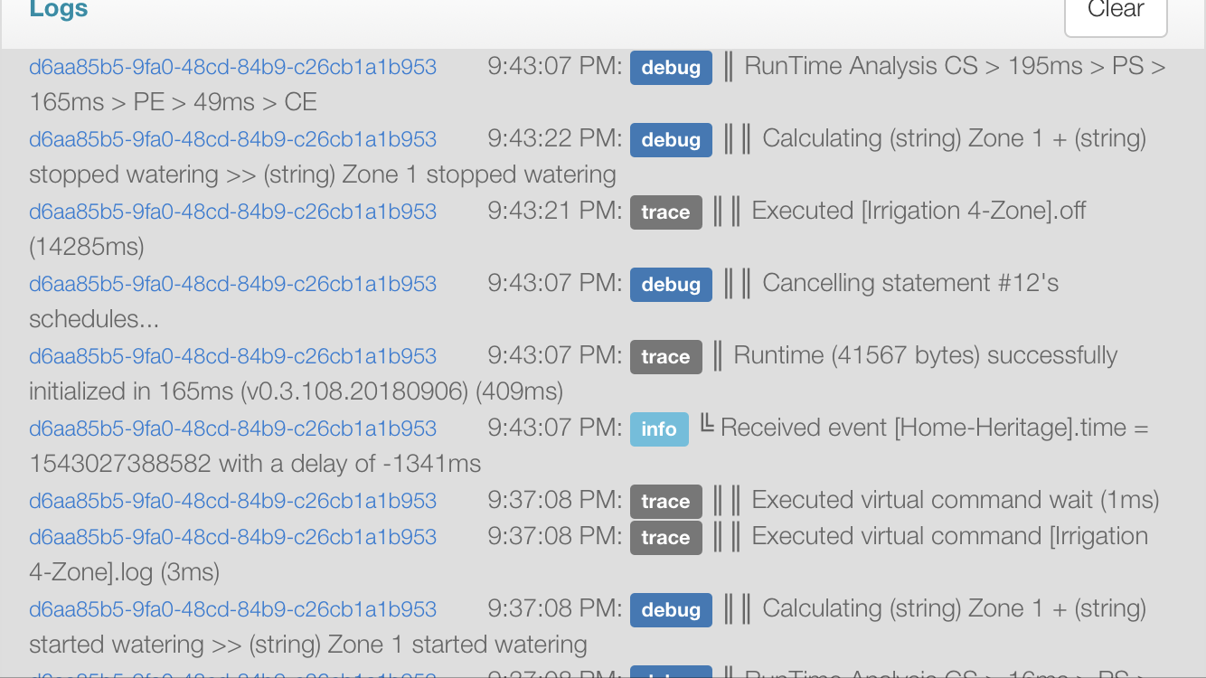

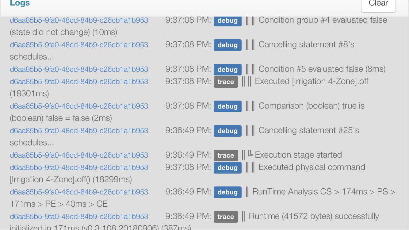

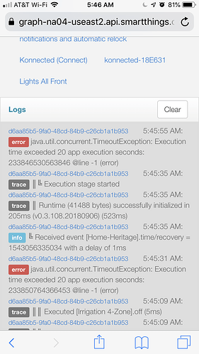

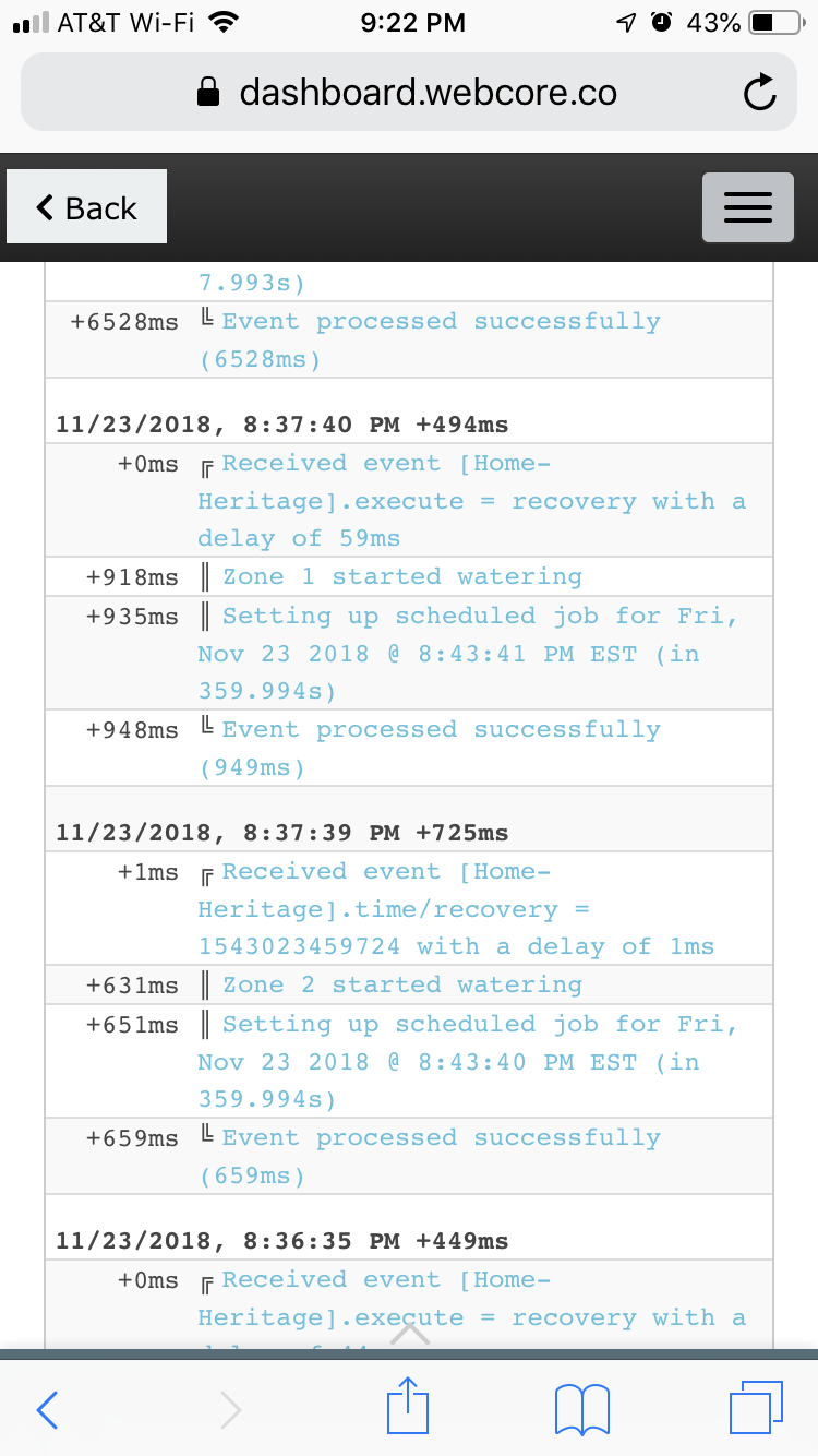

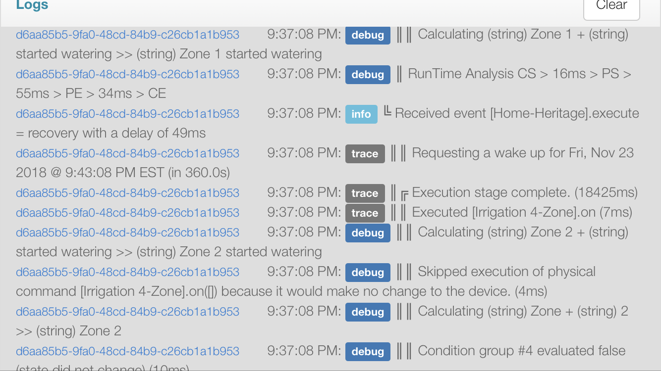

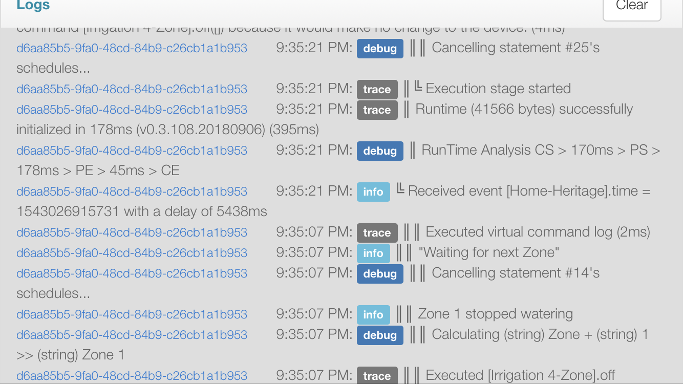

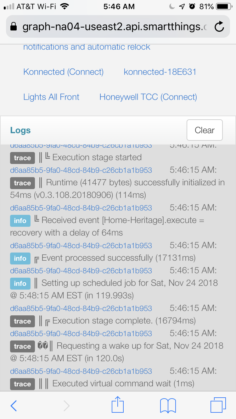

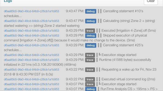

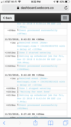

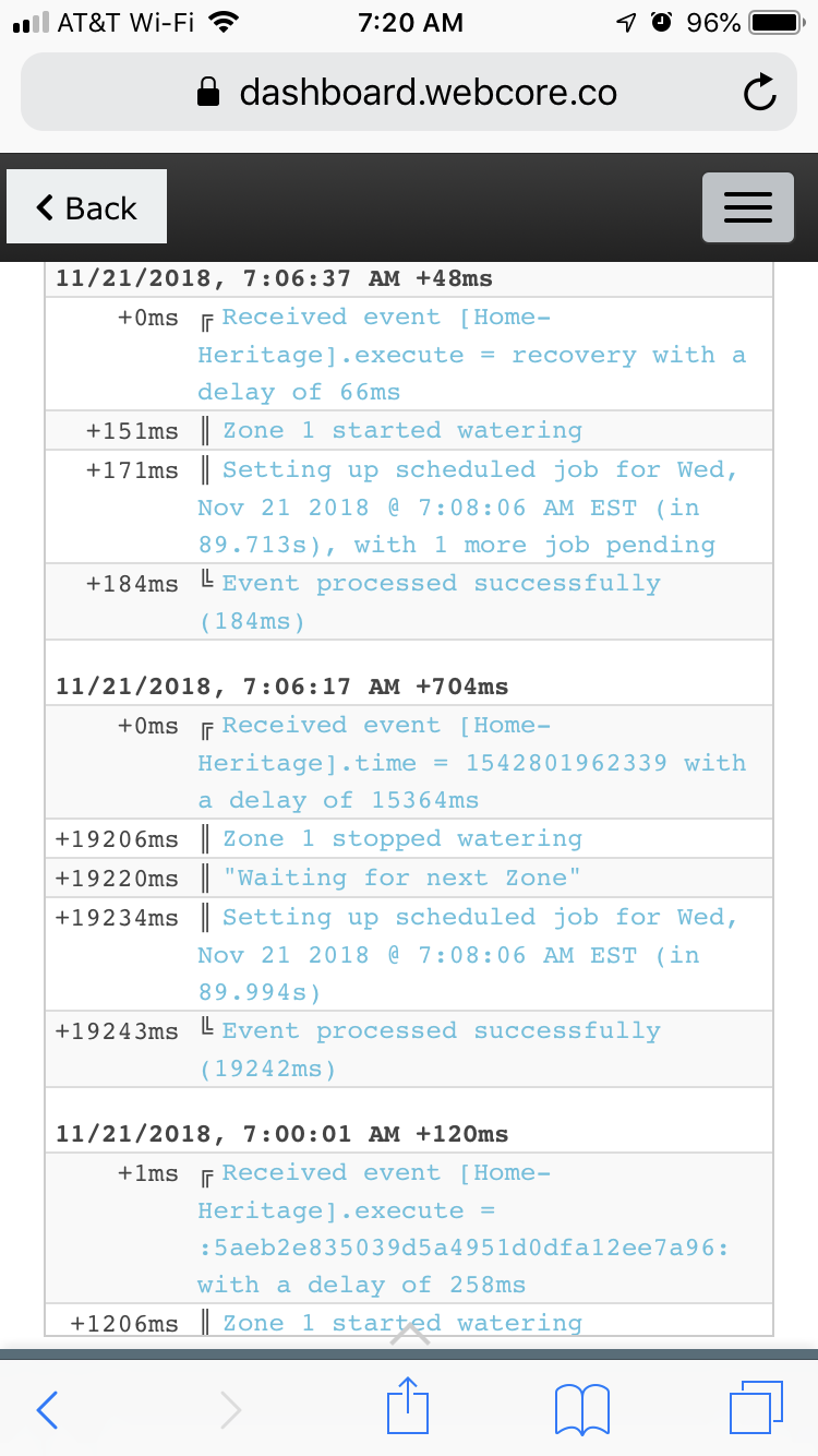

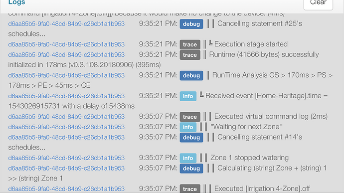

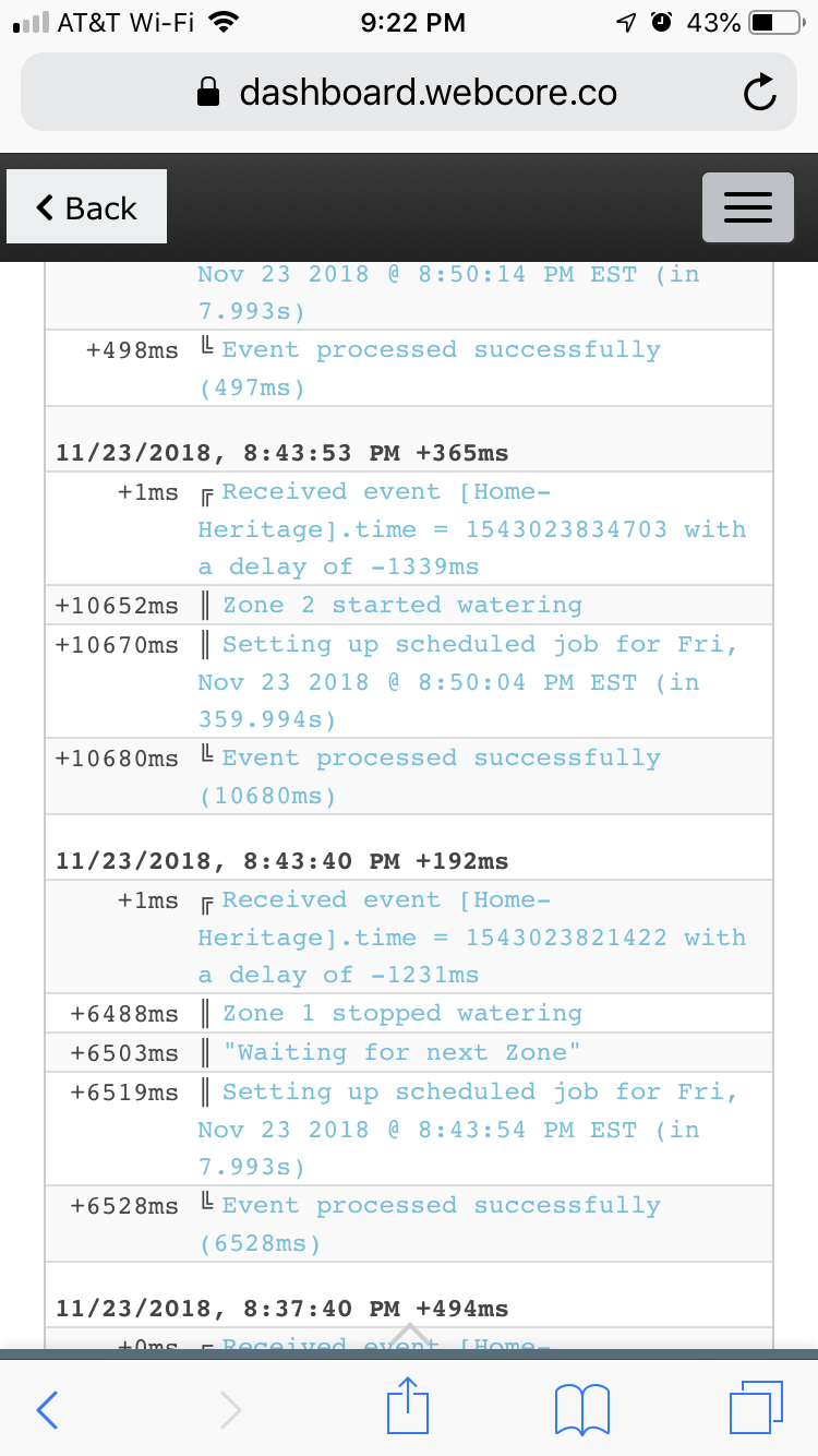

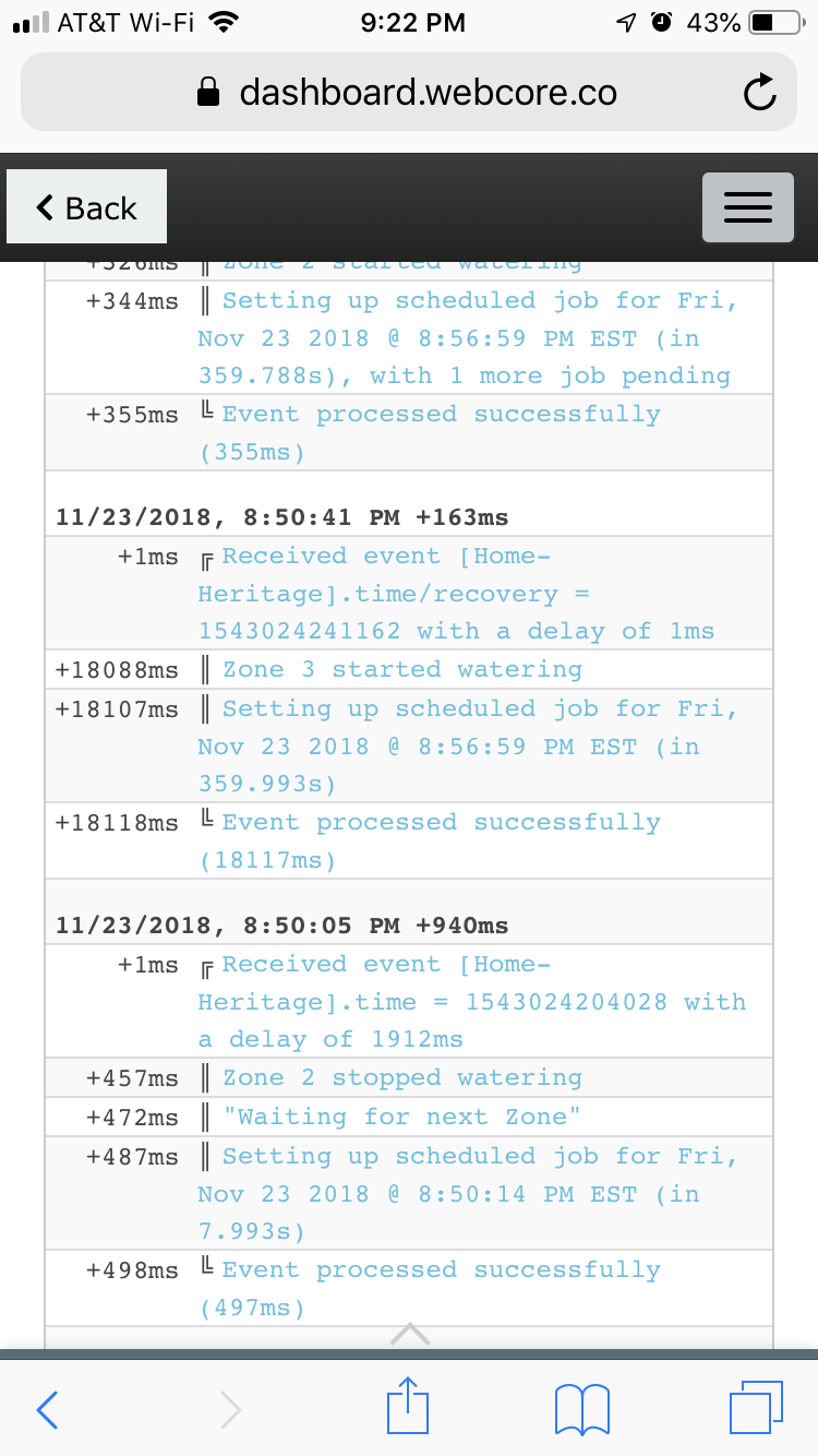

Ran it again and showing full logs from IDE
Preformatted text

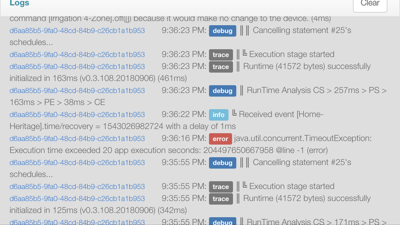

d6aa85b5-9fa0-48cd-84b9-c26cb1a1b953 9:35:45 PM: error java.util.concurrent.TimeoutException: Execution time exceeded 20 app execution seconds: 204462615315118 @line -1 (error)
d6aa85b5-9fa0-48cd-84b9-c26cb1a1b953 9:35:21 PM: debug ║║ Cancelling statement #8’s schedules…
d6aa85b5-9fa0-48cd-84b9-c26cb1a1b953 9:35:21 PM: debug ║║ Condition group #4 evaluated false (state did not change) (10ms)
d6aa85b5-9fa0-48cd-84b9-c26cb1a1b953 9:35:21 PM: debug ║║ Condition #5 evaluated false (8ms)
d6aa85b5-9fa0-48cd-84b9-c26cb1a1b953 9:35:21 PM: debug ║║ Comparison (boolean) true is (boolean) false = false (2ms)
d6aa85b5-9fa0-48cd-84b9-c26cb1a1b953 9:35:21 PM: trace ║║ Executed [Irrigation 4-Zone].off (7ms)
d6aa85b5-9fa0-48cd-84b9-c26cb1a1b953 9:35:21 PM: debug ║║ Skipped execution of physical command [Irrigation 4-Zone].off([]) because it would make no change to the device. (4ms)
d6aa85b5-9fa0-48cd-84b9-c26cb1a1b953 9:35:21 PM: debug ║║ Cancelling statement #25’s schedules…
d6aa85b5-9fa0-48cd-84b9-c26cb1a1b953 9:35:21 PM: trace ║╚ Execution stage started
d6aa85b5-9fa0-48cd-84b9-c26cb1a1b953 9:35:21 PM: trace ║ Runtime (41566 bytes) successfully initialized in 178ms (v0.3.108.20180906) (395ms)
d6aa85b5-9fa0-48cd-84b9-c26cb1a1b953 9:35:21 PM: debug ║ RunTime Analysis CS > 170ms > PS > 178ms > PE > 45ms > CE

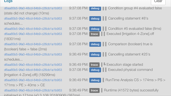

d6aa85b5-9fa0-48cd-84b9-c26cb1a1b953 9:35:21 PM: info ╚ Received event [Home-Heritage].time = 1543026915731 with a delay of 5438ms
d6aa85b5-9fa0-48cd-84b9-c26cb1a1b953 9:35:07 PM: trace ║║ Executed virtual command log (2ms)
d6aa85b5-9fa0-48cd-84b9-c26cb1a1b953 9:35:07 PM: info ║║ “Waiting for next Zone”
d6aa85b5-9fa0-48cd-84b9-c26cb1a1b953 9:35:07 PM: debug ║║ Cancelling statement #14’s schedules…
d6aa85b5-9fa0-48cd-84b9-c26cb1a1b953 9:35:07 PM: info ║║ Zone 1 stopped watering
d6aa85b5-9fa0-48cd-84b9-c26cb1a1b953 9:35:07 PM: debug ║║ Calculating (string) Zone + (string) 1 >> (string) Zone 1
d6aa85b5-9fa0-48cd-84b9-c26cb1a1b953 9:35:07 PM: trace ║║ Executed [Irrigation 4-Zone].off (15727ms)
d6aa85b5-9fa0-48cd-84b9-c26cb1a1b953 9:35:07 PM: debug ║║ Executed physical command [Irrigation 4-Zone].off() (15725ms)
d6aa85b5-9fa0-48cd-84b9-c26cb1a1b953 9:34:51 PM: debug ║║ Cancelling statement #12’s schedules…
d6aa85b5-9fa0-48cd-84b9-c26cb1a1b953 9:34:51 PM: trace ║╚ Execution stage started
d6aa85b5-9fa0-48cd-84b9-c26cb1a1b953 9:34:51 PM: debug ║ RunTime Analysis CS > 100ms > PS > 181ms > PE > 36ms > CE
d6aa85b5-9fa0-48cd-84b9-c26cb1a1b953 9:34:51 PM: trace ║ Runtime (41566 bytes) successfully initialized in 181ms (v0.3.108.20180906) (318ms)
d6aa85b5-9fa0-48cd-84b9-c26cb1a1b953 9:34:51 PM: info ╚ Received event [Home-Heritage].time = 1543026892170 with a delay of -580ms
d6aa85b5-9fa0-48cd-84b9-c26cb1a1b953 9:28:52 PM: info ╔ Event processed successfully (298ms)
d6aa85b5-9fa0-48cd-84b9-c26cb1a1b953 9:28:52 PM: info ║ Setting up scheduled job for Fri, Nov 23 2018 @ 9:34:52 PM EST (in 359.994s)
d6aa85b5-9fa0-48cd-84b9-c26cb1a1b953 9:28:52 PM: info ║ Zone 1 started watering
d6aa85b5-9fa0-48cd-84b9-c26cb1a1b953 9:28:51 PM: info ╚ Received event [Home-Heritage].execute = :5aeb2e835039d5a4951d0dfa12ee7a96: with a delay of 60msPreformatted text
