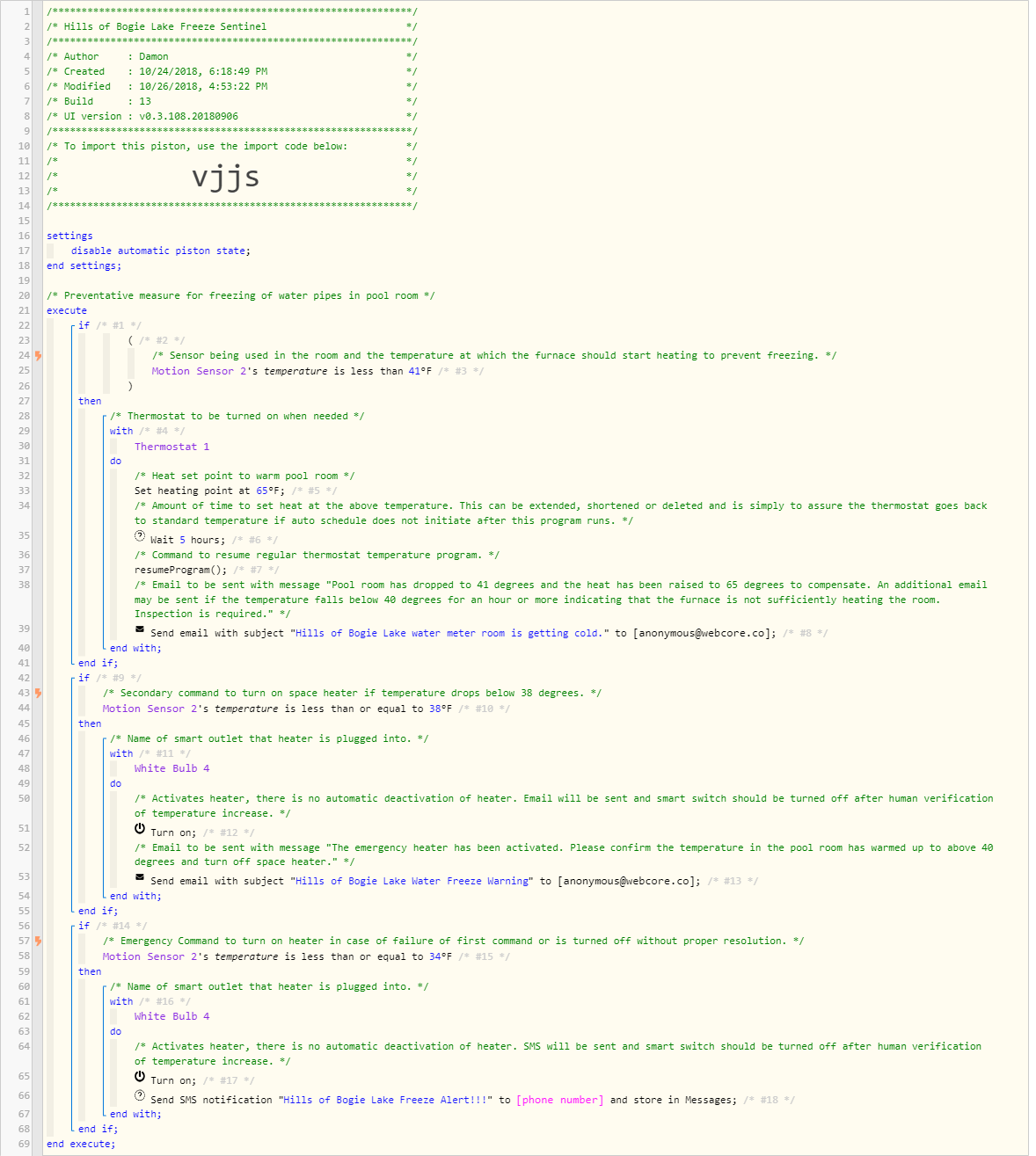

I have a clubhouse in my community that is unattended (much like a vacation cabin). We turn the thermostat (which resides in a locked office) down to 55 deg when no one is there. We have a room with water pipes that is in a remote end of the building and tends to get much colder than the office so we want the heat to turn on if that room gets dangerously cold.
I would like ST to make Nest raise temperature if the room with a temp sensor begins to approach freezing. I would then like to turn on a smart outlet connected to a heater if the temperature continues to drop, also send out an email notification. Finally, if the temperature does not raise, I would like to activate the smart outlet again (just in case) and send an SMS emergency message.
Once the temperature raises or after X amount of time, I would like to resume normal program.
I am not really able to test the program as I cannot wait for freezing temperature. I did run a desktop experiment and was able to set thermostat to higher temperature but a weird thing happens, when the temperature raised above the limit, the piston just stopped and didnt resume the t-stat program.
Ignore the fact that I am using Ecobee for this test, I am setting this up at home and I don’t use Nest here.
(No Logs done
