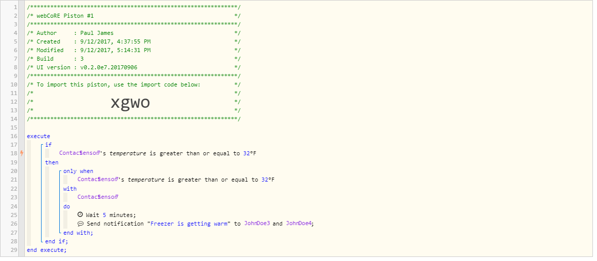

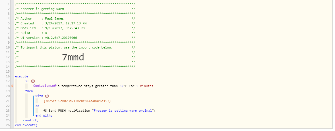

So this is the Piston that I had and used to work. I don’t think the numbers that are in the “with” and can’t remember if that is what should be there or if I need something else there when I click on it takes me to add a physical device.

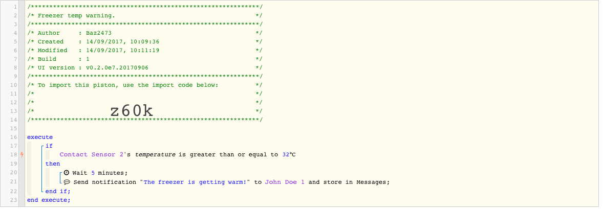

When I try and create a new piston to do the same thing I can’t figure out how to wait for 5 minutes and check to see if it is still above 32 if it is back below 32 then to cancel.
Here you go.
If the temperature goes below 32° then the If condition becomes false which cancels the 5 minute timer and notification.
So as long as the freezer stays at or above 32 it will send you the message. Once.
The numbers are referring to a device you no longer have as an available device in webcore.
