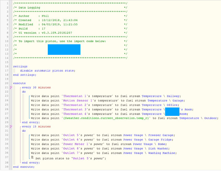

I have a piston that logs a bunch of data:
Temperature from one set of sensors on 30 minute intervals
Power from a bunch of switches on 5 minute intervals
I can see I get 7 days of events from the temperature sensors before old data is dropped

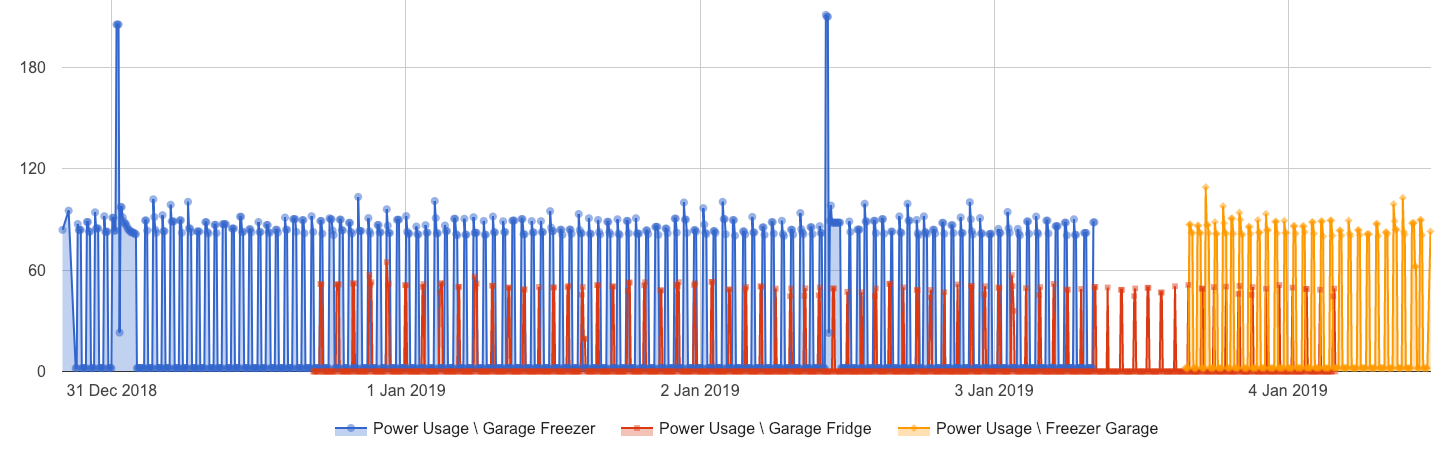

My power switches I’ve only had going a couple of days. 1 stopped logging yesterday altogether (although the switch still reports the active power) and another stopped today
Until I changed the name of the fuel stream into which that particular switch saved its data nothing i tried resumed the logging for that particular switch…
I’ve stepped down the power logging to 15 minutes to see if it makes any difference - but are their any limits or other things I should be aware of when writing data to fuel streams?

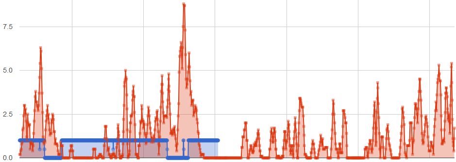

Not too long ago, the limit per fuel stream was changed to only display the oldest 1000 data points… (If you want to see the entire week worth of data, that is an average of every ten minutes, or 6 per hour) If you are trying to log more frequently than that, you can expect the most recent data to be unavailable.
In the pic below, my red data is coming in once every ten minutes, and my blue data is every 4 minutes.
Notice only 2.75 days of the oldest data is displayed. (1000 / 15 per hour = 66.7 hours worth)
With the new changes, I need to reprogram my blue data to record less frequently if I want to see all of the data.
If any dev’s see this post, perhaps it can be changed to display the most recent 1000 data points instead of the oldest 1000?

Well, from my observations, the data is still collected and stored (even when it goes past 1000 data points) but only the oldest 1000 points are shown on the graph.

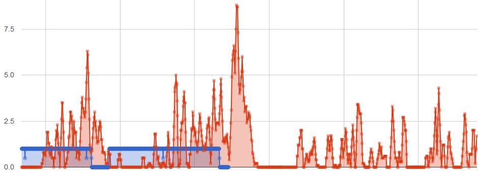

To see this in action, here is the exact same two data points 14 hours later.
Notice the blue data was still collecting data all along, but the graph only shows me the oldest 1000 data points
